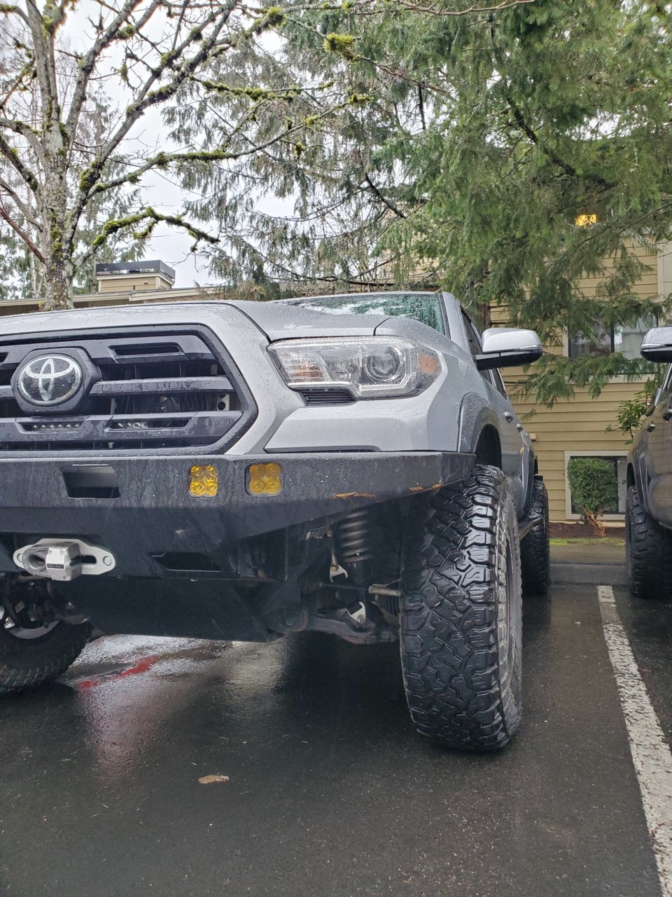

    Just curious if the wings would have more flex and snap back to the original shape after being hit, or less flex and hold the same shape or just bend. I'm sure the winch portion wouldn't budge just since there is so much support in the center. I've gouged my wings a little bit and it has pushed them up a cunt hair, so might box in the inner side which is open. Or just not hit shit with them :rofl:

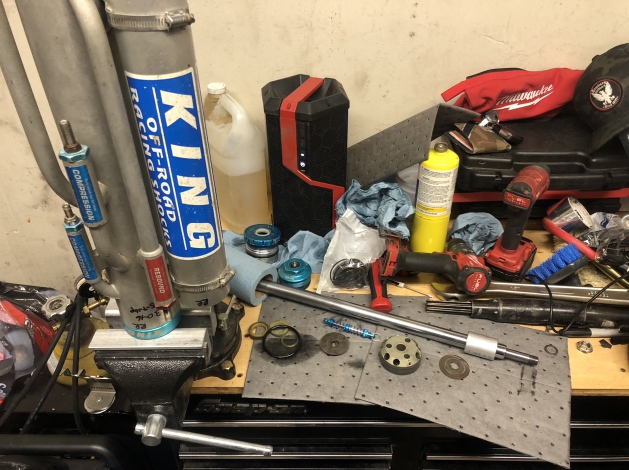

    Got one revalved and resealed, now just one more to go...
