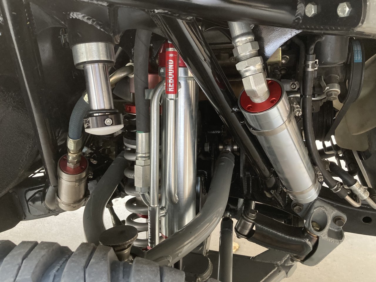

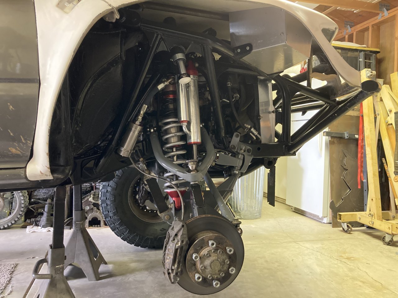

    10” because it doesn’t require a full engine cage and you can fit a bypass under the booster. 12” is what they use for full cage trucks with workarounds for braking (manual) and like you found, 10” is not really ideal for dual rate. I have 500/600 and that’s pretty much what most guys with first gen trucks run. Full size trucks like the one my setup was meant for run 500/700 so all I had to do was switch out the main spring.
    12”

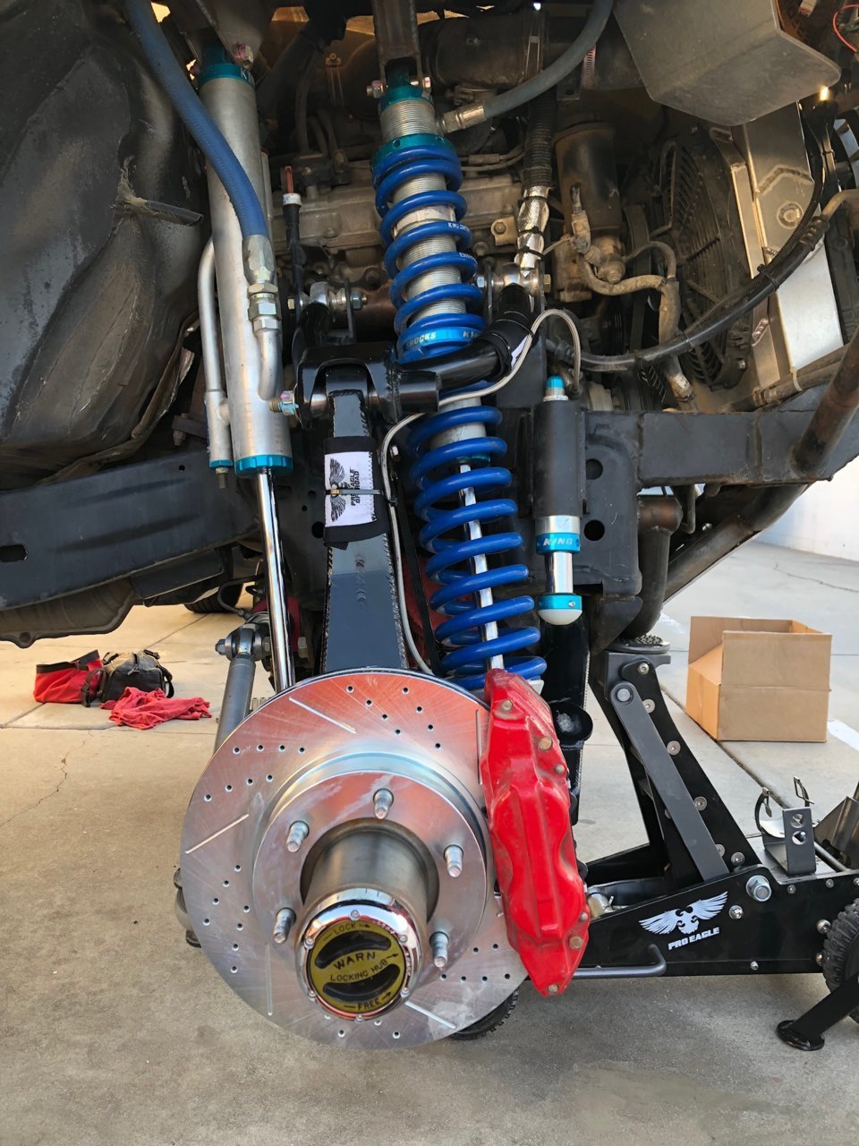

    Dual rate is possible on an 8”
    Running 5” 500 over a 13” 600 or 650 (can’t remember) off a mid travel coilover on a SAW shorty 8” on my 89 pickup

    how much preload did you have in that setup?
    89 pickups are a hell of a lot lighter than 1st and especially 2nd gens.

    Barly any preload, just enough to keep the coils from being loose with the shock fully extended
    Truck has a 3.4 swap and caged front to rear so i think its pretty equivalent to a 1st gen weight wise
    Suspension also has more leverage on the spring rate since its a 5" over kit but using an 8" coilover further inboard on the lower arm
    Lot of variables to multi spring rate setups, just gotta know your available spring travel #'s / block height and setup your crossover ring to limit things before coil bind and/or to tune ride height in some setups
    Just showing its possible. Works pretty well on this little truck
