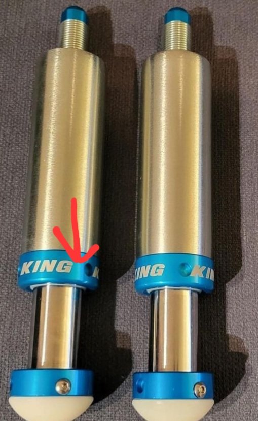

    Just call them and they can give you a part number and tell you if it’s in stock or not. That’s what I do, but being in Washington I just get the number and if it’s in stock than I call mckenzies and order it since getting king to ship stuff is kind of a pain in the ass.

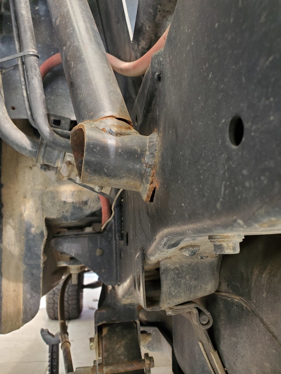

    Who did the install? The mounting location was not plated on a frame that is well known to be weak and not withstand these types of loads. Has been a common issue for guys doing CMRs and not plating the frame before install.
    What thickness is that tube? Very interesting on how the tube itself cracked so severely.

    I was kinda thinking the same. Frame not plated on the back side and not plated where the tube lands to the frame, that failure not too too surprising. But the vertical tube cracking is not good. Makes me think the shock bottoms out before the bumps and things need to be checked

    Looks like 0.090 - iirc the guy did a sh*tty job on the spring hangers - Oskar can make a better cage at this point.

    Yes, hence the shop being out of business for a long time. And YES I 100% can.
