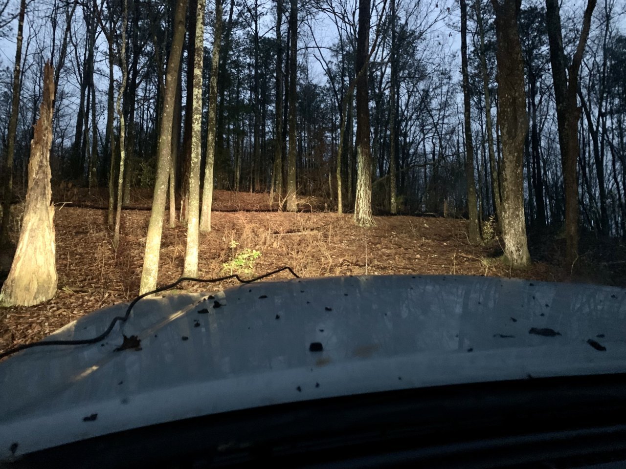

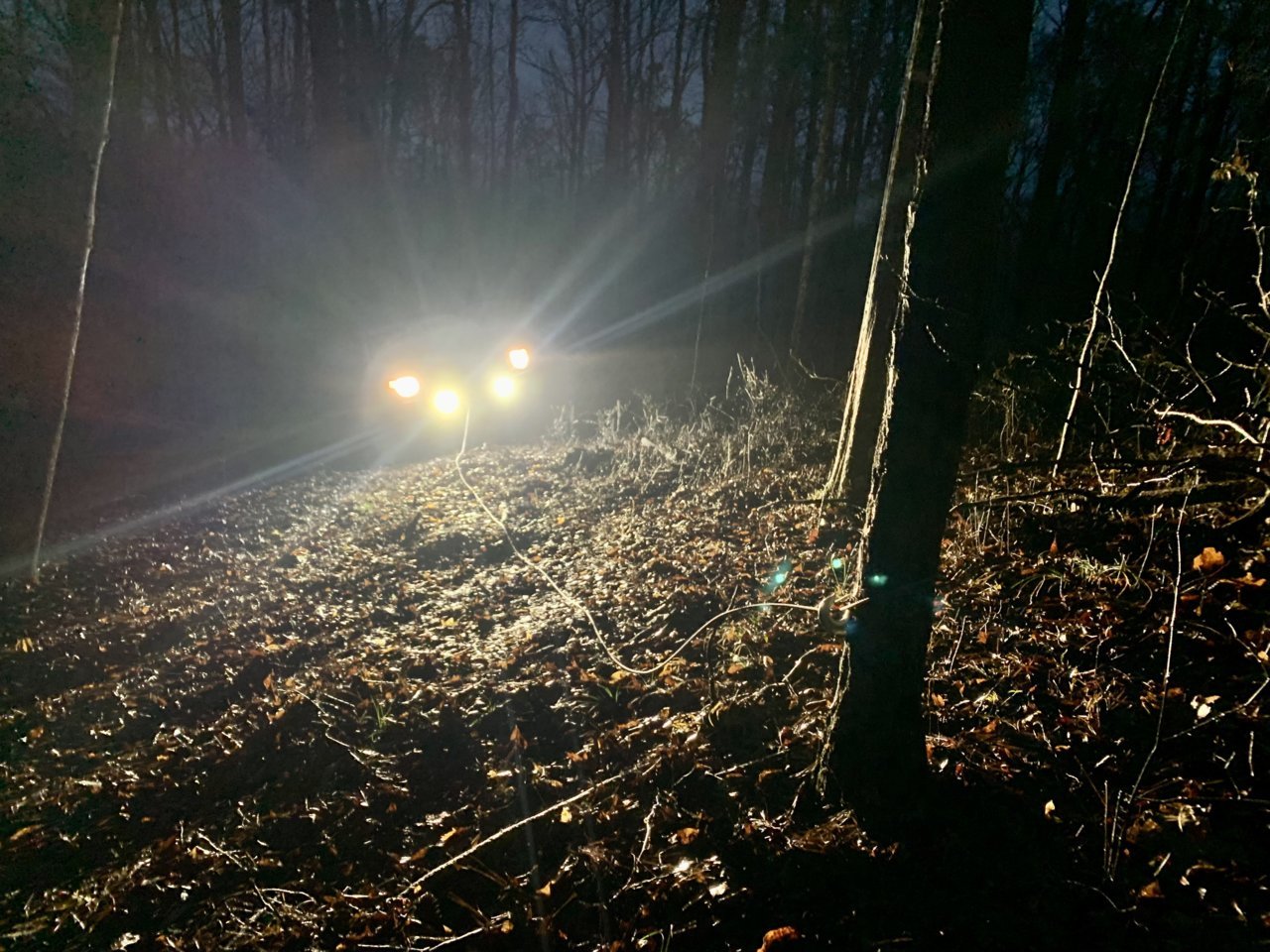

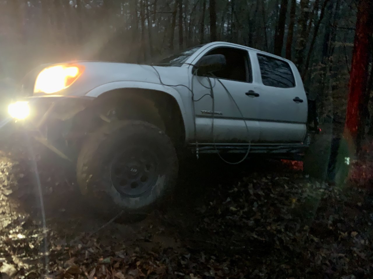

    Got a little more than I bargained for on a “quick ride” after work on my trails. Had to winch out of two spots. Dual locked and skinny pedal no worky. Granted it’s been raining two straight days…

    1 it's awesome seeing that thing done and you enjoying the heck out of it and working all the little kinks out.
    2 Having walked your trails, seen what the lay of the land is, and condition of them that was a dumb decision after 2 days of rain you were asking for some winch time :rofl:All that leaf litter on the ground and the very untraveled soft dirt from years of not being touched and then 2 days straight of rain in the SE yep I'd say that was a given the situation you got in.
    Ok now a 3rd need to get some old culverts and stuff thrown into those gulleys and make some killer hills.

    Haha yeah those leaves got me. I was fine on the main trail, but there are some hill climbs with ditches on the backside I couldn’t bump over and I couldn’t back down it without sliding into trees haha good pulls to test out the new front bumper with though

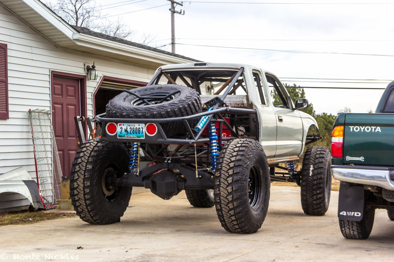

    My favorite looking tube bed is @45acp access cab. I’m trying to copy it as best will fit a double cab. I think that’s my favorite truck on here.

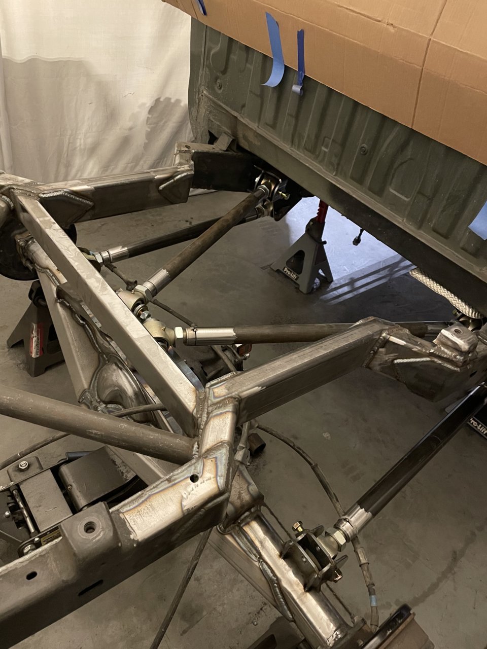

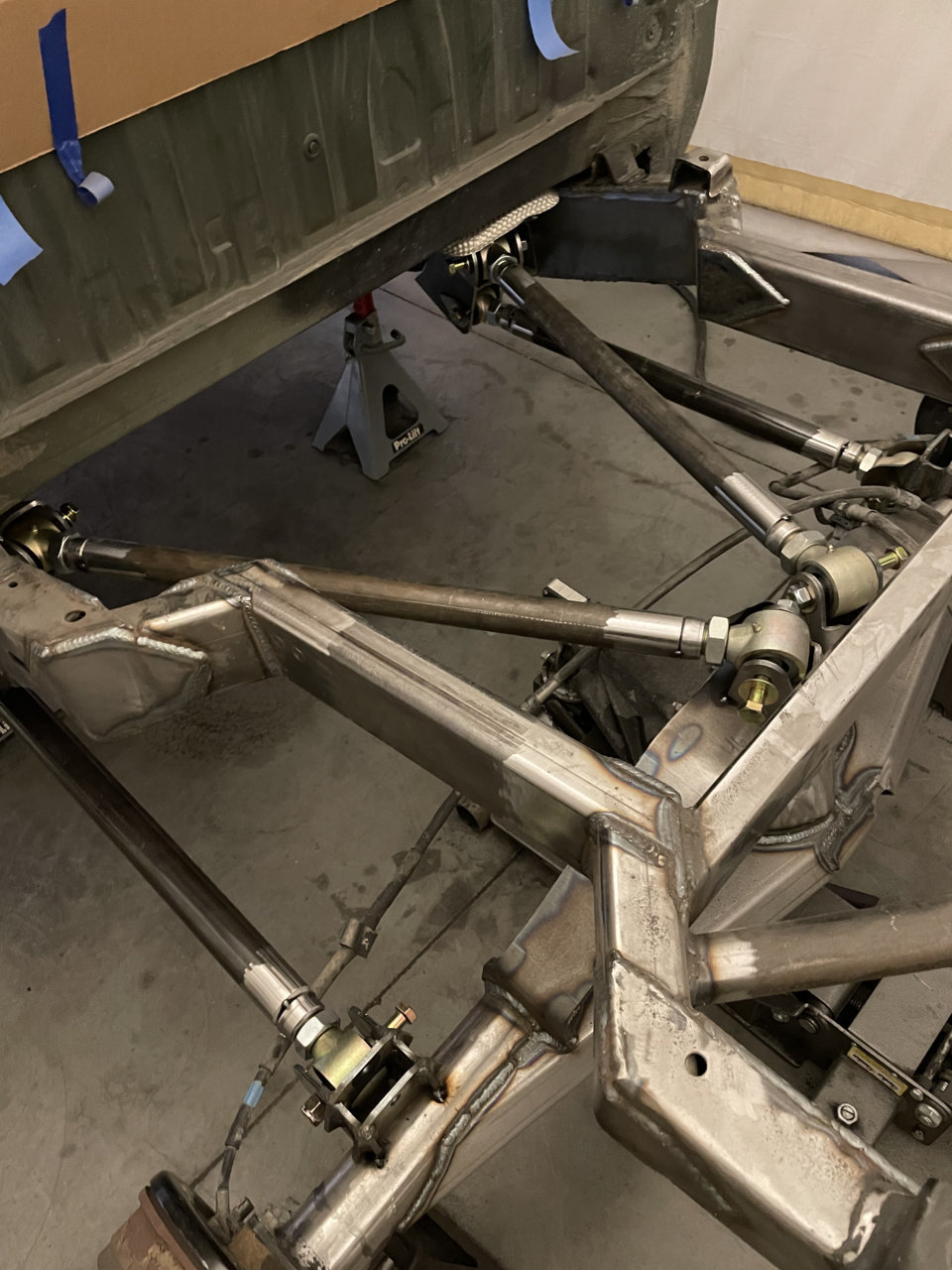

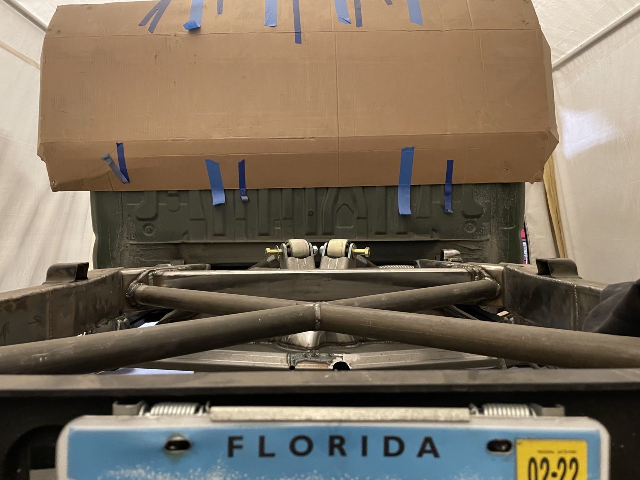

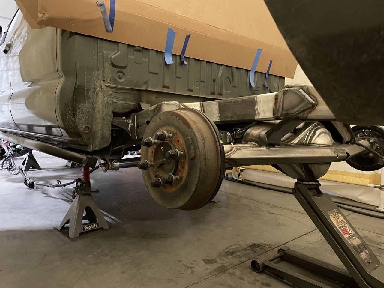

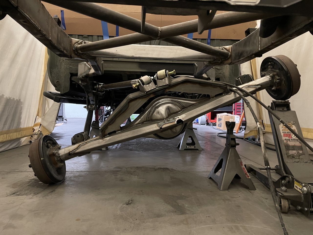

    Solid progress the last 3 days. Got all the link mounts tacked in and cycled. Going to get the sway bar in place, bump stops, shocks, and limit straps today. Or at least that’s my ambitious goal.

    Very cool. Looks like johnny joints? That looks like a clean way to keep things sleeper and functional all around. What size coilovers?
  15. Mar 10, 2022 at 9:39 AM
    Tacoma1192
    Tacoma1192 GD MOTORSPORTS
    Dec 27, 2013
    #119290
    1,479
    Kyle
    Boise, ID
    2015 DCSB Sport
    39's, LT, 4 Link, Spidertrax 9"
    Yep, Johnny joints to help keep this a little more daily driver friendly and less maintenance. 2.5x16" ASH coilovers
