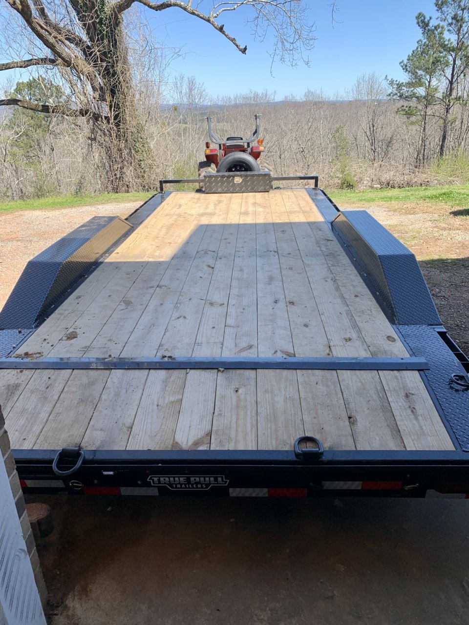

    Welded on some new d rings in more ideal locations and added a toolbox. Got an OEM brake controller and a WD hitch on the way. Should be Gucci now.

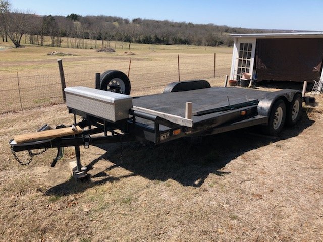

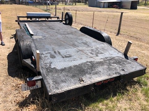

    Pushing the limits of our tow capacity?? 18' trailer with two 3500lbs rated axles. My dad's friend would sell it to me for $1500

    Only way to know for sure is to weigh the jeep and compare that to the trailers GVWR and get the total combined weight.

    How much does it weigh that's not a horrible price and for hauling that XJ it would be good.

    Trying to find out. Trailer is down in TX and I'm in CO, having to play phone tree to get info

    That being a short trailer is advantageous for getting around tight areas. My guess is it probably weighs around 1000 give or take. You can always upgrade the axles. If it was a home built trailer then the Gross weight max is typically what the max of the axles are. 7k is a decent trailer for the xj and you can always upgrade axles if you absolutely needed/wanted to. That XJ you posted probably weighs a little over 4k mine is up around the mid 4s they are lighter than tacomas which is a plus.

    That's true. It is shortish though. IIRC my old lowboy race car trailer was under 1500 but it was open in the middle 1/2 the trailer. It was a steel deck 18 footer as well.

    That’s what my trailer is. Frame is rated for 5k axles though and they will get upgraded at some point. Brakes only on the rear axle right now.
    1500 is a good deal for a steel deck trailer. I paid 1200 for mine 5 years ago and it needed a ton of work to include a deck

    Got a number of around 2200lbs. It's a good deal and I'll keep it on the backburner. Gotta buy the jeep first! Lol. Meeting with seller this weekend. Engine is toast but we're working out something, maybe a forged stroker
    Also trailer bed is 83" wide. Outside fender 8'6". 18ft long.
    The old man selling it said he pulled a car on it with his Chevy Colorado
