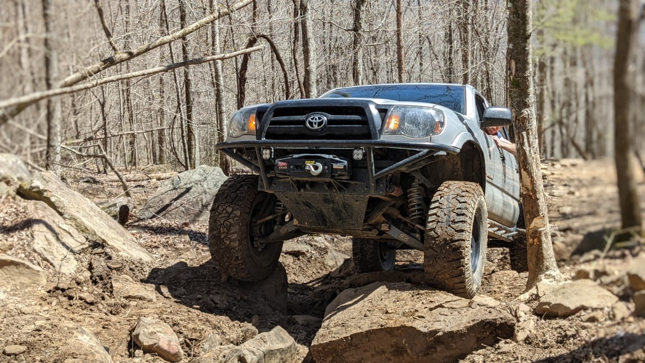

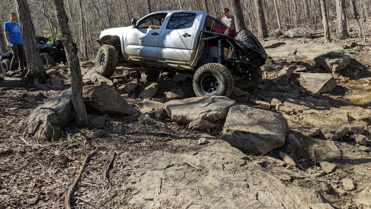

    Had a good shakedown run at AOP. Definitely need to step up to 37’s- priority one. Immediately apparent to the more experienced wheelers and later to me- while the ass end looks cool moving like a moon buggy it’s not making the front do shit. Still debating how to solve that, but will start with seeing what I can get out of the dual rate adjustment. Hell of a time with some great guys.

    Non-Ultra4 IFS travel isn't going to keep up with a rear link for rock crawling / difficult trail riding - think of the rear of your truck being replicated on the front of your truck

    Not following how the rear setup is correlated to the front? Care to elaborate? What’s the spring rate up front?
    He’s implying a solid axle swap is your answer.

    I think it’s a weight distribution problem. Ass end is super light. I’d have the same issues with a live axle.

    Rear is super light, it’ll flex out before the front will instead of there being a balance. Rear needs to shift some work through dampening or spring rate to the front. This pic kinda shows it best. Front should be stuffed
