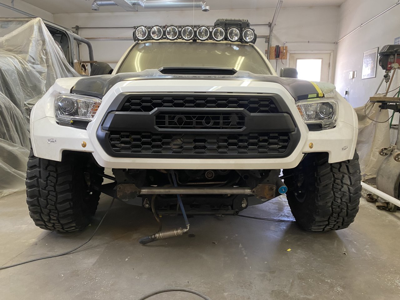

  10. Apr 10, 2022 at 8:52 AM
    906taco
    906taco Well-Known Member
    Jun 22, 2021
    #369289
    3,903
    Cory
    08 Taco
    3rd gen conversion is officially complete! Got some bumpers to build and some frame work with a bunch of little things and it’s time for body/paint. Praying the rest of my shocks show up soon so I can cycle everything one last time.
  11. Apr 10, 2022 at 2:56 PM
    Maxx
    Maxx Well-Known Member
    Dec 30, 2012
    #94017
    1,397
    What’s the final width on that front end?
  12. Apr 10, 2022 at 5:30 PM
    EatSleepTacos
    Mar 24, 2015
    #151688
    59,838
    Randy
    West Valley, AZ
    2017 4Runner
    If I had to guess, 89”. I’m ~85” and we have the same exact wheels but he went +4” and I went +2.25” for our LT kits.
    Edit: as far as width measured from the outside of the tires goes. Idk about the fenders.
    Maxx[QUOTED] likes this.

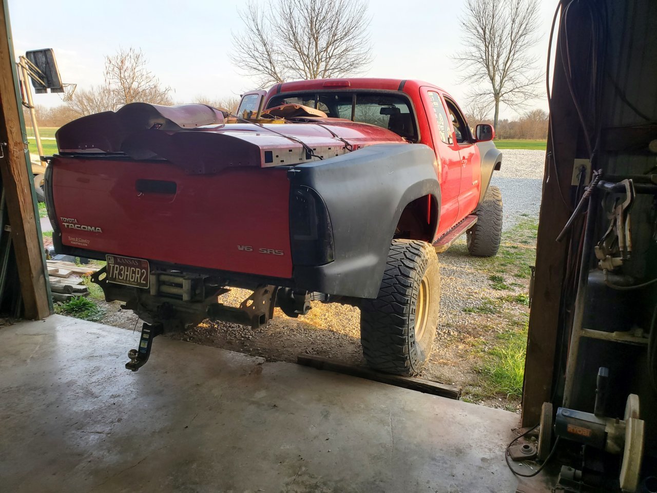

  13. Apr 10, 2022 at 7:53 PM
    T1TITAN
    T1TITAN Well-Known Member
    Jan 7, 2019
    #278498
    263
    Kansas City
    2008 ACLB aka Treehugger and 2005 ACLB Treehugger 2
    Treehugger- soon to have 80 series axles front and rear with dual rf1a tcases Treehugger 2- Bilstein 6112/5125 jba ST High Caster UCA OME Dakar Heavy leaf packs with Fireastone RideRite bags
    Finally had time to get the bedsides on. Here you guys go!
    BMiller421, JDSmith and Happysmiley like this.
  14. Apr 11, 2022 at 3:55 AM
    906taco
    Jun 22, 2021
    #369289
    3,903
    Cory
    08 Taco
    Yeah, it will sit 89-90”. Haven’t measured yet but my original factory width with these wheels and tires was right around 82”
