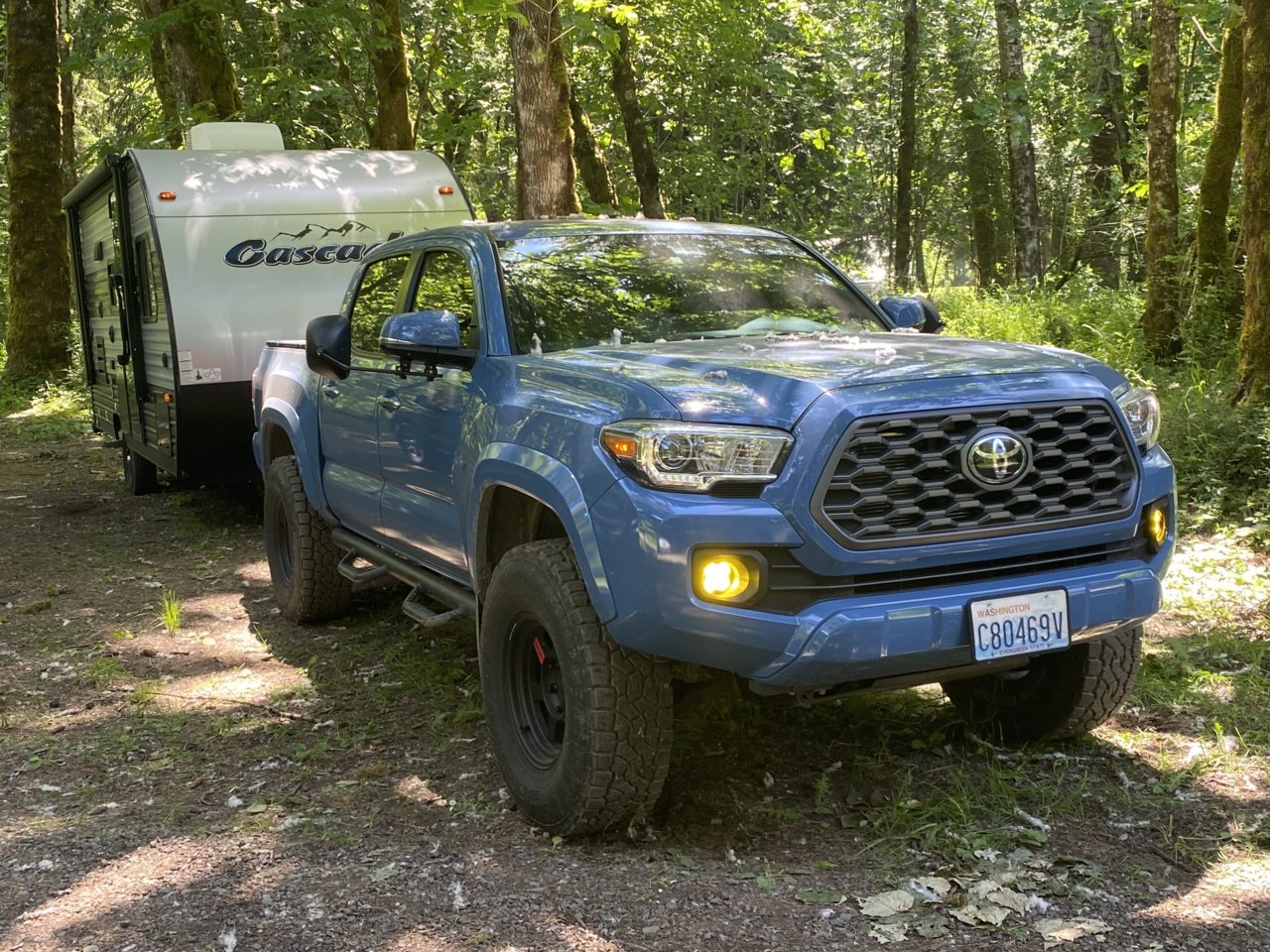

    I run no sway bar on my Tacoma and tow a 4K trailer with a wdh and have no issues.
    Edit to add additional context without making an additional post.
    Truck has changed slightly since this photo but running standard fitment kings (stock valving) with resi's and rear adjusters. I usually drive around with the rear adjusters in cadillac mode (fully open) and when towing I usually run 10 clicks in. Have HH's and Deaver U402 Stage 1's. This thing has seen plenty of busy 70 mph interstate travel and is very well composed. The wdh helps a ton and when it gets windy the truck and trailer move as a unit. One of our first trips we had some 40+ mph wind gusts that were blowing big rigs out of their lane, I just matched their speed and watched for them to move and tried to stay calm and when the gusts came they would blow us half way out of our lane but the truck and trailer were moving like a single unit. If there was a good drop in sway bar options that came without compromises I'd probably run them. Since this truck really is a do it all daily driver having sway bars for normal around town driving would be nice but the wife and I have gotten used to the truck as is.

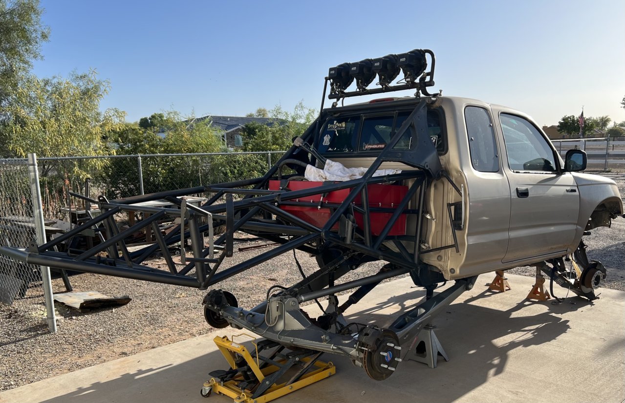

    holy shit this thing is still around

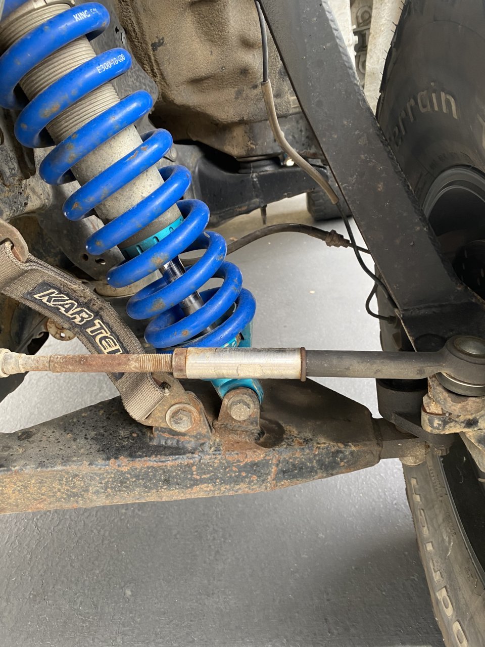

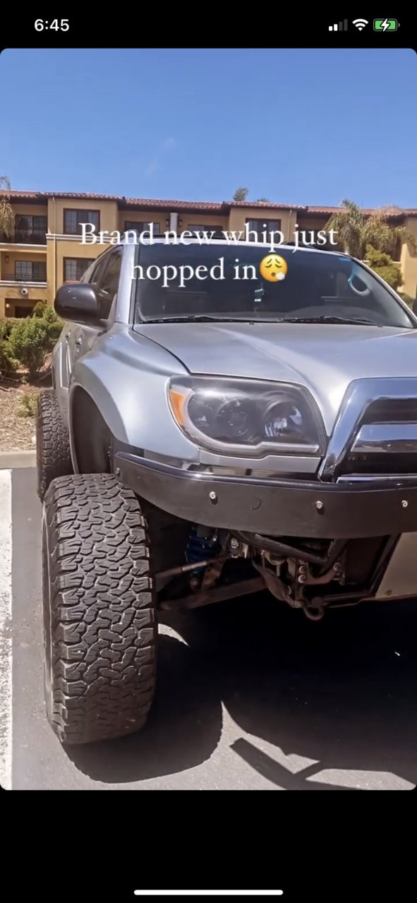

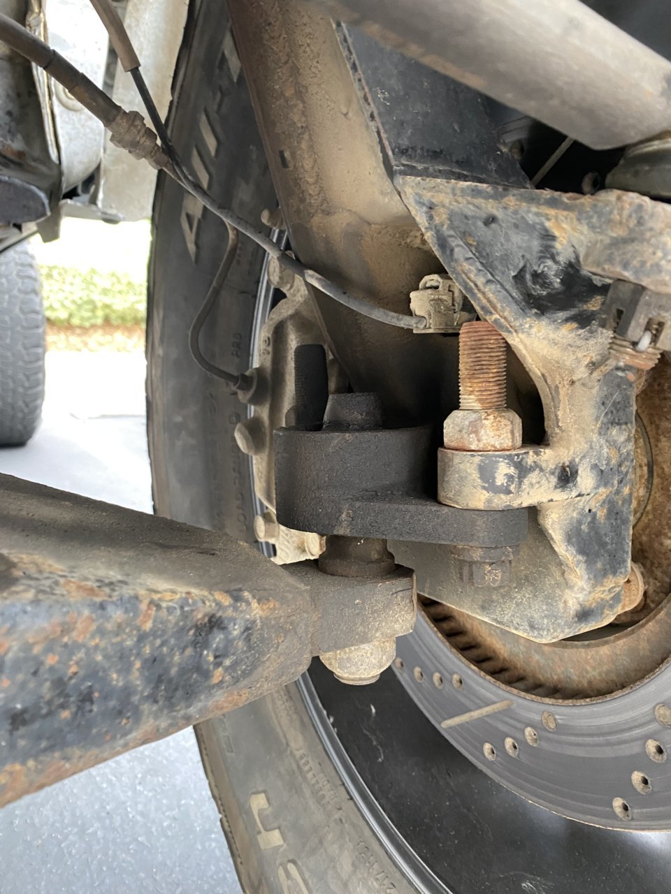

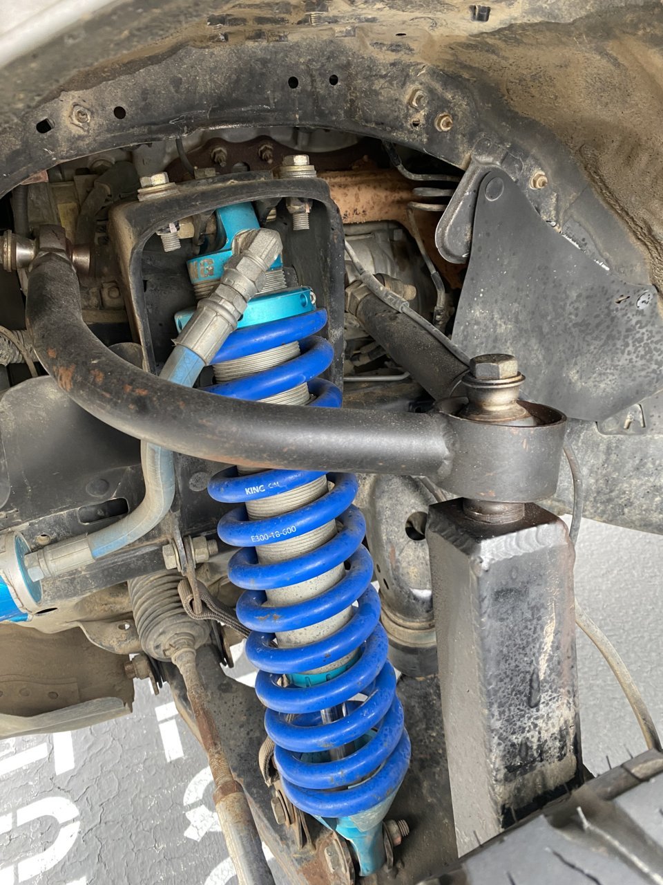

    I bought a car with your long travel kit from a guy, he told me to go to this thread to find answers about it but haven’t found what I need. The upper and lower uni balls are shot and I took it to a mechanic and he said to ask you what size they were to replace them? Could you help me out please. I direct messaged you on Instagram as well: dylan.harrigan

    Gonna need to be more specific. As this is the BS thread. So to help ya we’re going to need to know what kit your talking about. If you don’t know. Then pictures parts with identifying information on them would help.

    This is the kit I have. He said @Basikbiker did the build
