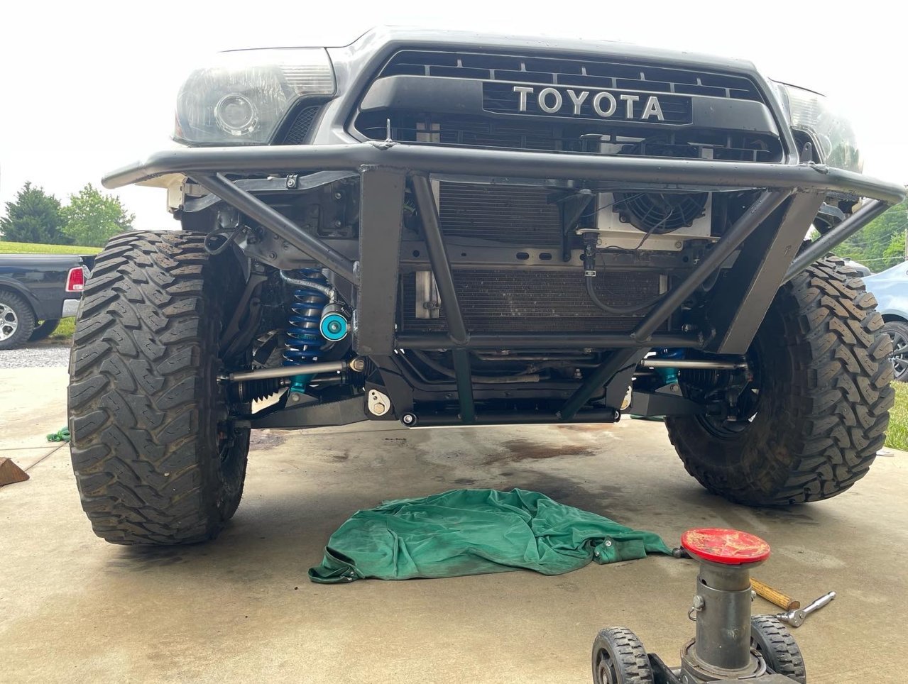

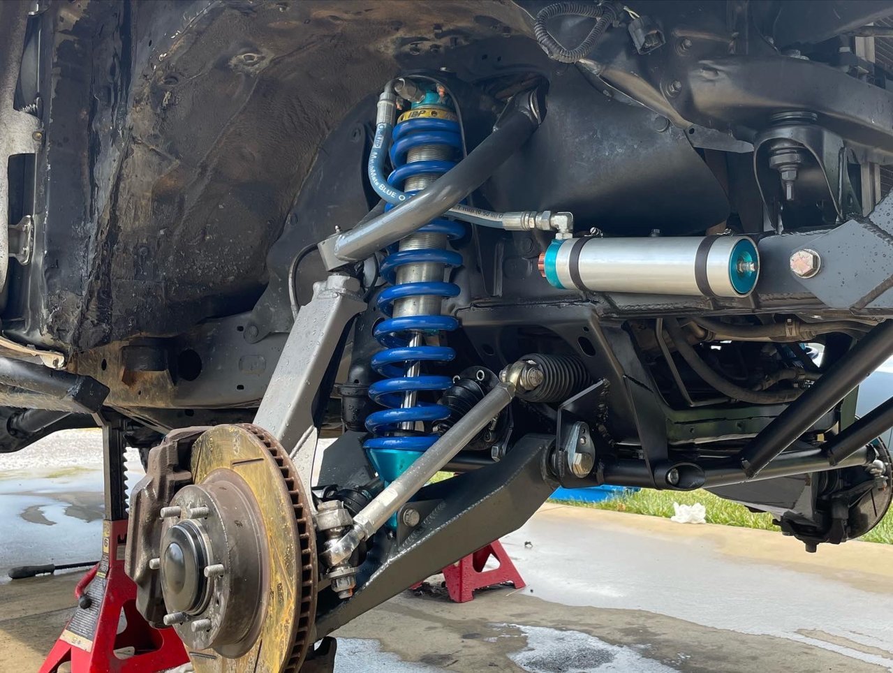

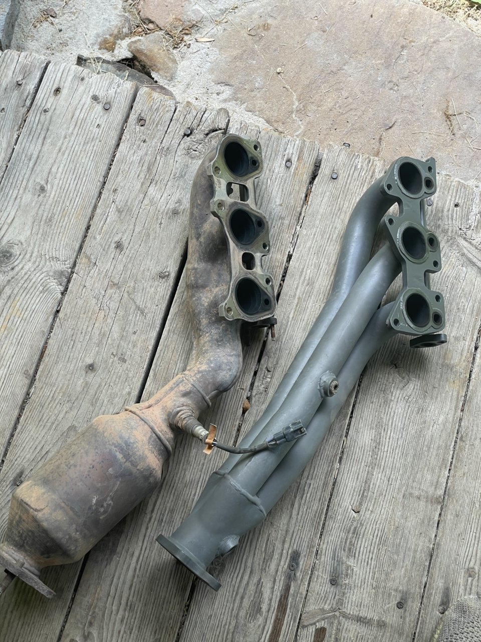

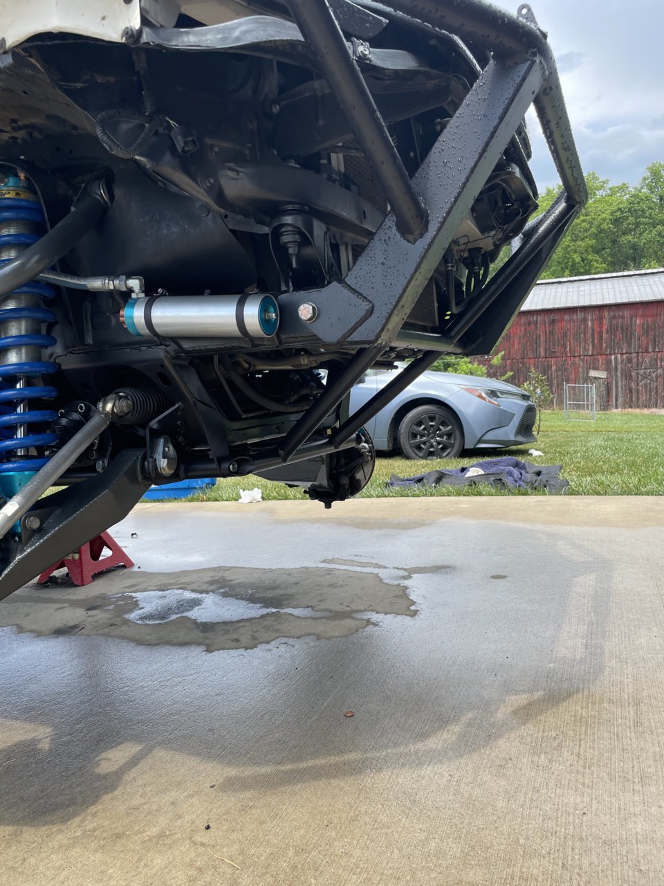

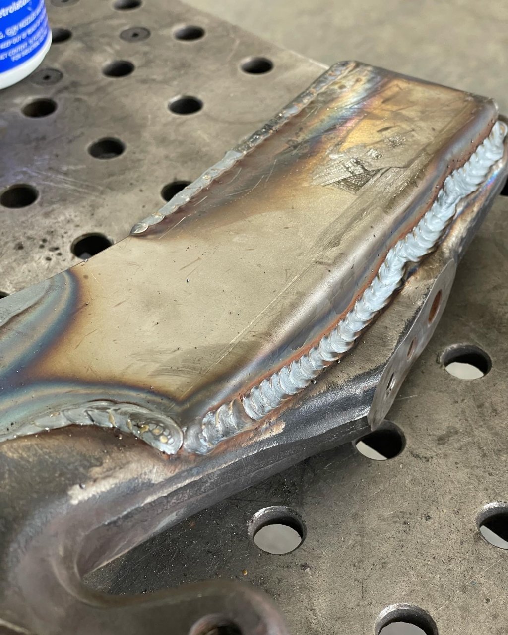

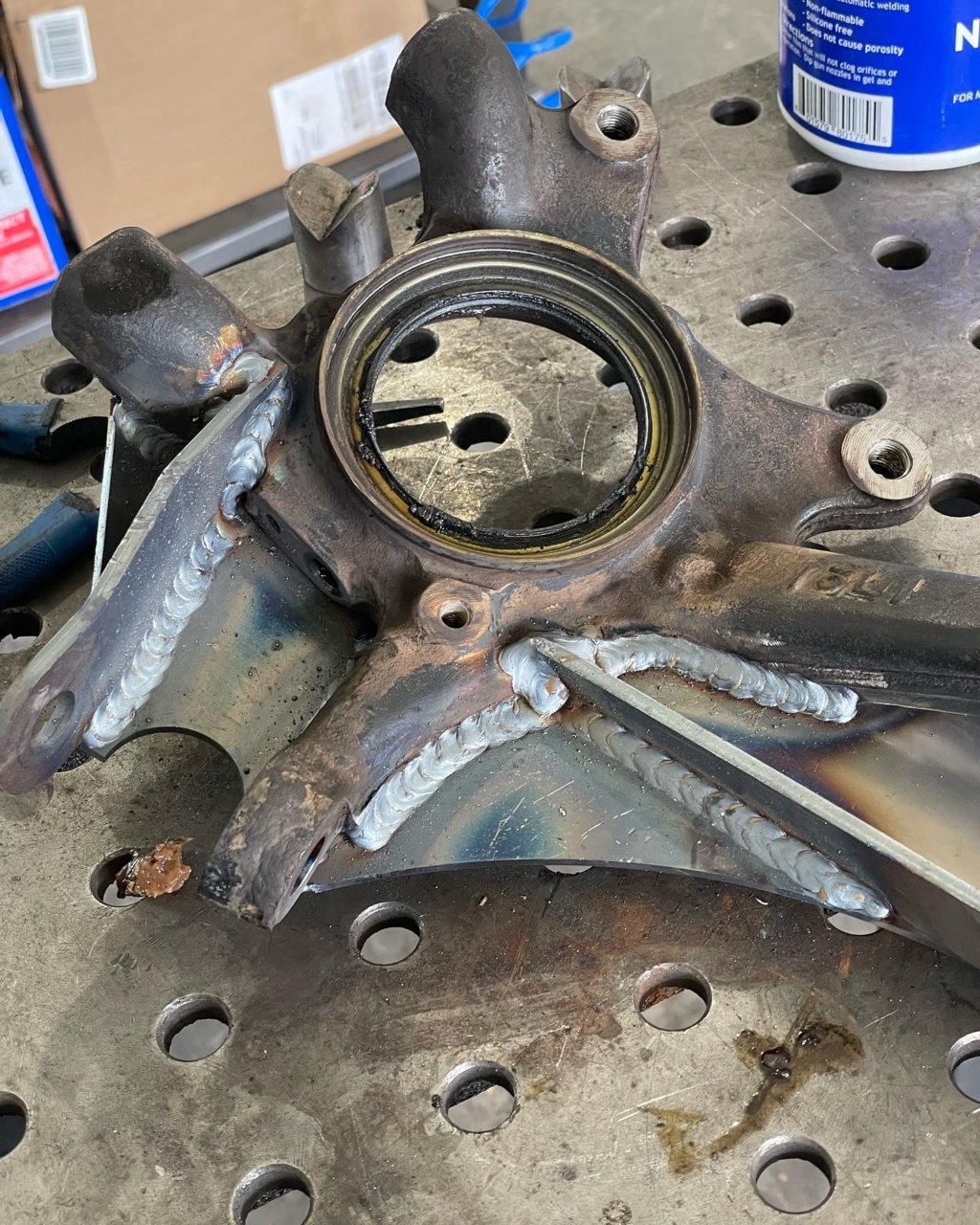

    Got my pivot kit installed and everything is fresh on the front end with new boots for 934s, new tie rods, new springs, new bumper. Anyone know where or how to get cheap aluminum for a skid? I was looking at 5052 3/16” for the bumper.
    also gusseted some spindles for a friend and got some used long tubes on the truck. Inner fenders and gears going in next.
