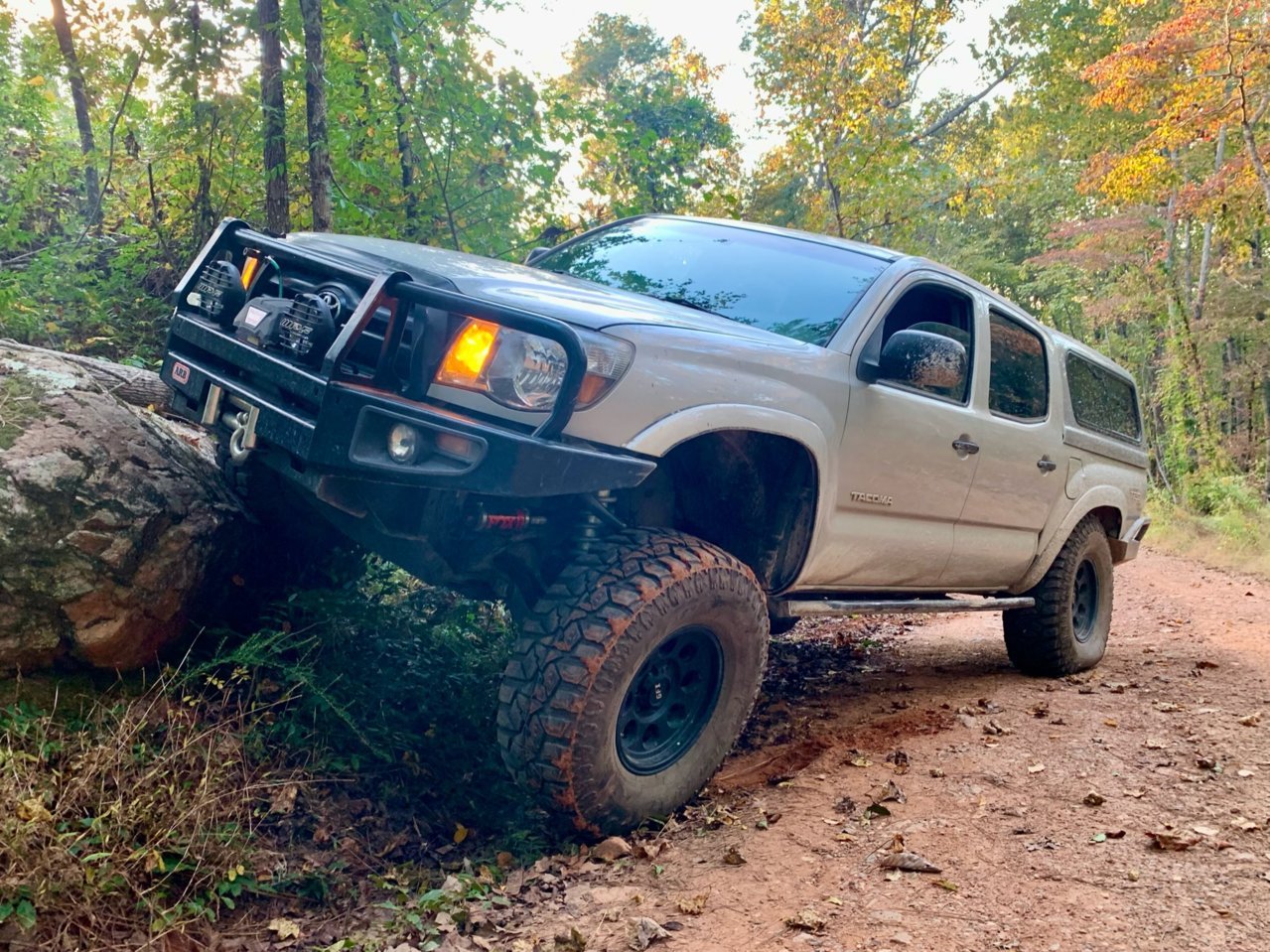

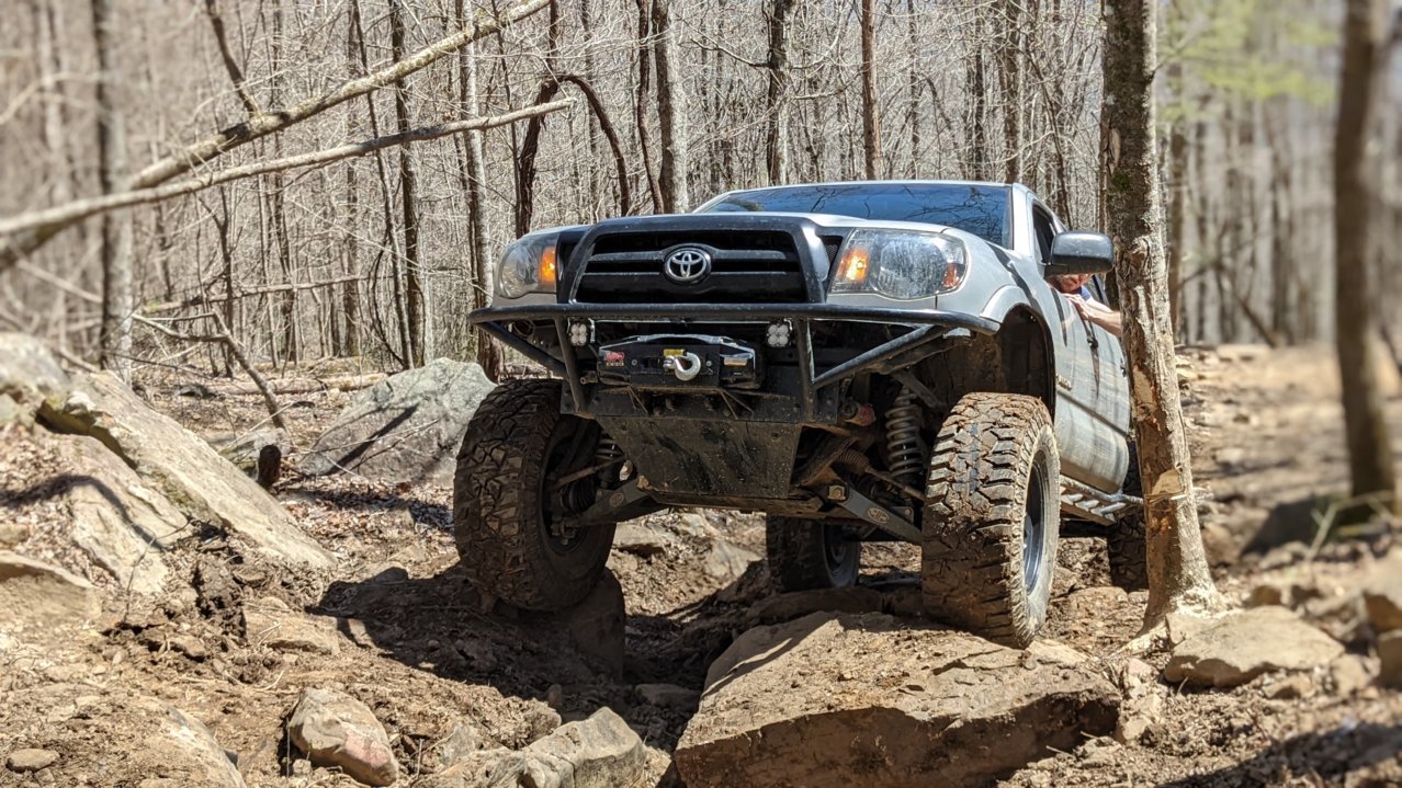

    Got any pics of the truck with the kit on it?
