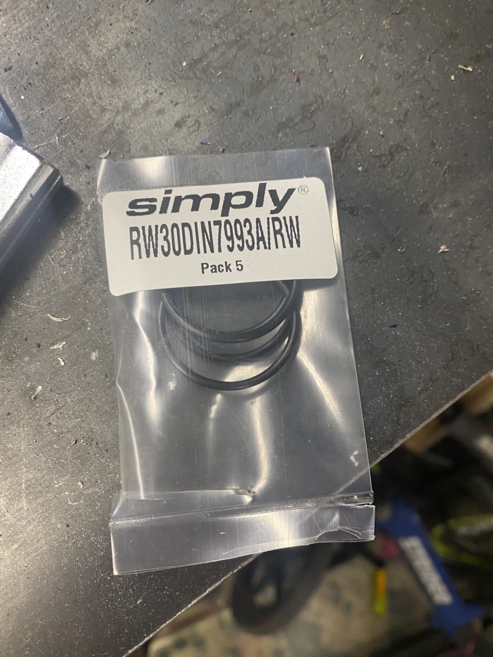

    Quick PSA. I, like others I've seen here have damaged the outer CV wire retaining clip inside the CV. It can be hard to find these. I've heard that they are included in the OEM boot kit, but the kits I found only included the clip for the stub shaft in the differential and the tripod clip.
    I couldn't find these anywhere available for purchase here state side, but I did find them for a very reasonable price across the pond. Package of 5 are about $5 plus shipping. Shipping can be as little as $11 USPS, or $30 for overnight from Fedex. Mine got caught up in clearing customs, but was delivered overnight once cleared. Much like the stock clips, you have beat the crap of them to seat. I pretty well had to body slam them to seat.
    RSR30MM Round Snap Ring 30mm Nominal Shaft Diameter
    https://simplybearings.co.uk/shop/p...haft-Diameters/product_info.html?currency=USD
    Note: this is specific to Tacomas. FJ's have a larger shaft diameter and wire diameter. I have a couple extra tacoma clips if someone has a real emergency.
