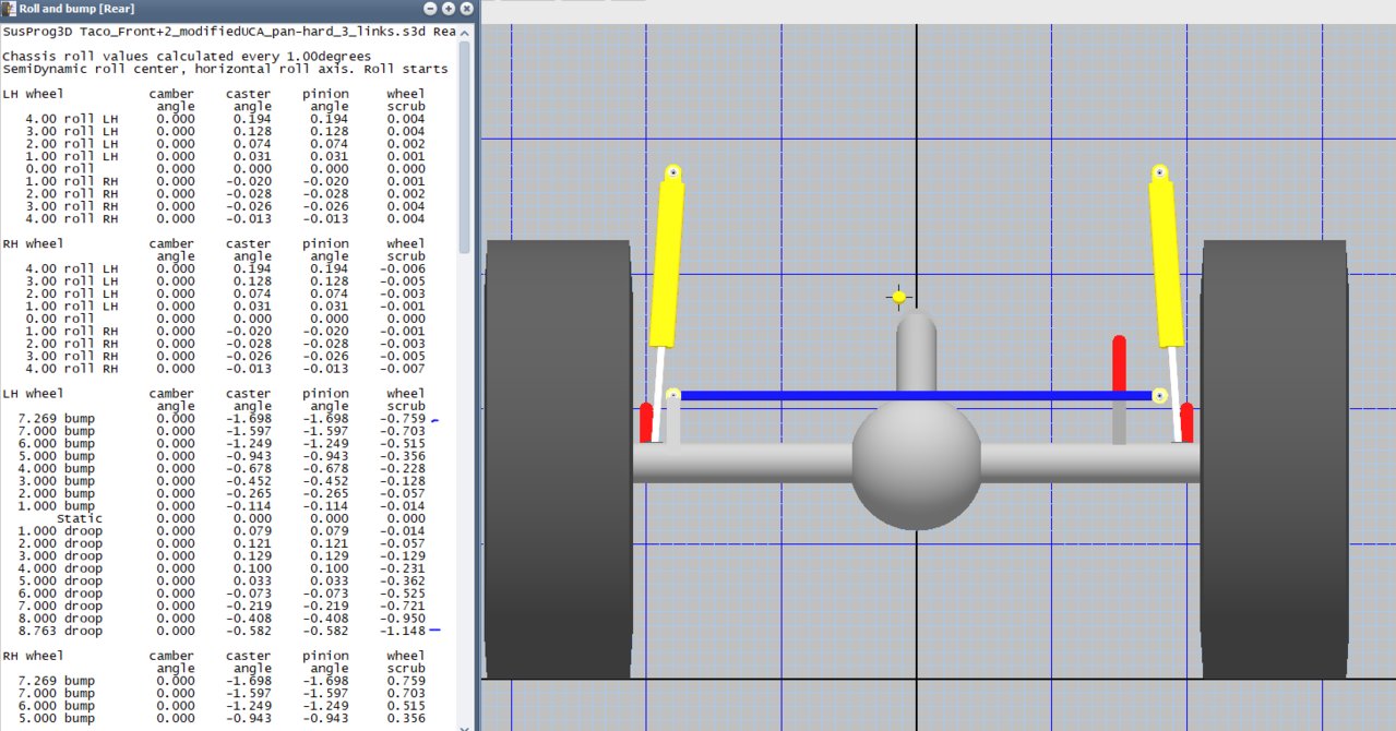

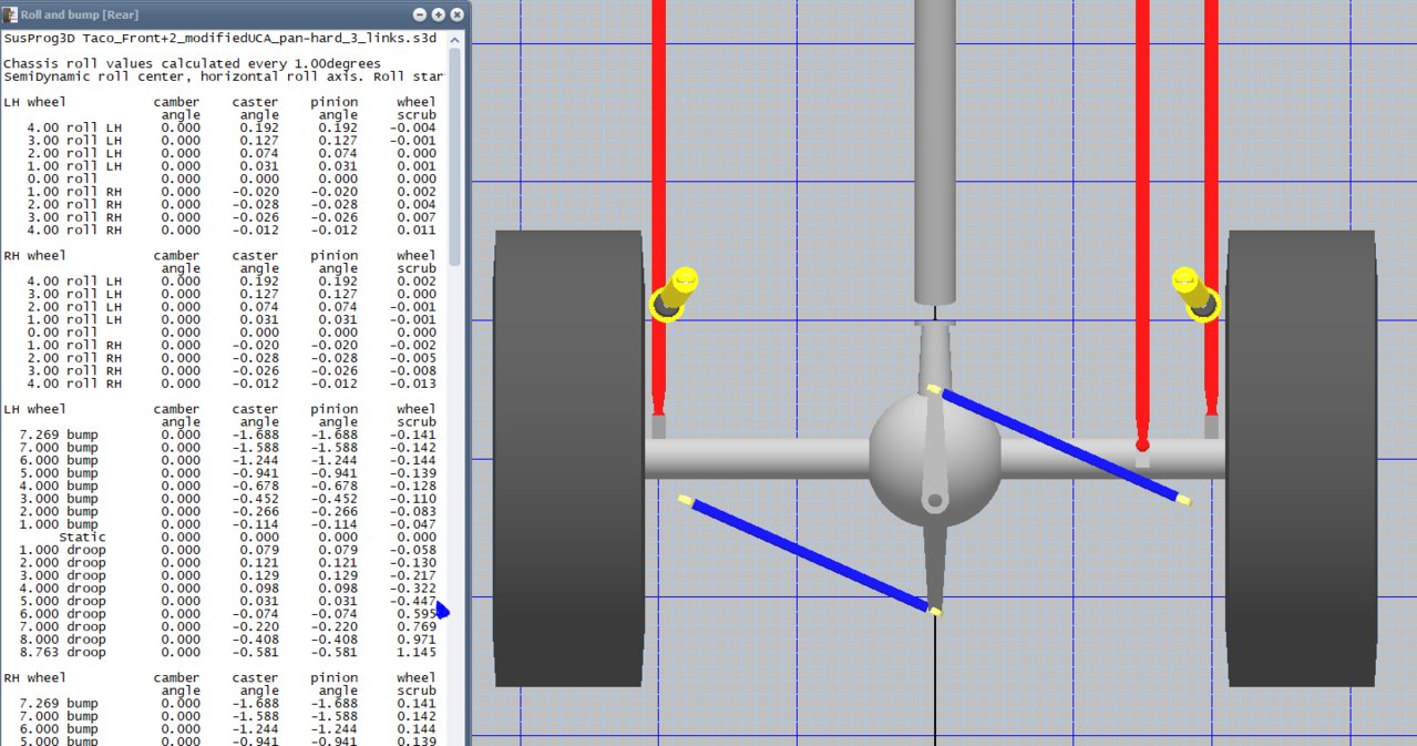

    So I took a first crack at both a 3-link with watts and a 3 link with panhard to compare, both geos use a full parallel setup to see how the lateral control methods compare.
    Watts top view and results:
    the software really limits setup potential... it assumes the watts link is perfectly in line with the chassis, and I can't change that.... the axle shift is very small, up until it starts to freak out (see blue mark), the watts links need to be longer but I can't figure out how to make that happen in the software. All in all it probably has significantly less axle movement than a panhard bar when configured correctly.
    Panhard rear view and results:
    3/4" of a shift at full compression and 1.125" at full droop, in the same direction however, this is with a 36" bar.
    Kinematically, neither of these are superior to the conventional triangulated 4-link found on almost all TT... but for us trying to get travel out of the rear end without a back half, theres probably something there with the watts link.

    It seems like lowering and widening the outer pivots of the watts link would help with issues on droop. Possibly shrinking the spacing on the center pivots would help too, depending on the angle at droop.
    I've considered doing this a few times but haven't gotten around to it.

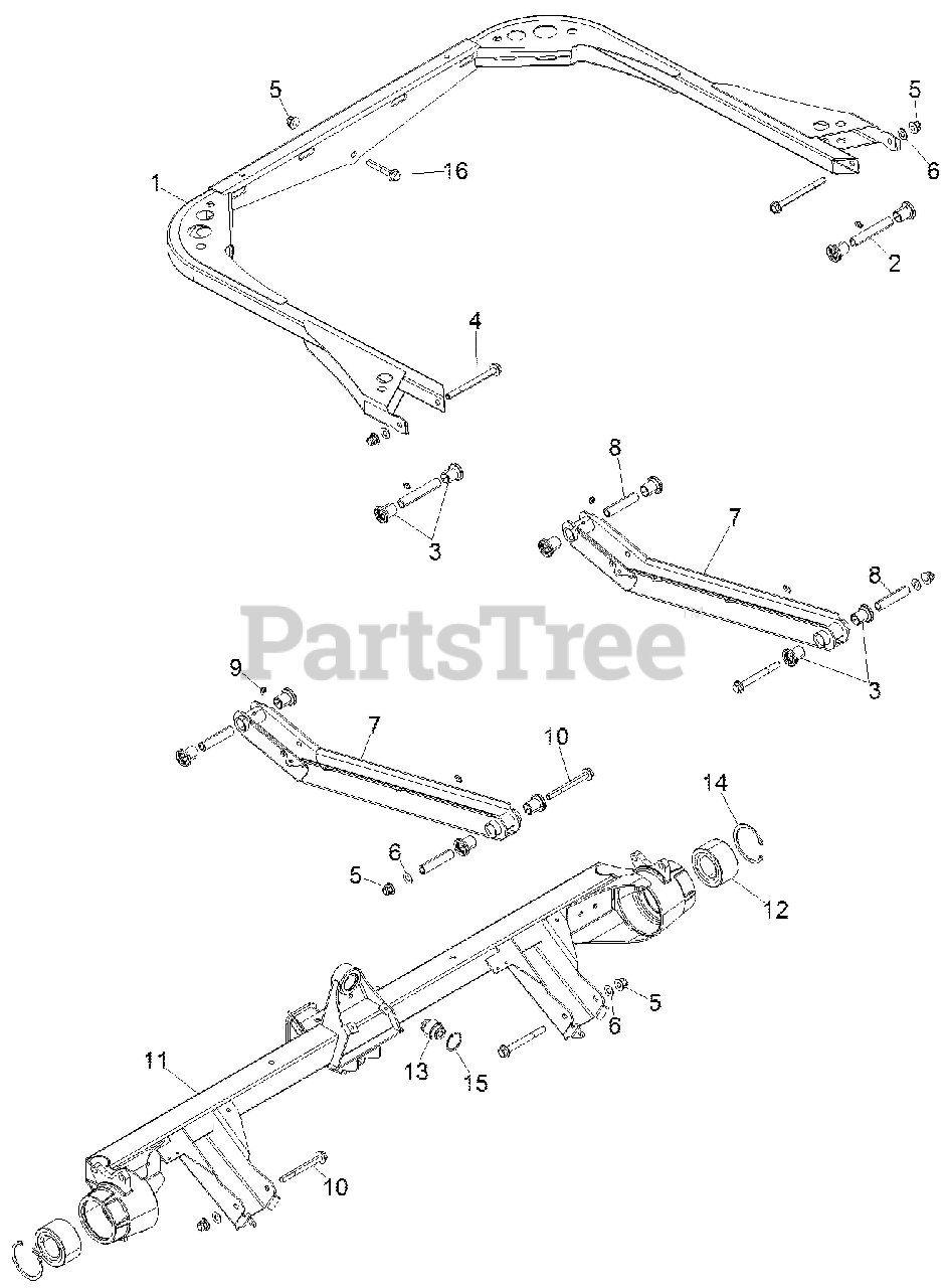

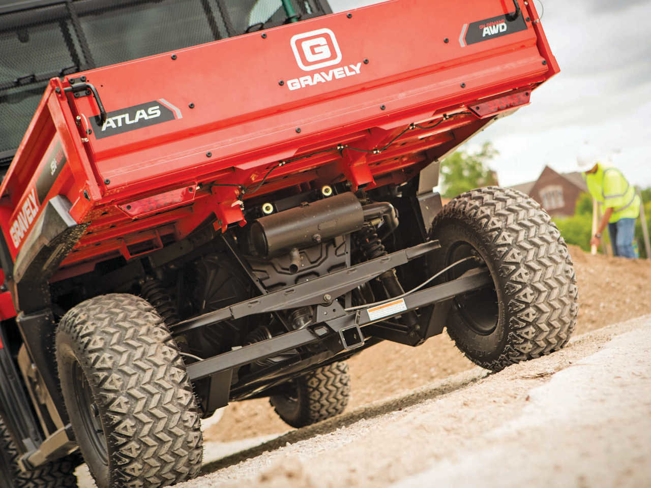

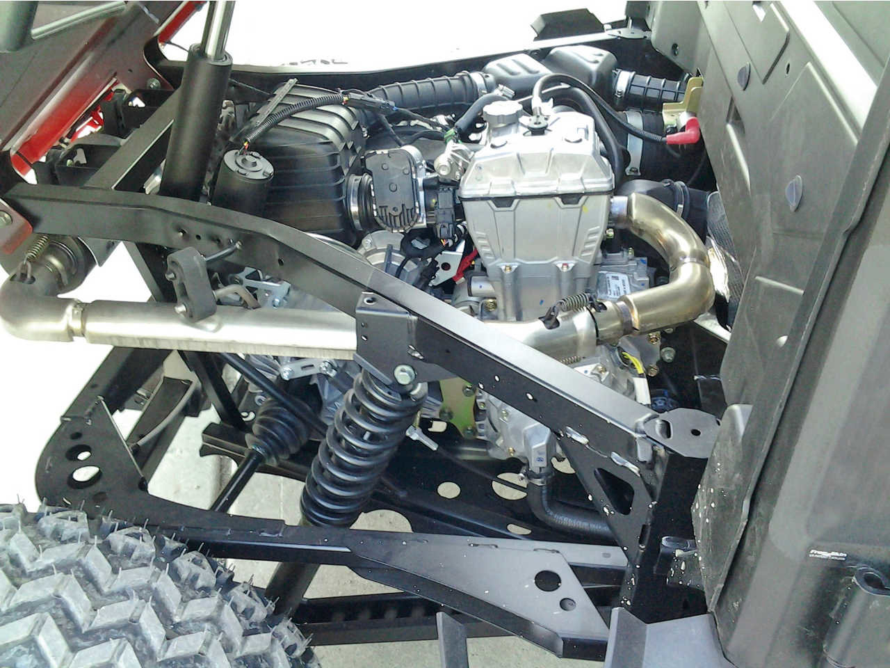

    The 2015 Gravely Atlas side by side has a funky De Dion type off road rear suspension. My brain imeadiately started spit balling the first time I saw it. Check it out...
    The 2nd Gen Sequoia rear diff and possibly CV axles would be a great base for something. 10" ring gear, 36 spline 1.457" stubs, gears and an e locker are available.

    Some cool packaging there. I wonder how it handles?

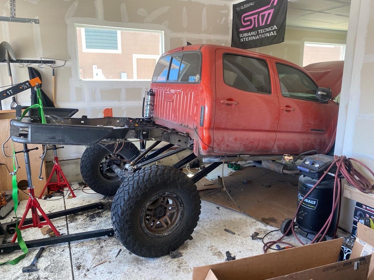

    I’m hoping to start this process in the next few weeks. Been playing with the Calculator a ton. Can’t seem to figure out how to stop a huge delta in pinion angle. Trying to be a sponge on all the forums and videos of people building 4 links.
