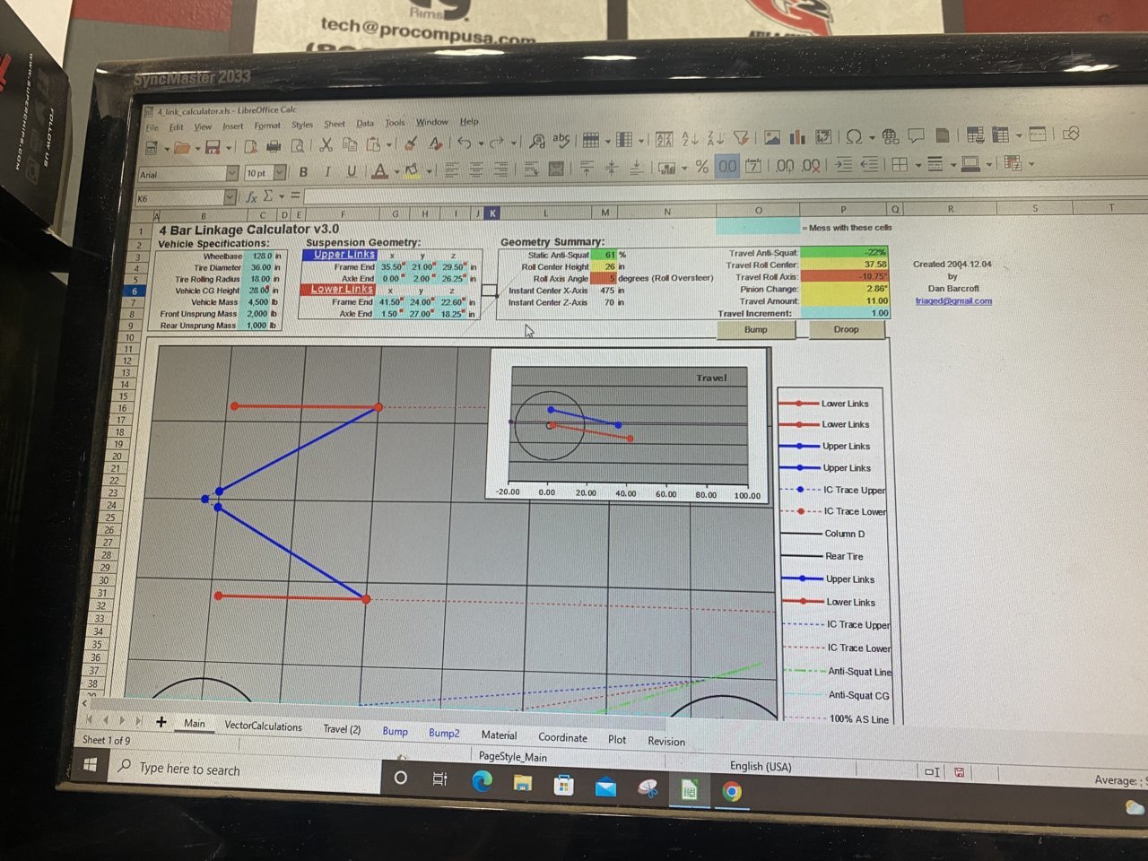

    I ended up with 40” lowers and 35.5” uppers ( not measured on their angle, just straight from axle to frame)
    this is how my mounts are set up give or take noise.

    40” links are super short, what kind of travel # are you looking at ? seems like your drive shaft plunge is going to be extreme with such short links. typically a dcsb uses a 52” link

    Just under 25” of travel. I do a lot more rock wheeling so shorter links were a better way to go for me. We will see what happens to the drive shaft

    https://www.tacomaworld.com/threads/daymans-karate-class-but-you-wont-learn-nothin-4-link-lt-and-previous-iterations.755134/
    Busted Knuckle’s four link videos on YouTube are very helpful and easy to understand.
