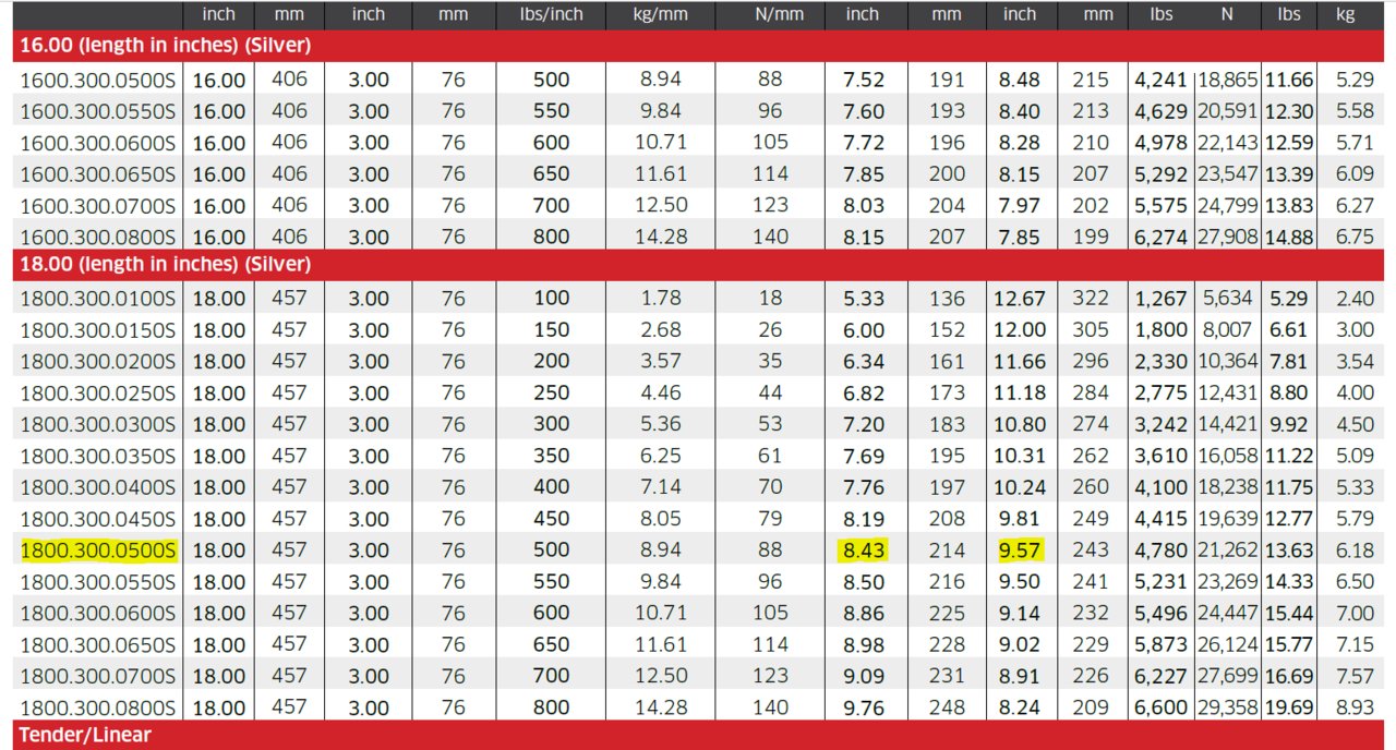

    Weird.....with my TC kit I've got like...1/2" of preload available for safe use, outside of that i'm uncomfortable with how close it gets to coil bind.

    Because you have “over cap shocks”. The JD kit runs a standard 8” shock with a raised upper shock mount to prevent coil bind

    To be fair, I wasn't taking the physical limitations of the spring mounting onto the shock into consideration. I was purely looking at the #s for that particular spring.
    This ^ Over cap shocks are great for obtaining a shorter collapsed length on the same stroke shock but you loose thread length on the outside of the body.
