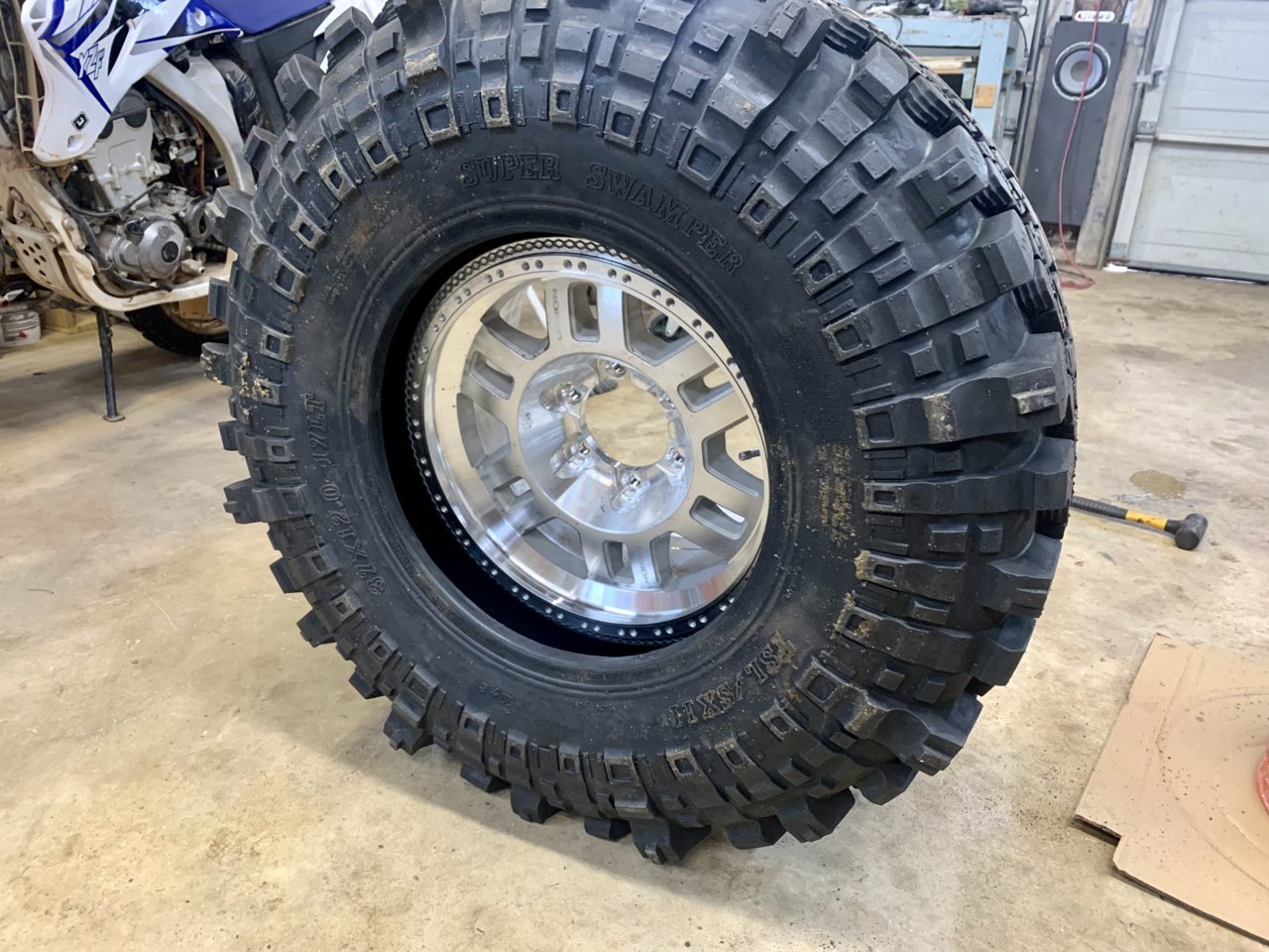

    Good to know. I thought it would be night and day just with larger rotors/pads so I’m glad I didn’t just start buying shit without asking. I’ll probably remain focused on steering then worry about stopping haha but first death by 140 bolts

    The first one I did, I did it completely by hand, even snugging up the bolts. That took like 30 minutes and numerous hand cramps. I quickly learned to use my 1/4” impact driver to snug everything up and then just hit it with a torque wrench for the final pass. Much faster and easier.

    That’s the plan I’m going with tonight. Didn’t see any torque specs for these specifically, but I’m guessing 20 ftlbs is probably the norm for aluminum

    That's what I've seen around the interwebs too, 20-25. I torque mine to 23.

    18lbs with grease... make sure you grease the shit out of the bolts!

    Will dish soap and gear oil soaked saw dust work? There’s a lot of that around here at the moment. I’m making sure to get it all over the place.
    Do you use anti seize though?

    Personally, I used anti seize on mine. KMC's have steel threaded inserts though.

    Yeah these just thread into the aluminum so I’m not sure how the yellow zinc bolts interact with it. Got two sets of holes if you make a boo boo which is nice haha

    that’s a recipe for galvanic corrosion get some anti seize

    I antisiezed and went to 18ftlb on mine. Mine even came with torque instructions for grease vs dry
