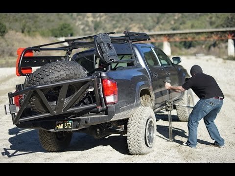

    Anyone have any experience with the Wilco Tiregate installed with fiberglass bedsides? I’m worried about the steel bedsides having been designed into the plans of the tiregate with the weight of a 35” tire on it. Not wanting to be at the dunes and hitting some slight jumps and then having some issues.

    Those things aren't set up out of the box to get beat on, they'll end up cracking and damaging the areas they mount to. You can set it up solid, but it will take additional work and bracing

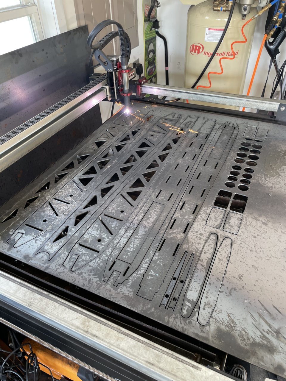

    Started cutting out my links, hopefully I’ll get them welded up soon.

    nice cable guide, I need to make that upgrade on mine

    I wouldnt attach anything to glass without them being completely supported by a back half cage. Im in desperate need of bed stiffeners with my rears. Already spider cracking from some beach abuse

    Attach as in stress the bed anymore without steel bedsides.

    I wish I had room for the full size crossfire! Whats the plate thickness?

    I assume you are asking @NcTaco27
    Looks like 3/16 in his picture.
    Not sure if open truss or truss on plate. Looking at the slot size in the top piece, I assume truss on plate...
