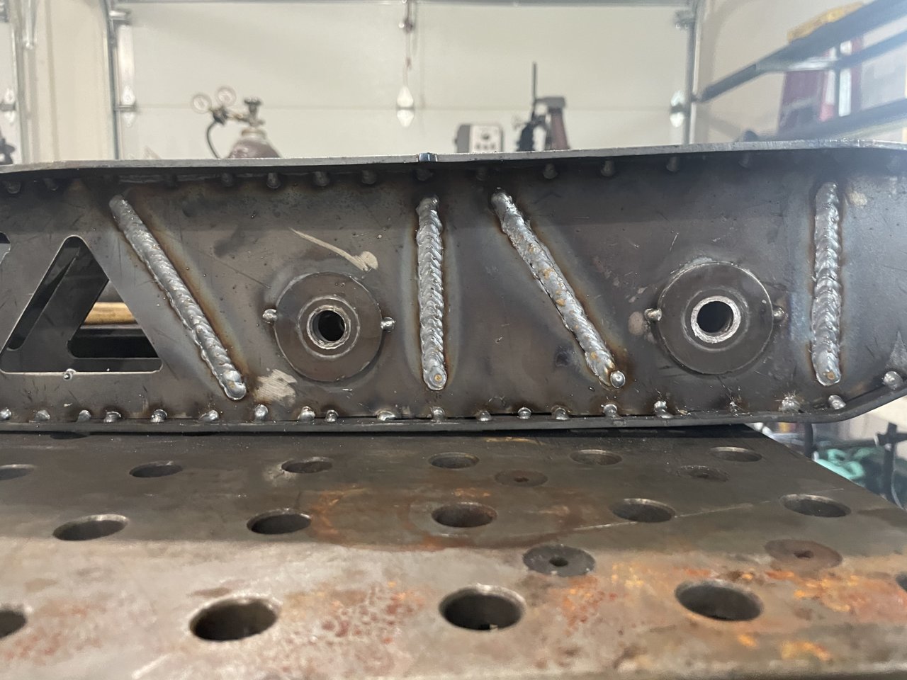

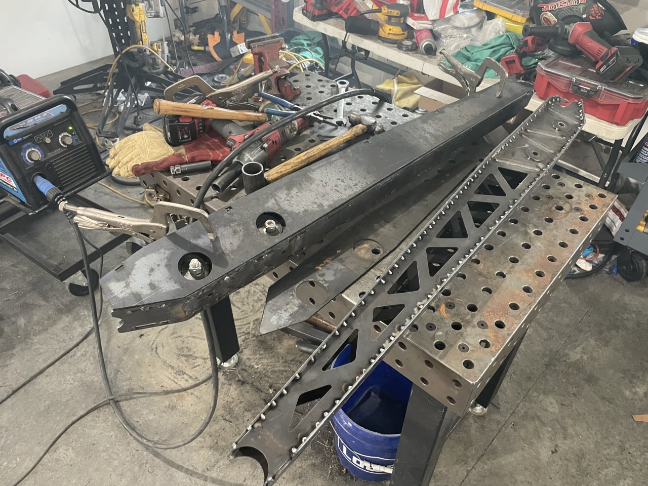

    Thanks! I like it a lot, it wasn’t too hard. The bracket I just made out of some scrap nylon on the mill at my school. Would have been a lot easier with a 3d printer.
    I wish I had room for the new one that held 8ft sheets. Moving the sheet around non stop is kind of the only bad part. It’s 1/8” there’s a ton more plate work going on.

    Build a jig for those trailing arms or at the very least clamp them to the table. And move the heat around in opposite directions or they will twist like a pretzel
