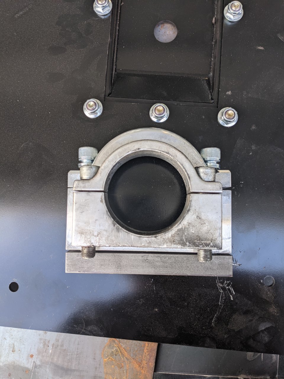

    What ram do you plan on using? I set it at as close to stock centerline as i could.

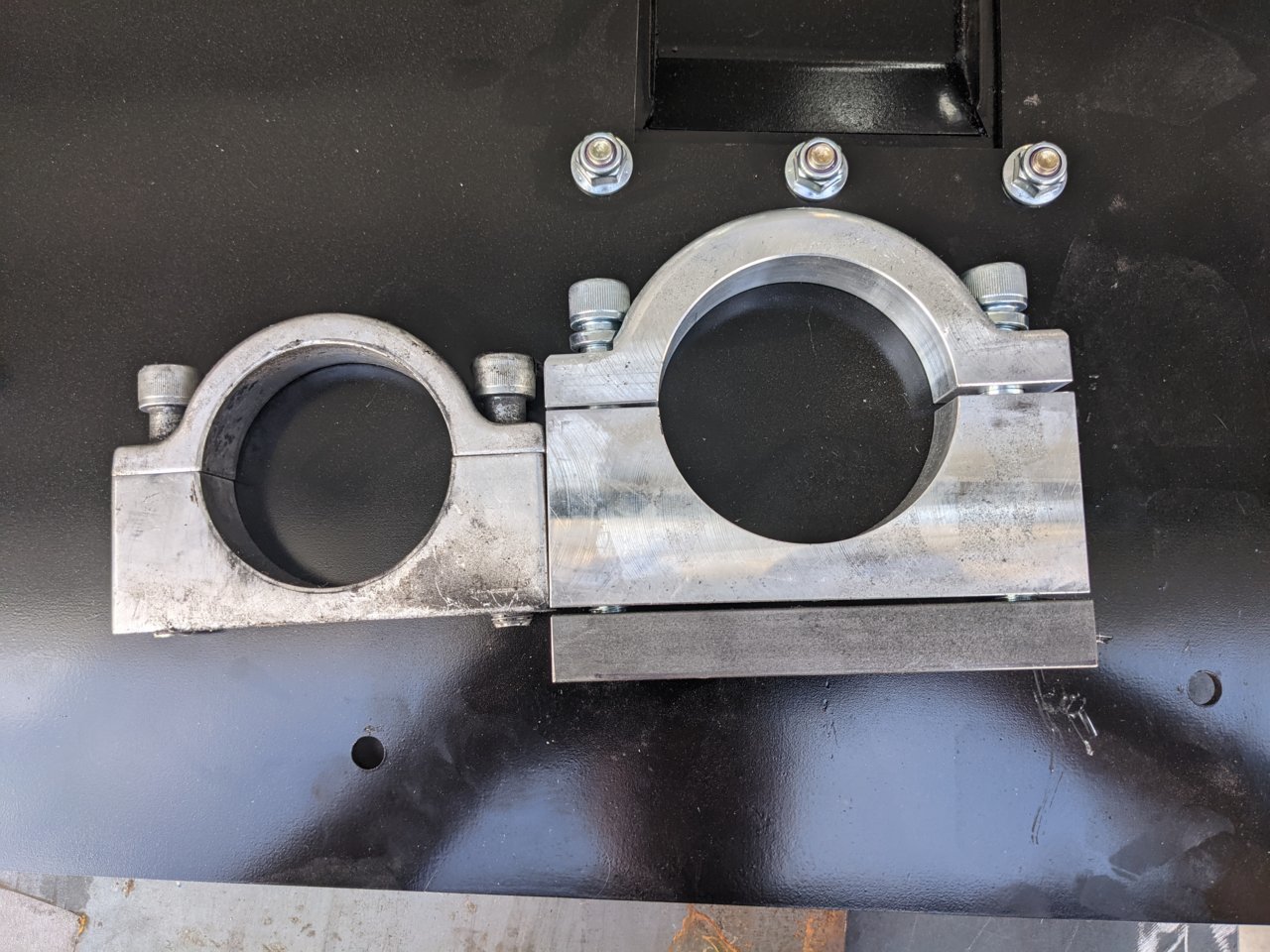

    Well the 3.0x9 mounts are way bigger than the 2.5x10 mounts and itll effect how you fabricate the center section. Also the mounting width of the brackets are way different. Ive done both and will say they both have thier issues and ways you can work around them. Neither is a perfect fit and youll have to choose which option you will want to fabricate for.
    My 3.0 ram has a 1/4in plate on top of the 12g factory metal, i cut out the top section and plated everything back in.

    Nice, that doesn’t look too intimidating now that I can visualize it. What are the trade offs of using the 3.0x9” vs the 2.5x10” or vice versa?

    3.0 is more powerful than the 2.5
    The 3.0 fit a little better with the factory diff mounts. I used the passenger side diff mount as the forward ram mount hole(this also offset the ram 1/8-1/4 inch to the driver side and internal ram stops need to be corrected). With the 2.5 i had to run the mounts inward a little more that placed it under the oil pan, i ended up putting a hole into the oil pan because of motor mount flex. The 3.0 mounts are spaced farther apart and i have alot more room now.
    The 3.0 mounts are so larger it needs to be shaved down to clear the diff and im still forward of stock, this effects ackerman. The 2.5 should be able to fit close to stock position, but you run into issues with the diff mounts or oil pan clearance.
    The 2.5 end to end is barely the right length, i had to screw the heims into the ram instead of having the clevis on the ram. The 3.0 is shorter and i had to add spacers behind the clevis (which is screwed into the ram).
