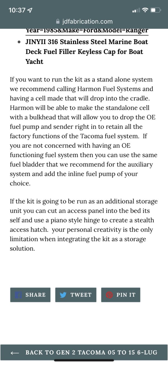

    Is there a pump/fuel cell that works out of the box with 2nd Gen Tacomas? I just want to splice wires, change fittings and be done. I can’t get the clamping ring to seal worth a shit and I’m wanting a semi canned solution if it’s possible. Would prefer to keep the stock gas gauge

    $1500 without a sender is overkill for what I need.

    What are you currently using?

    RCI 19 gallon with a motobilt jk clamping ring, stock sender

    Is it the weld on ring? Or bolt together?

    The tanks are mostly all the same.
    Try this instead, it uses an o ring. I have it, but havent been offroad so im not sure if it leaks yet.

    Can’t weld aluminum and would still have the clamping ring to deal with. I don’t know where I messed up. Might be the jeep sender is thicker or thinner and it just doesn’t want to clamp evenly with the taco pump. I might just make room for the stock tank back there and be done with it. I’m going to do bobbed bedsides so it would be covered up anyways. Held these up to it and decided I liked the look better haha
