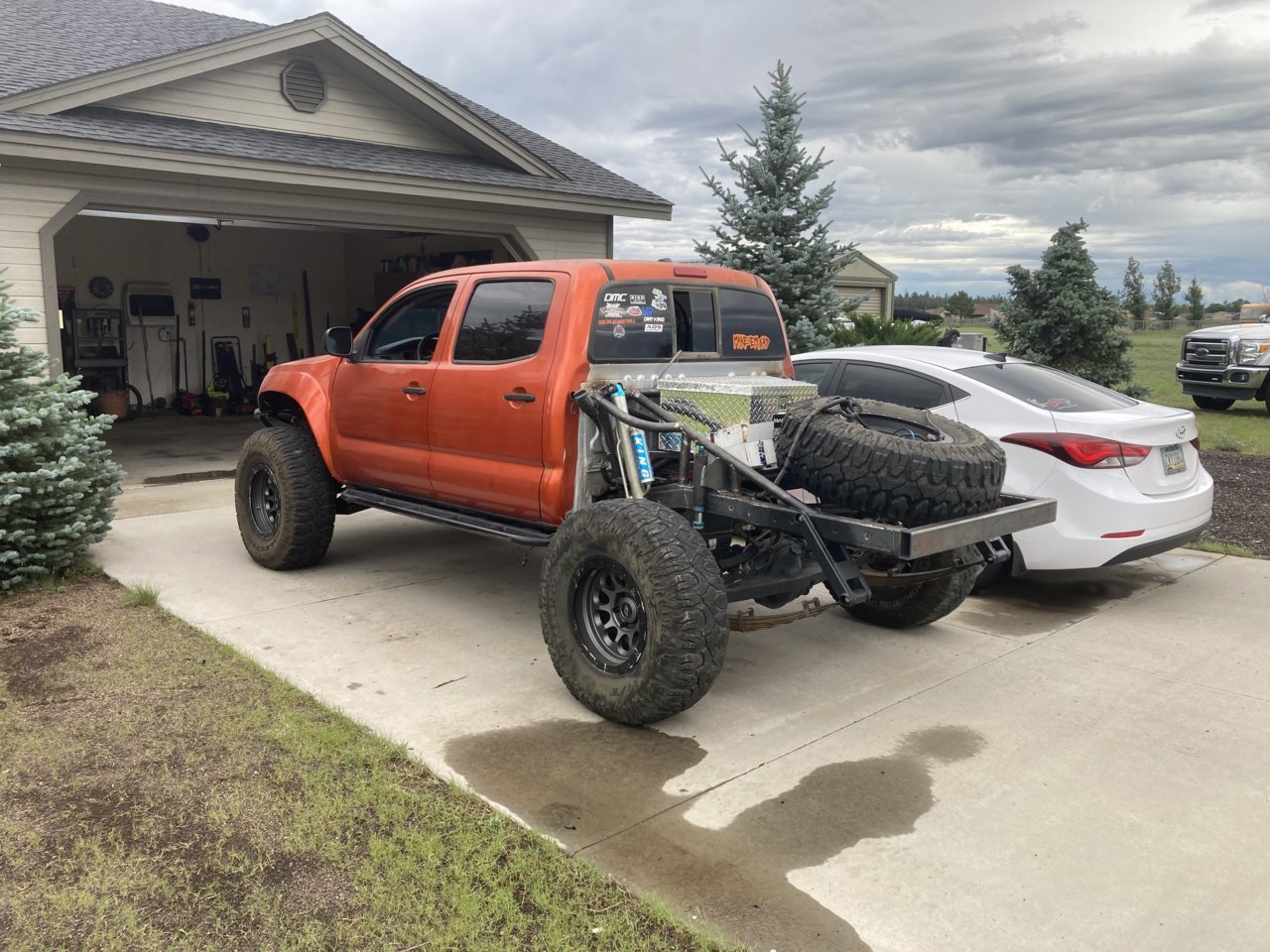

    Yeah I think it’ll look pretty good. I dig the truggy bed especially on access cabs, but I really liked how these looked ratchet strapped on there haha gonna cut them down about a foot and use the OEM taillights but no bed or tailgate parts.

    Gonna be what I do. Dig the truggy look but bedsides will go back on.
    Was gonna bob the bed but ended up not being able to shorten the frame up enough to be worth while because the shackles.

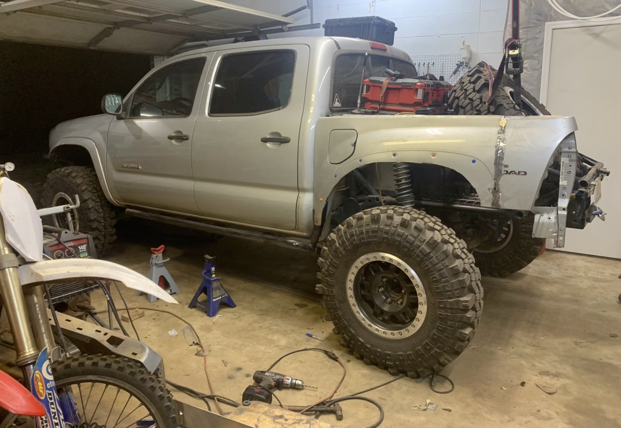

    Got a jump start on it tonight. I think it’ll work out alright. I have low expectations so I’m always pleasantly surprised :washing:

    Looks good. Yeah I could probably ditch 8” off the back but welding my fiberglass bedsides back is a little tougher.

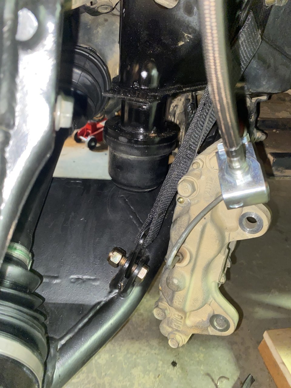

    I just finished up my long travel build this weekend and i have super bumps. Used my old rear stock u bolt mounting plate as an extension. Just so happened to be the height i needed. Just cut the ends off and welded it to the frame in stock location. Seems to work well.

    I'm curious to know what the difference between the 2nd & 3rd gen would be in that regards. I thought the frames were very similar as far as geometry goes.
    That would be a concern. I would be weary of running a hydro to an LCA that isn't reinforced to handle the load. You also have to be cautious of running hydros on an IFS as they typically engage early in the travel if not properly setup. Lots to consider there.
    Your shocks should be fine as long as you're not bottoming them out on hard hits. The best way to confirm is to install the shock with the spring removed and fully cycle. If it's that big of a concern for you.
    How much up travel do you have with that setup? How far is the bump from the LCA at ride height?

    About 2- 2.5 inches. . About .25 from bump stop. If id dint have it setup that way the upper uni cup would bind before the bump stopped it. I could fix it to get more but im fine with it for now. Still about an inch .25 of travel left in the shock. When i decide to cut more off the fender as well might revisit it knowing ive got travel in the tank.
