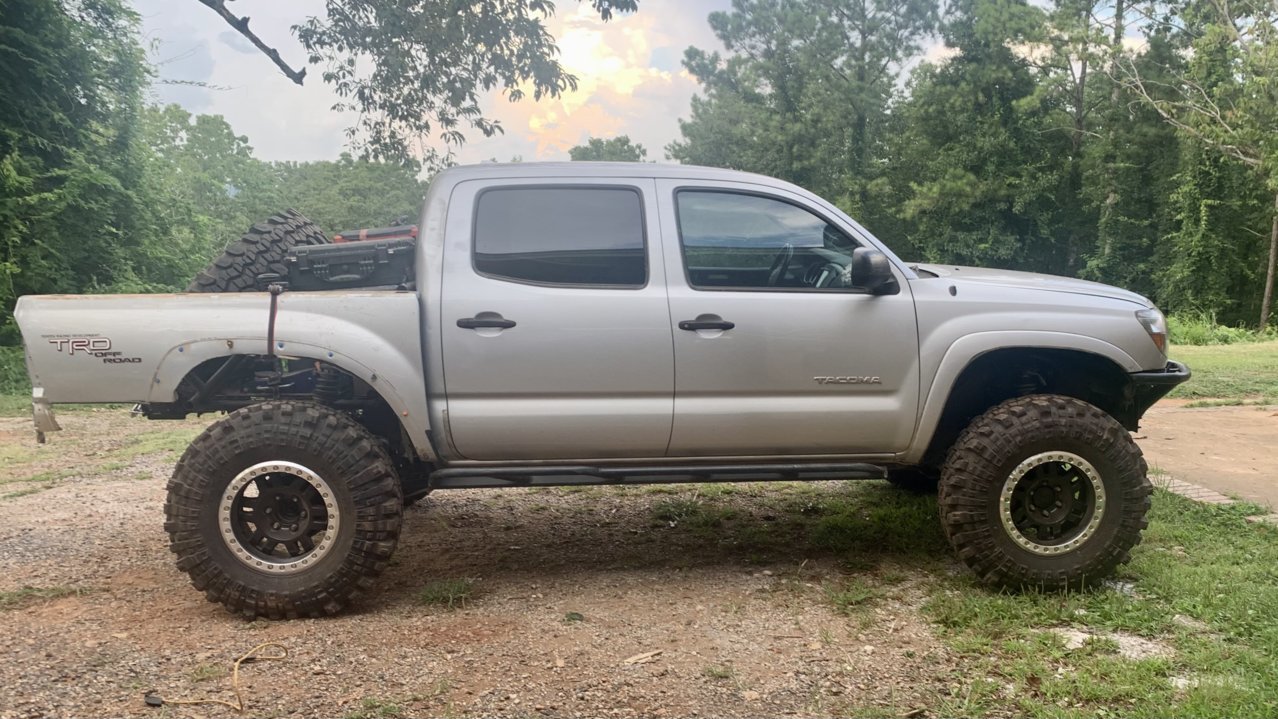

    Turns out when you ditch 400lbs to a well tuned truck, it rides like shit

    Just backing up my statements from last night where I said I was not an expert. I just couldn’t wait to finish the truck before driving it.

    Question is, is the pack too heavy or your tune too stiff now?

    Yes and no. Ride height is pretty perfect actually, could be a touch lower with the addition of the spare tire. Some decent tuning available with the bypass to lighten it up some. If that doesn’t work then there is also the option of revalving/drilling free bleeds in the piston. Gonna be some trial and error and should have it dialed back in soon enough. Also waiting to hear from ads for my 3.0x5 tube sponsorship since their shocks do flow more than the others

    Word. Sounds about right as far as these never ending projects go. But at leasts it’s tunable. That would be awesome if ADS pulls through. I removed a similar amount of weight but I’m still SOA and on expo springs. Total dumpster fire even with the compression tubes opened up.
    Uniballs, geometry, travel, bump stops, you spelled out all the evidence of that kit being a hot mess in your post. So it seems you know what your issues are already.
    I personally wouldn’t mess with that kit. Since it looks like it’s going to need an overhaul to the same scale as getting a new kit. If you have time to kill screwing with it, that’s your prerogative. Don’t be astounded with someone else’s opinion.
