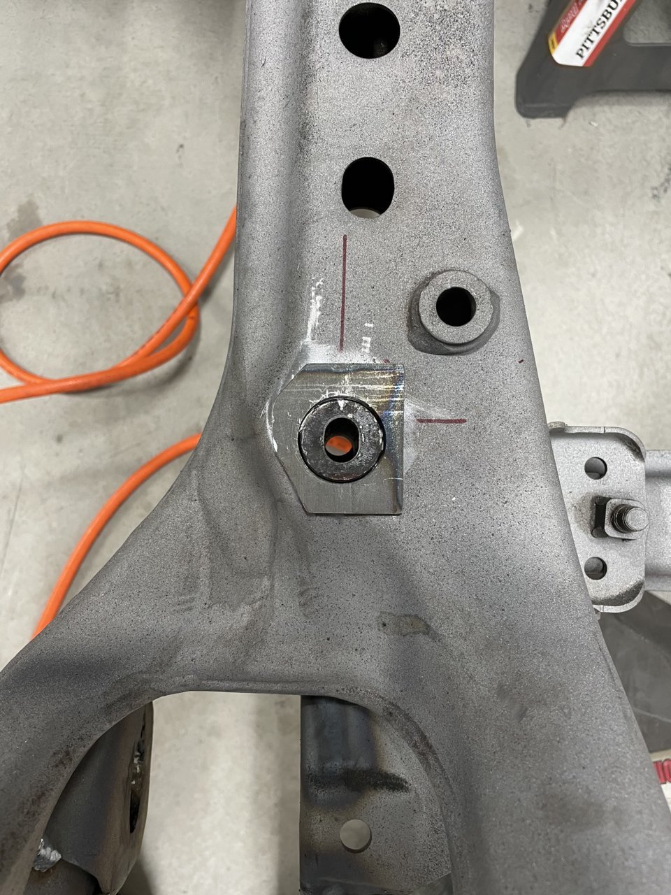

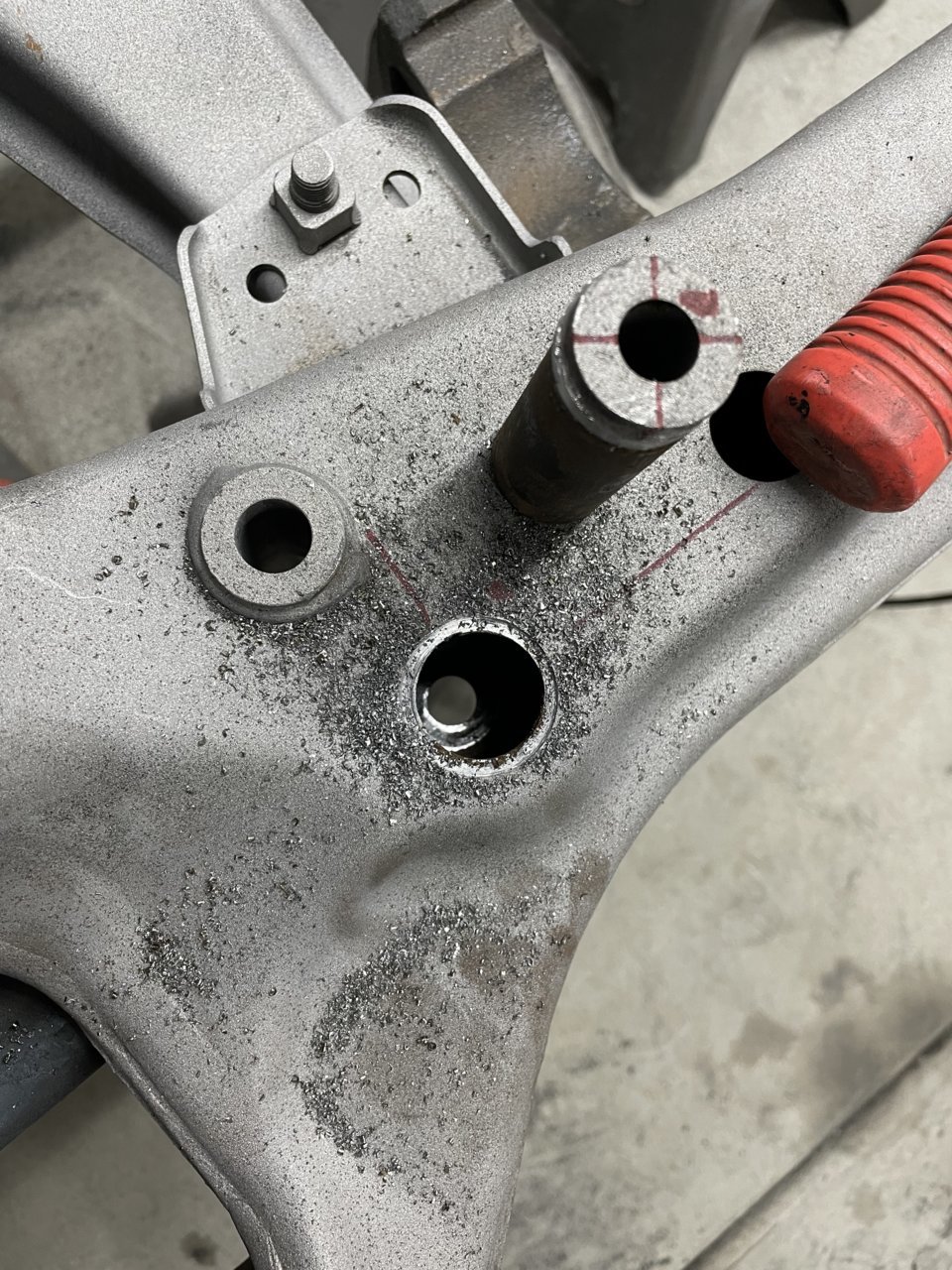

    Hole saw worked out pretty well for removing the steering bungs for the tundra rack.

    Is the front of your truck torn apart or something? You’re doing this on easy mode with that much access lol

    Yeah it’s currently just a bare frame.

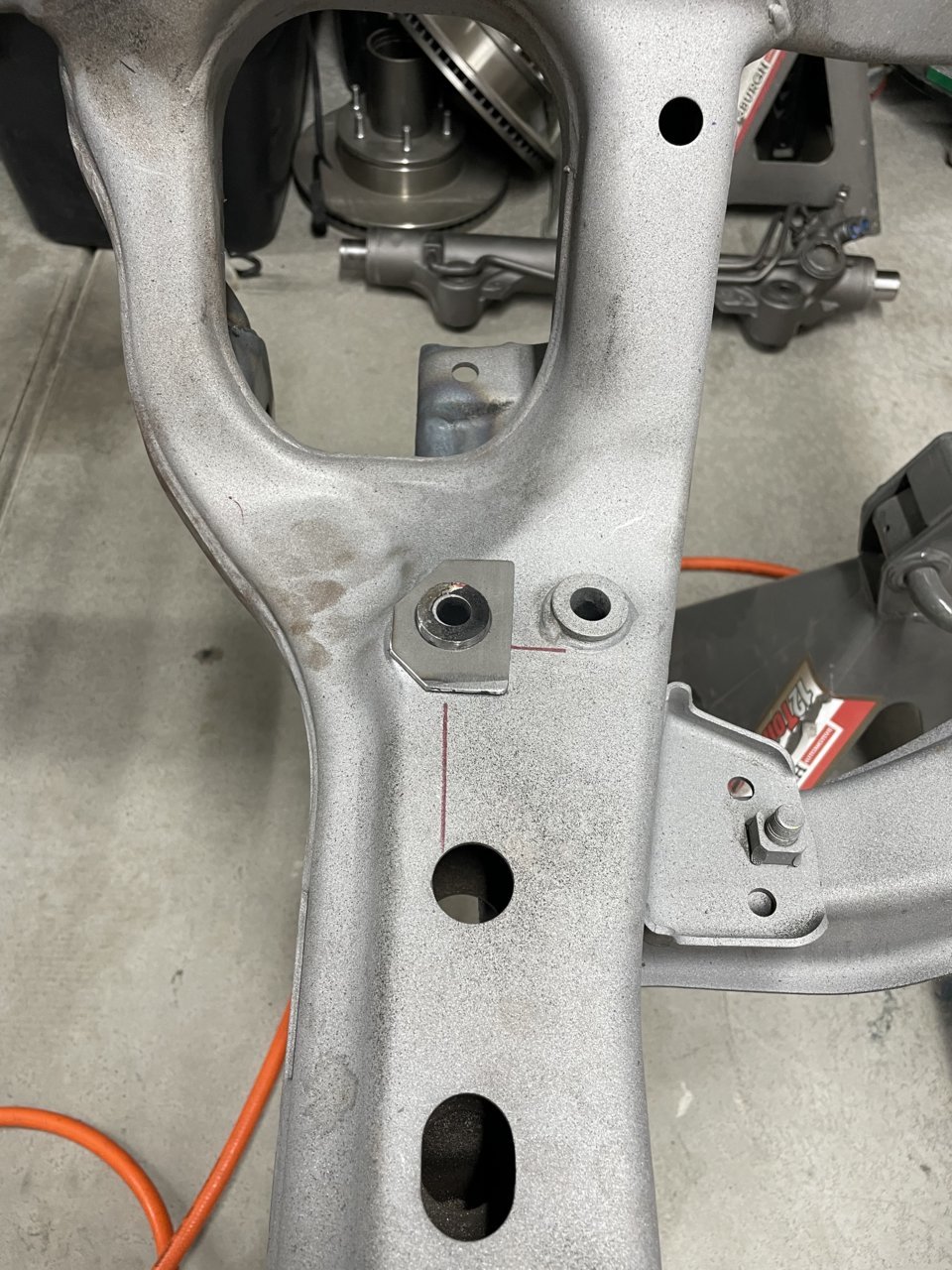

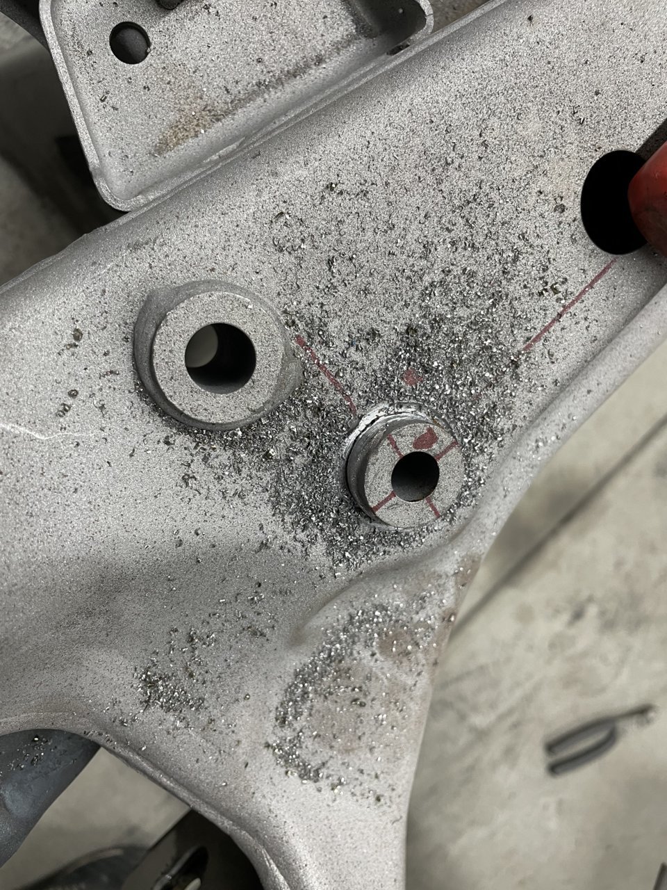

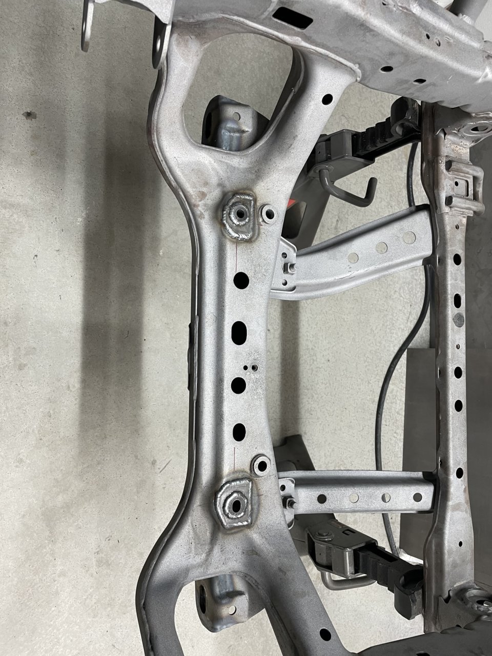

    Used a plasma cutter to make the holes wider and then cut 2 plates out and welded the bungs back in for the tundra rack install. I didn’t touch the bottom holes until I fully welded them then I sent a drill bit down the hole.

    What're you going to do about the difference in bolt diameter between the two racks? Put a sleeve in the rack bushings? Drill out the bungs?

    Either find a bushing or ream the holes to the size of the rack.

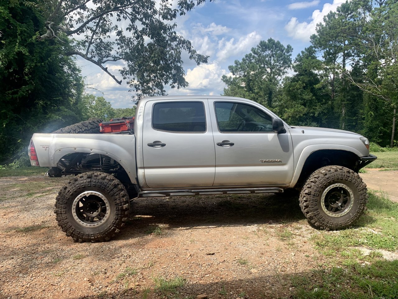

    It’s pretty much back to stock now. Might sell it and get a rav4.

    Finally told ya the bed sides would look good on there

    Yeah you righty, me likey :fistbump:

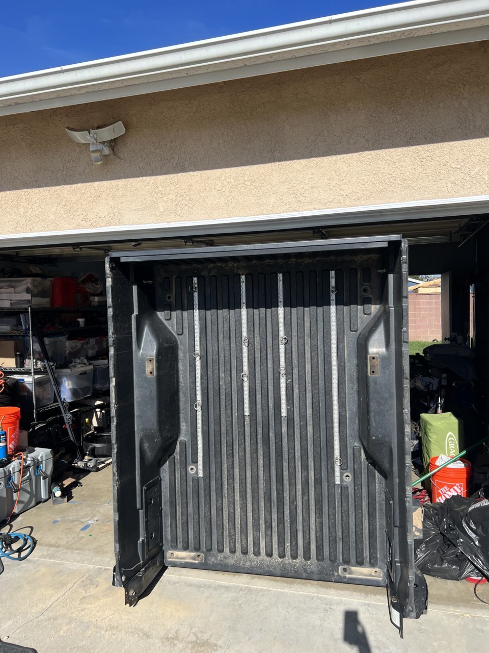

    Anybody want this?
    minus the L track
