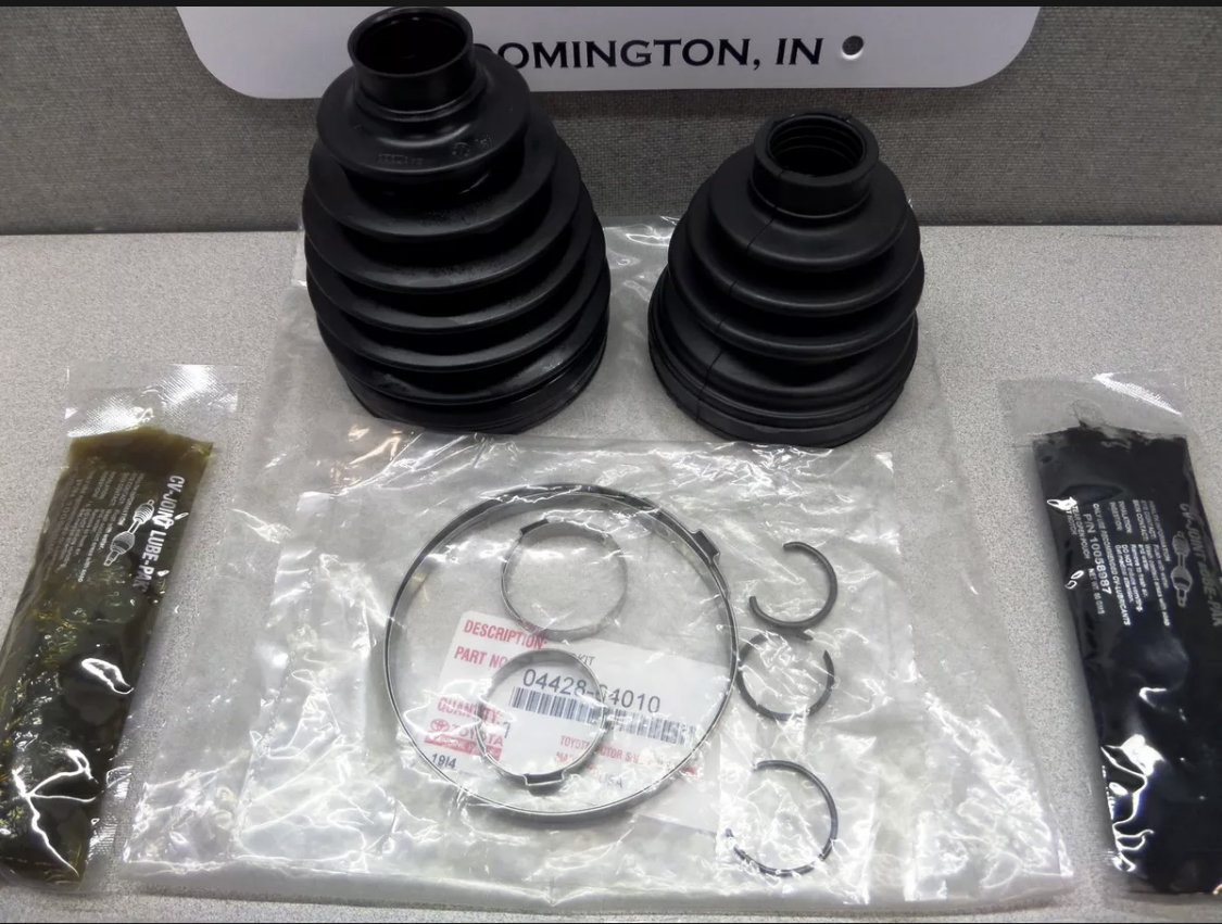

  8. Aug 14, 2022 at 9:27 AM
    EatSleepTacos
    Mar 24, 2015
    #151688
    59,840
    Randy
    West Valley, AZ
    2017 4Runner
    An OEM boot kit

  10. Aug 14, 2022 at 10:31 AM
    EatSleepTacos
    Mar 24, 2015
    #151688
    59,840
    Randy
    West Valley, AZ
    2017 4Runner
    Oh really? P/n 0442804010
    Comes with everything you need to rebuild one cv axle. Both boots, clamps, grease and clips. I bought them to assemble my 934s.

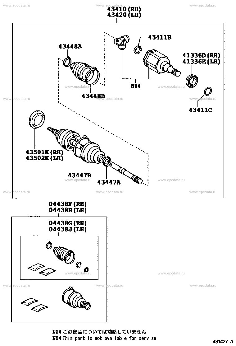

  15. Aug 14, 2022 at 11:31 AM
    EatSleepTacos
    Mar 24, 2015
    #151688
    59,840
    Randy
    West Valley, AZ
    2017 4Runner
    Judging by this pic, the two C clips are different. The axle has three c clips on it. One holds the outer joint onto the shaft, one holds the inner joint onto the shaft, and one holds the axle assembly in the diff.
