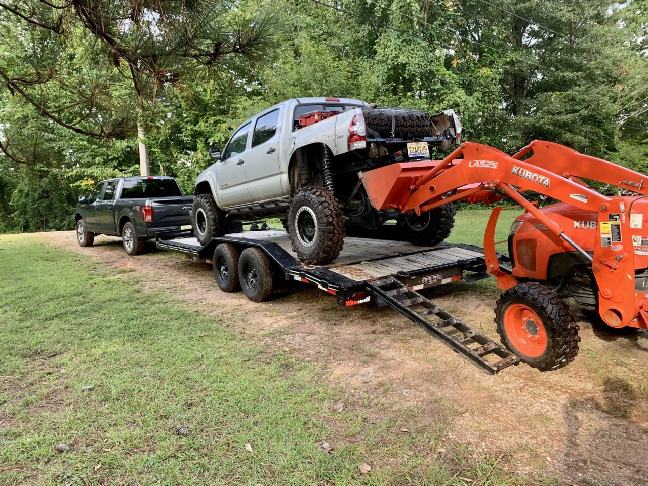

    When you need to adjust preload, but are too lazy to break everything back down…

    It’s been invaluable here. I use it for everything but farming haha
