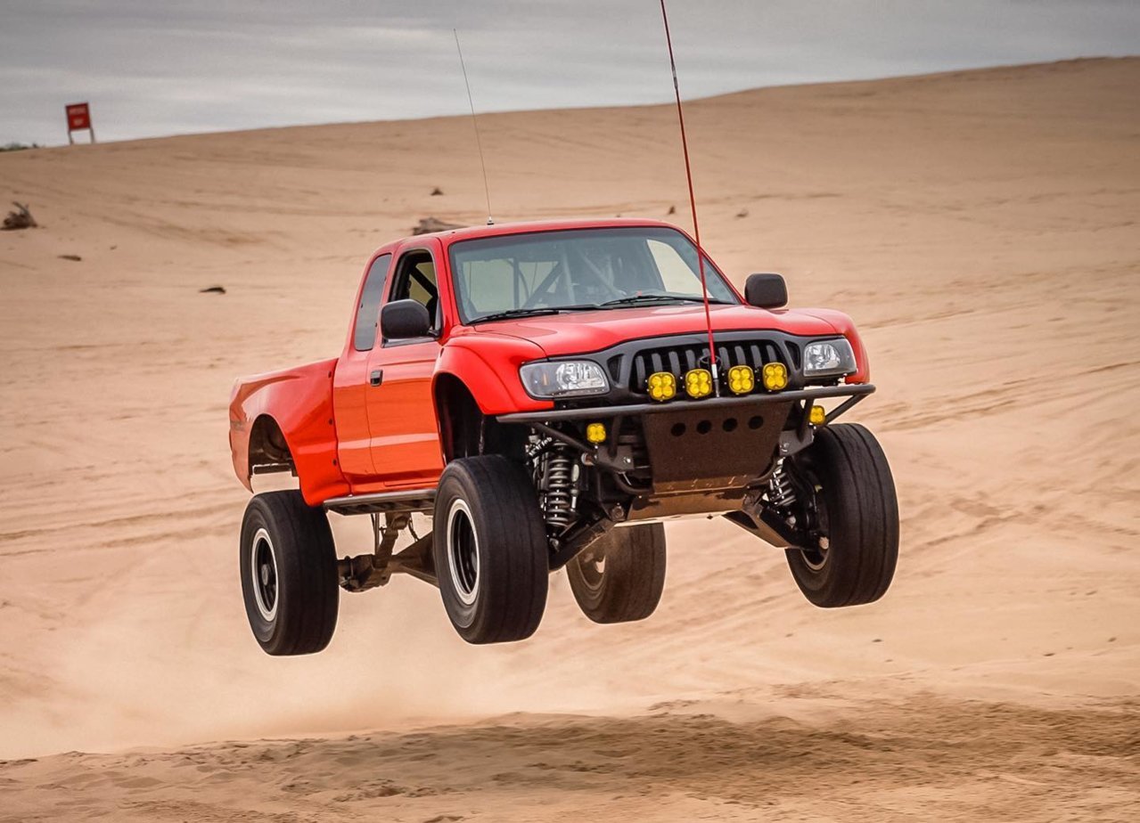

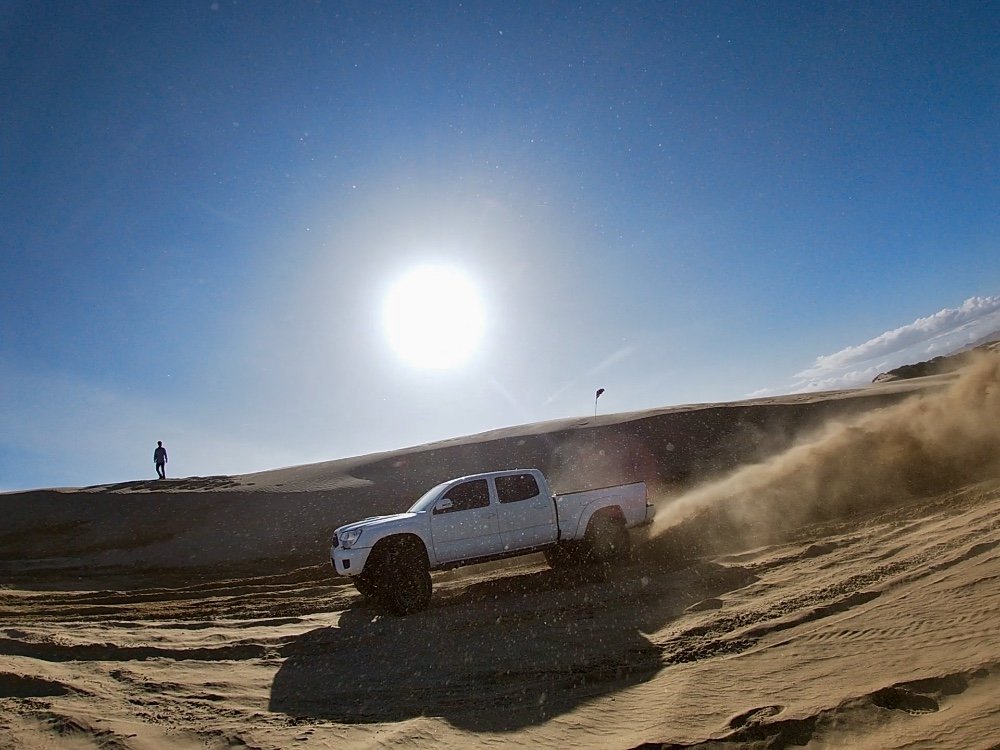

    I have lots of sending pics and videos but nobody here probably cares about our sandbox. haha285280859_556454066026872_7553558814772943562_n.jpg 274032011_4978090068922408_4050011578537050813_n.jpg

    Let’s see some videos!

    I’d love to go play in that sandbox someday!

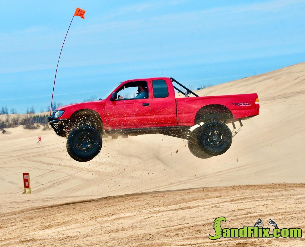

    The problem with Silver Lake is that it is small. That generally why there is so much jumping because its pretty much like going to a track. SO once you have it down you want to just hit some sweet jumps. Plus it easy to loop back around and hit it again.
