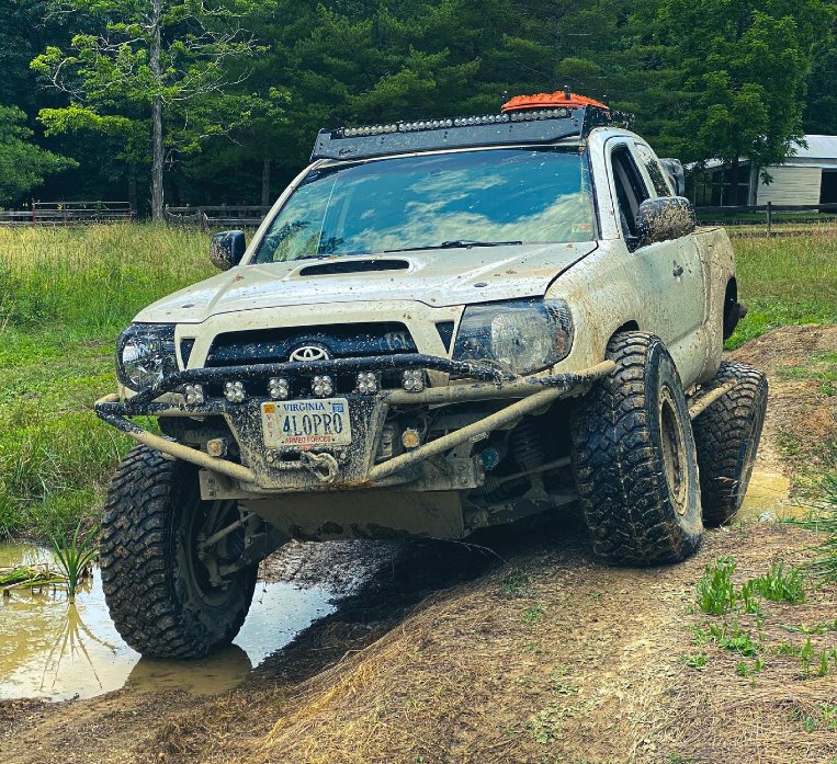

    OH. Man it can be hard to interpret text sometimes over a screen. Another one of my faves from my LT install shakedown.
    Another video that I find to be pretty sexy.
    https://www.instagram.com/p/CYhmMTuJCKW/
    JDSmith, KanPanic, Slashaar and 2 others like this.

    It's honestly impressive how little body movement you get...I really should look at lightening the front of the truck.
