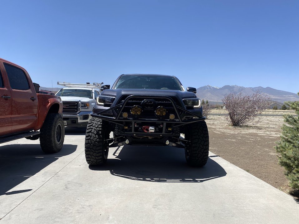

    This is 18x600 springs, absolutely no pre load. Couldn't get it lower.
    Not the best pic, but shows how high the front was sitting.

    Versus 16x650 springs. Again, no preload. However ended up sitting perfect.

    Front bumper, with winch and lights weighted 140lbs, then add about another 30 for the extra down bars we welded and the skid plate.

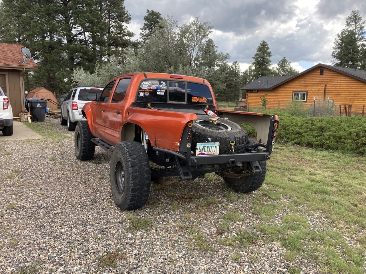

    Truck used to work good. Fighting getting it well balanced again. Although with the local area closed most of the year I’m starting to think the terrain got way bigger and more gnarly than before I broke the truck earlier this year. Finally all back together with full weight and had a test drive yesterday.
    Wish I had something inbetween the gnarly cinders and smooth forest roads to test on. Might need to make a trip to the dunes this year for some tuning.
    Also gonna be out at KOH all week next year since my buddy is planning on racing 4400 in the rookie class.
    And digging the dovetail. Think it’s gonna really help in the rocks.

    Did you find yourself getting hung up a lot back there with the full width bed before?
  7. Aug 29, 2022 at 8:28 PM
    snowsk8air2
    snowsk8air2 how hard can it be?
    Sep 16, 2011
    #63607
    10,539
    Flagstaff, AZ
    Supercharged TX Pro
    2011 S/C and basic mods
    More close calls than anything. Hence the scratches on the rear of the driver side. Departure angle and break over angle have been bigger issues when crawling. Break over angle is real hard to fix on a taco and departure angle wasn’t gonna be worth the effort to get a significant gain from. Raising the frame, no real rear bumper will hopefully help with that. The dovetail was an easy way to help keep bodywork away from the rocks at least a little bit
