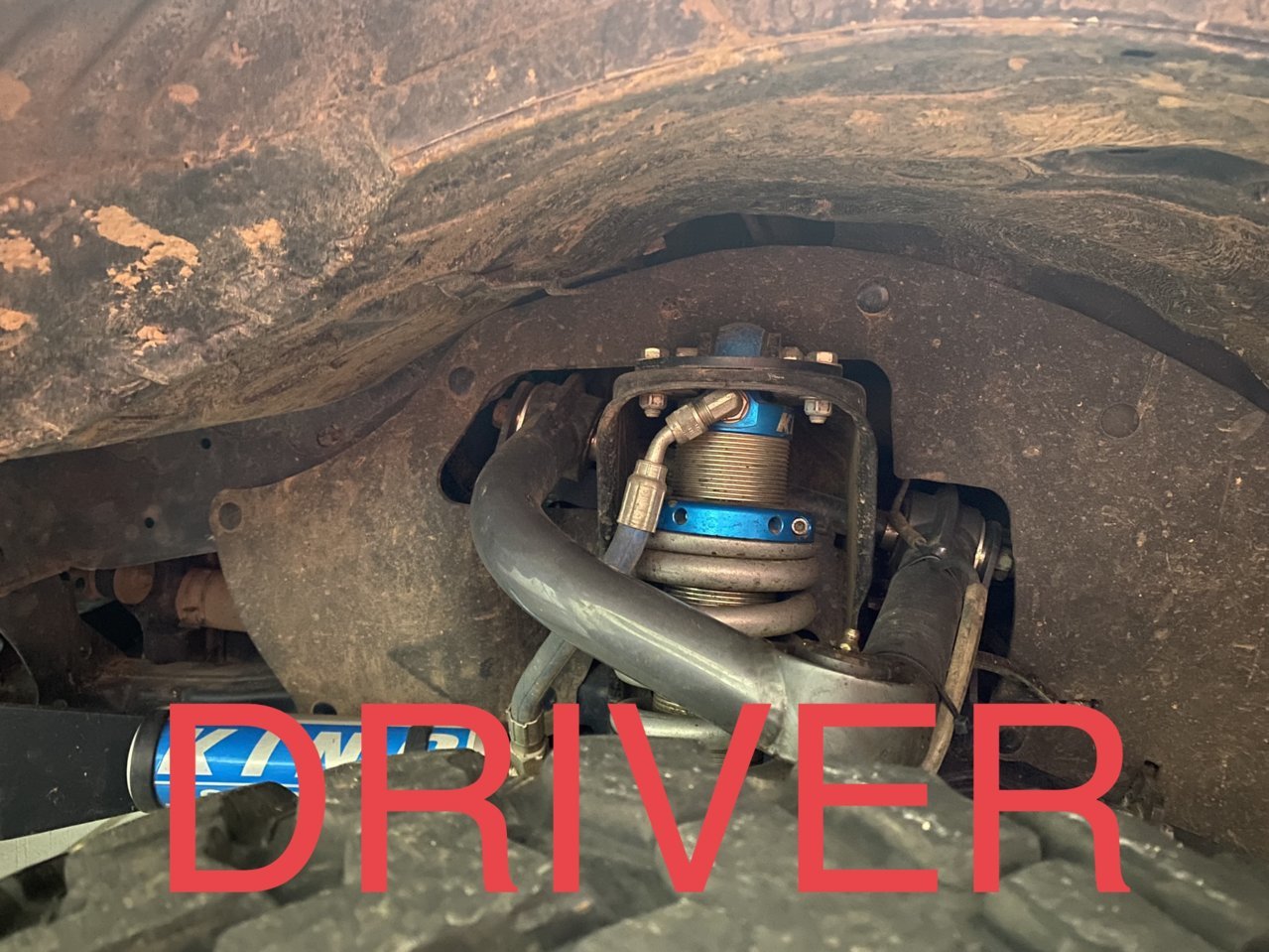

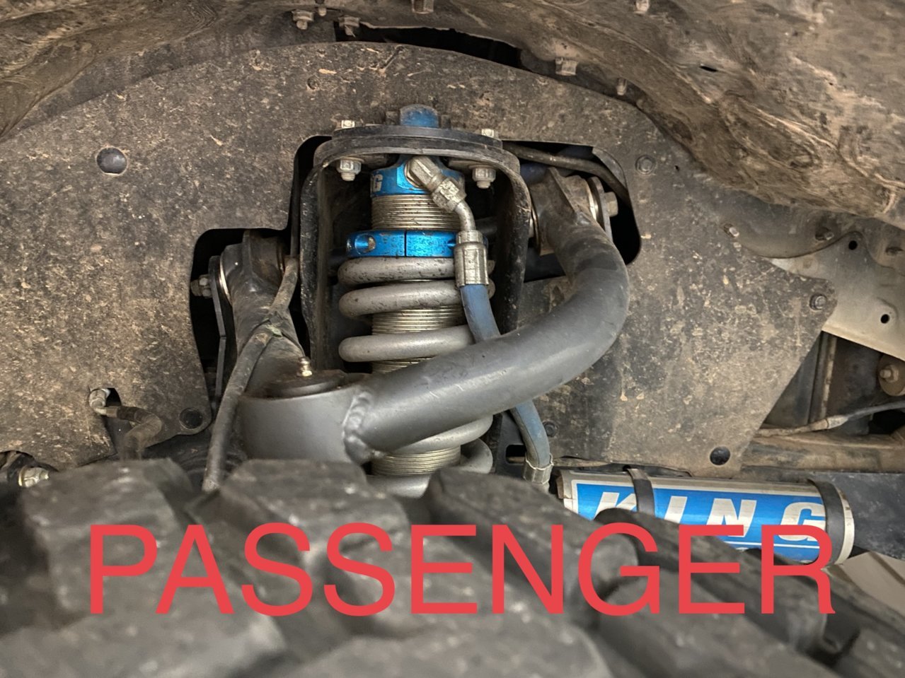

    Yeah
    They are light and they’re probably under more preload than is “acceptable” per the article Travis shared yesterday but for rock crawling they seem to work well.
    64002E96-11C8-47AA-8445-8A9F628F44F7.jpg 0F762866-3690-4C94-A6DD-5B6031DA9B3C.jpg

  11. Aug 30, 2022 at 9:58 AM
    erok81
    erok81 Well-Known Member
    Aug 15, 2016
    #194699
    5,708
    Imposter
    Thanks for those pics. That’s exactly what I needed. I’m pretty sure 500 will be too light for mine. More skids and third gen. 600 would do it I think.
