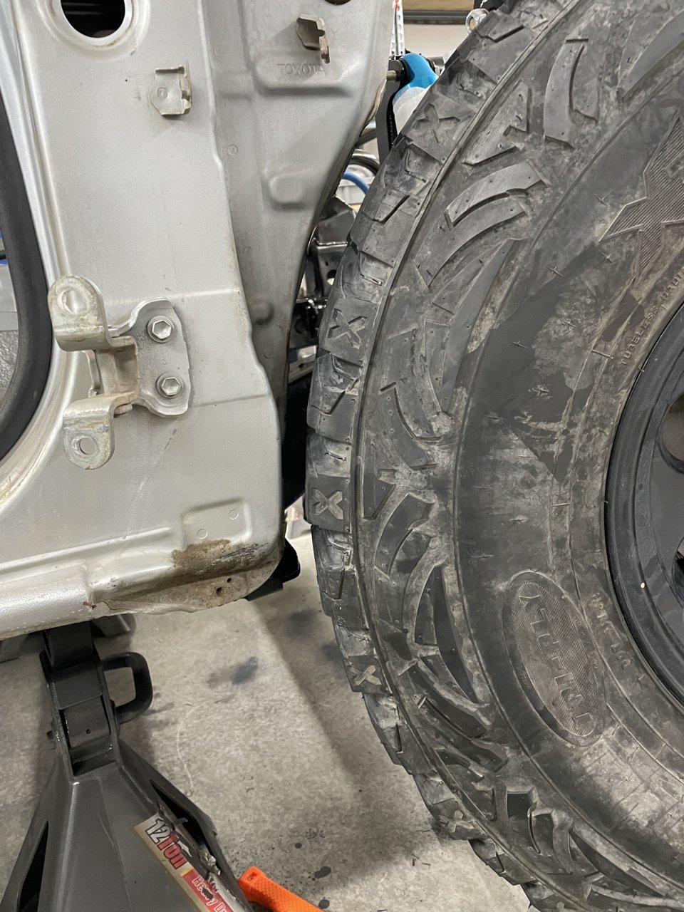

    I got em on a deal so I couldn't pass it up. Can't beat 2 miles for $400. They were only used to test the setup before they were replaced with ADS.
    Eventually I'll probably go to Fox Factory Series 2.5x14" smoothies with the DSC adjusters from Accutune since I don't make big boy money to afford a proper setup with bypasses.

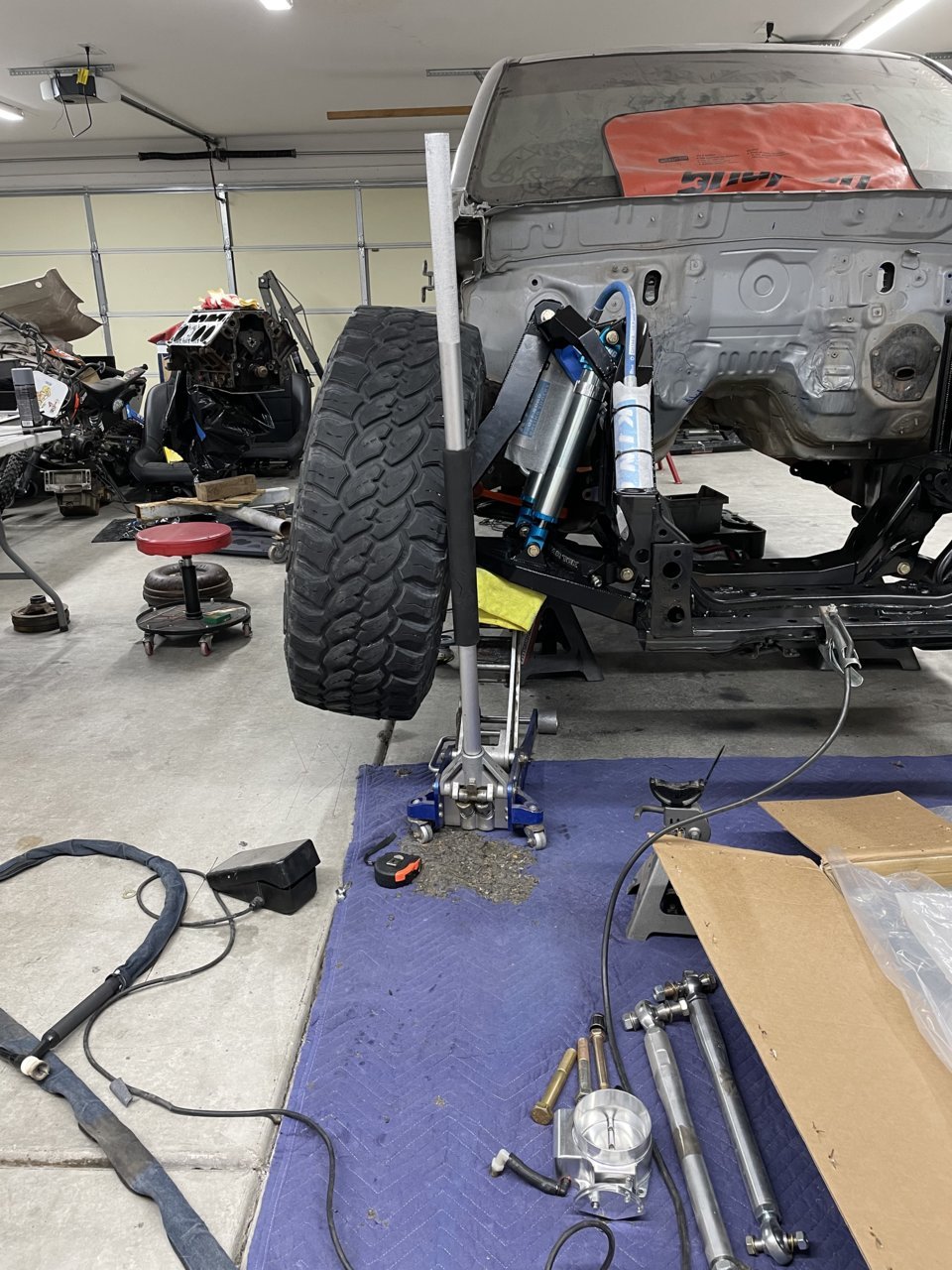

    Anyone in this thread know if a tundra rack and tie rods would be a straight swap for +2 LT kit? Considering i have double shear outer and had custom length tie rods made if i decided to keep tundra thread size. I know most ppl get the modified rack but most are looking for stock application length and outer tierod.

    You can't just drop a tundra rack in, you'd have some funky steering geometry.

    solo or basikbiker make tundy racks that are cut down to Tacoma width….any wider would really mess with your steering during suspension travel id think.

    Yea I know all about that haha I was just wondering if there was a difference since LT was in play vs stock width. Would be nice to have a off the shelf solution once the frame and steering shaft was modified. But I’ll probably go that route.

    Imagine a line from your inner lower control arm pivots to the inner upper control arm pivots. In theory the inner pivot of your tie rods should fall within this imaginary line. Moving them outside or inside of the line by too much will cause the wheel to turn under compression or extension, this is called bump steer.

    I believe the only LT kit that is designed around an aftermarket steering system would be the marlin kit. Everything else is based on tacoma geometry. Most LT kits are very similar, inner joints will be the major difference and then lower arm design and shock packaging.

    In theory yes, in practice this is far from correct.
    I suggest looking up an IFS calculator and playing around with it, its pretty interesting.

    JD slide rack is NOT factory geometry. Their setup allows you to push your tires up to 1.875” forward.

    Im pretty sure most LT kits move the wheels forward. Atleast thats what ive been told. And we were mostly talking about steering solutions. The JD kit is based around factory geometry, it uses a factory spindle and inner pivot points and thats why thier slide rack isnt necessary to run thier kit. They did play with ackerman by moving the inner tie rod forward with thier steering solution. Which needed to be corrected by moving the outer pivot forward. But again, they used a factory spindle during this process. I also dont consider the subframe or slide rack part of thier LT kit, they are sold separately and can be run independent of each other. The marlin kit is not like that, you need the land cruiser rack or your shit will be fucked up. You can only change the factory geometry so much when your using factory pivot locations and spindles without having negative effects of on road or offroad performance.

    you can do that because of how they have the lower arm spacers setup.....steering stuff stays in the same spot. and in real world application the ackerman changes that happen arnt all that noticable.
