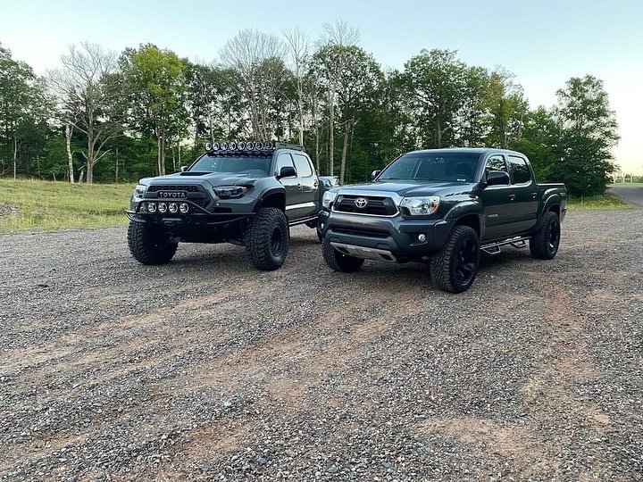

  17. Sep 12, 2022 at 3:50 AM
    906taco
    906taco Well-Known Member
    Jun 22, 2021
    #369289
    3,908
    Cory
    08 Taco
    What front kit are you on? I’m on 18x600’s and it technically has the truck at zero suspension lift and my front end is pretty light. That’s mine on 37’s sitting next to a stock truck on 31.5’s.
    BMiller421, T.Barn and IvanhoeTaco like this.

  19. Sep 12, 2022 at 9:00 AM
    erok81
    erok81 Well-Known Member
    Aug 15, 2016
    #194699
    5,708
    Imposter
    Your truck looks almost exactly like mine (heavier of course). My front kit is Dirt King 3.5.
    Edit. There has to be something going on with my truck. If you have the same setup mine should be close to yours. Right now my shocks are pretty much fully extended on the ground.
