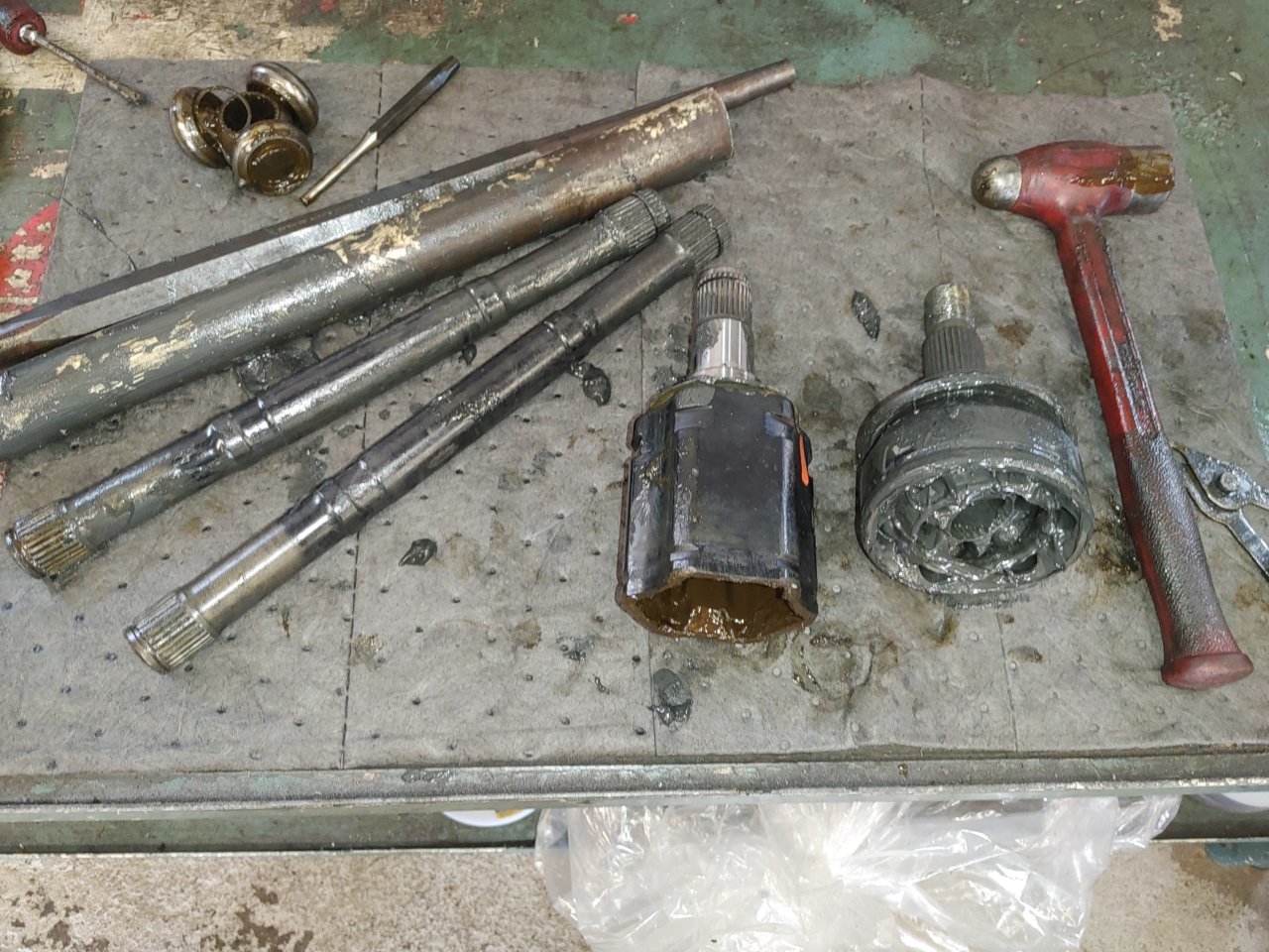

    Pipe method baby, worked on the 3rd try on asphalt.

    Every time I see someone with success using this method I get jealous. I tried so hard with no luck, same with another method and a brass hammer. Eventually I got lucky and found a pair of disassembled outers, ready to drop onto LT axles.

    You just need a friend with a lathe lol. A buddy of mine had my shafts drilled out in about 30 seconds a crack. 1" bit and as soon as it gets to the clip groove, they pop loose. Doesn't even hurt the clips.

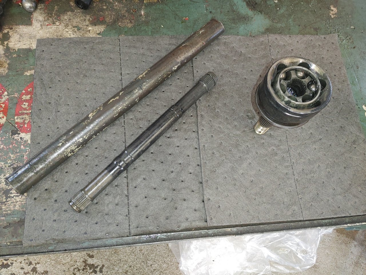

    can you show how you did? Im doing it in a couple of weeks when my axle shaft shows up.

    Get a good piece of pipe, longer than axle shaft.
    Take axle apart until all is
    left is axle and hub side joint.
    Slide tube over axle to where its touching the "sun gear" of the joint.
    While holding pipe, not cv joint, drop on a hard surface from about 2 to 3 feet straight down.
    This pipe works perfectly for this and if anyone wants to borrow it I can mail it to you. Just give me 10$ for shipping

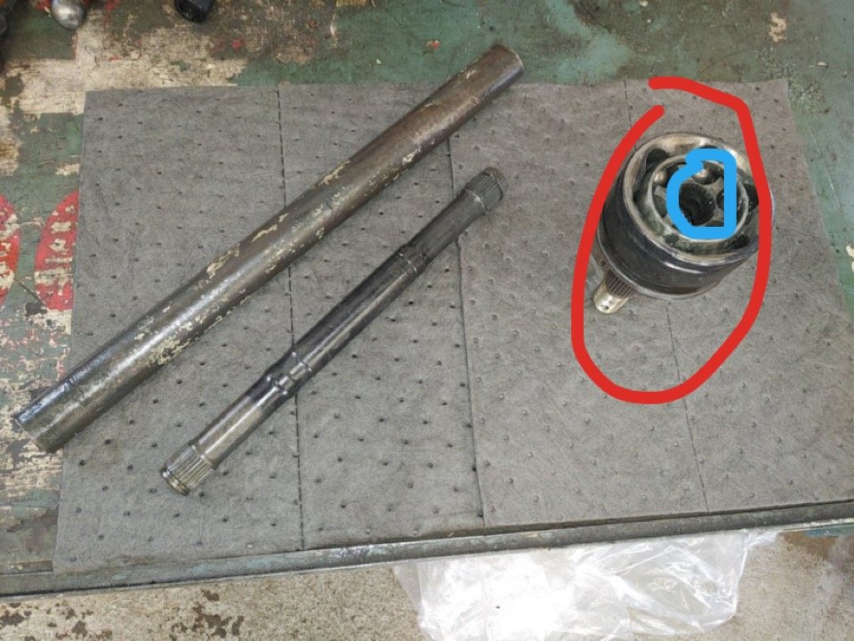

    "left is axle and hub side joint." Red circle?
    “Slide tube over axle to where its touching the "sun gear" of the joint.” blue circle?

    Correct
