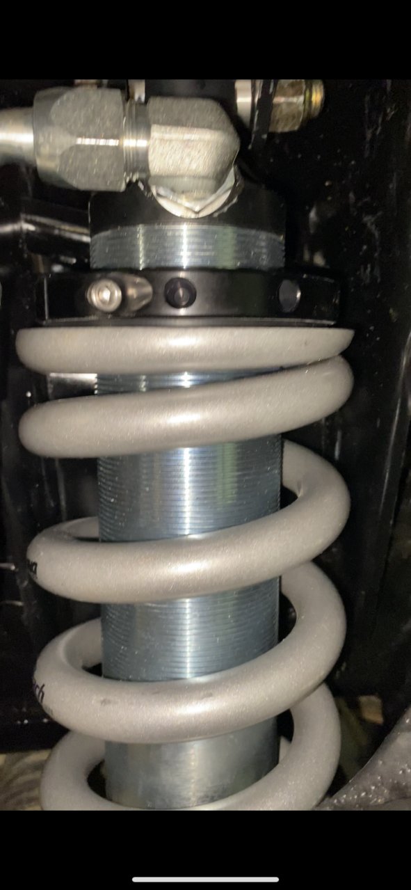

    Maybe that’s my issue.
    My coil overs are 8" Travel w/ Over Cap Option
    from downsouth the PN is King DSMPR2508-COHR-O.
    Mine look like this.

    Yeah whats up with that big upper cap?
    That might be a bit of your issue?

    Ah good point. I was only comparing the bottom mounting point. That’s what came with my “dirt king spec” coil overs.

    you have a big cap and a big lower end. That is 1,000% your issue.

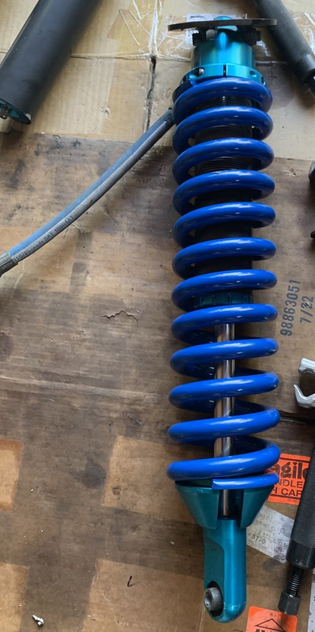

    that cap is def the problem, I have DK spec foxes and they def dont have that cap. Did you add that on? Mine looked like this out of the box. Yours has been threaded down. Remover that cap and reduce preload.

    Nope. That’s how I got them. I didn’t buy from Dirt King though. I got them through DSM as DK spec.

    not sure then but of your lift height is too high i would reduce spring rate since you cant get any lower. Mine added about 1/2 from 600 to 650.

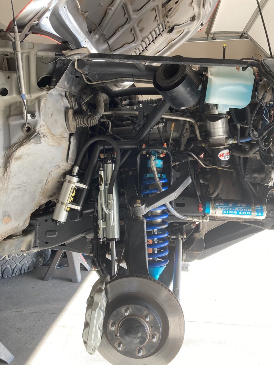

    Kinda the best current ish pic I have. And as you can see even with the 700’s I’ve still added a bit of preload to them. And the truck sits with the uniball perfectly level like this

    The DK spec for King shocks use the over threaded cap while the Fox do not. Comparing two difference companies products.

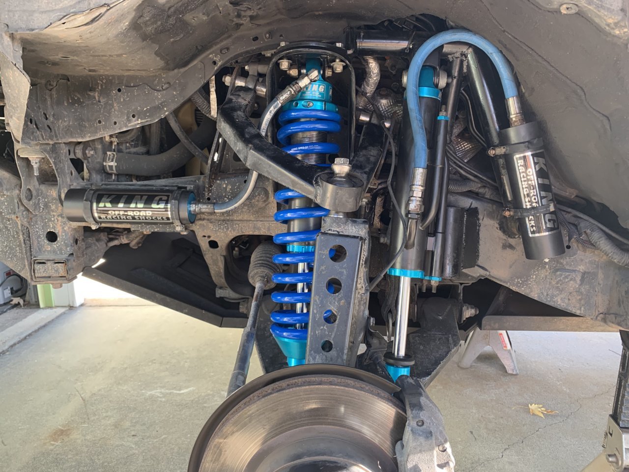

    Nice. Other than you I’ve seen nothing but how bad 700# is too much. So I convinced myself the same thing. But they clearly work since you are using them okay. With mine I had a little less preload. Here’s a pic of mine. This is with the wrong springs though and nothing fully bolted up.
    Side note. Looks like you are running the same hoops I am. Do you just use the bypass as the bump stop or do you have one it’s just hidden? I was running an air bump but I pulled it because it was so close to the arm it would be in contact half the time. Debating on putting it back and running it at a lower psi though.

    I’m running superbumps in the stock location on mine. Had to notch the bump mount a little and move the bypass mount but it’s working great.
    I don’t like the thought of not running a bump stop although I know people do it when they add a bypass. Not sure what size bump you’re running but I’d probably shorten it to 1” stroke so it’s not engaging all the time and then run it at a lower psi if it’s still too harsh.
