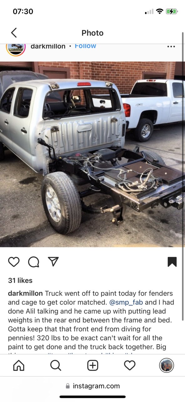

    Wow that's a lot of non functional weight. I get it, but I'd want to opt for additional fuel, tools, trail spares. I bet it helps immensely with rear handling and I suppose it doesn't' change much with conditions, but that's a lot to lug around.
    I'm in the middle of relocating two group 31 batteries to the rear under my cab (FJ). Only 200lbs left to add!

    Same, I saw that and was kinda like, "well good thing I'm lugging this RTT around then!"
