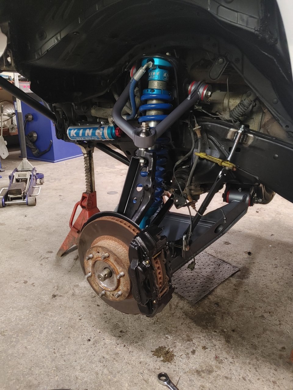

    Nice, yeah i see the little gap, thanks!

    One way is to put one side in the end of a vice, and carefully hit the rod end away from it with a dead blow. That didn’t work for me, so I just punched out the bearing with the spacers in it because I replaced it all anyways. Just 2 sockets and some force lol

    Worked perfectly. Now that i have taken it apart I understand how it works and what I need.

    Not crazy about the bump stop spacer. Upper uni touches inner fender before good squish on the factory spaced bumpstop. First LT install, lots to learn.

    Looks good! Did the kit come with a bump stop spacer? I was curious about mine limiting up travel but didn’t consider the upper uniball going through my wheel well lol. I’ve never completely cycled the front tho. But I’d reccomend that spacer if you already make contact with the wheel well and not even at full bump.

    Yep, big thick spacer installed. Theres no way my 35s are going to live comfortably at full stuff the way it is.
    I would be comfortable putting another 1/2" spacer in

    Hmm yeah that makes me think mine might hit the wheel well also lol. I should’ve cycled them when I rebuilt my kings just so i know but didn’t feel like bolting it all back up. Do you have fiberglass fenders?

    Yeah, ADV 4 inchers

    How much shaft did you have left at bump? You have the top hat spaced down as well, so you could space your bump farther, but you might reach a point of diminishing returns because of CV bind. Don't wanna rob yourself of travel.

    Hmm..well you should be fine. I have 4” McNeils and 35s and haven’t had issues. Same LT kit as you. I guess depending on how hard you abuse your truck.

    I had about 3/4 inch. It was starting to touch the rubber washer on the shaft.
    At that point of uniball touching fender to full droop I was measuring 12.5 inches. Strapped, axles could still spin, but uniball gap was too close. Strapped it tighter for uniball clearence sake.

    Mine upper uniball bolt hits the wheel well before my 37’s do.
    Well before I adjusted my bumps.
