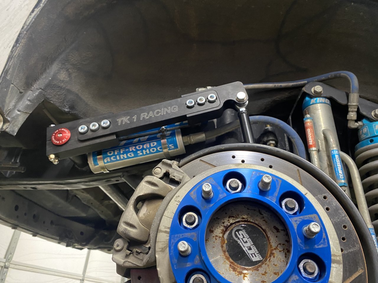

    My width was determined by frame geometry and clearance to reservoirs. I would imagine that would be the same in your case as well. I ended up with a 55” KOH bar and 16.50” arms on my FJ, although I’m looking to lengthen the arms to 18”. I haven’t gotten it back on the road yet to comment on it yet.B724E10A-AAC0-4744-A44B-E5865144B06D.jpg

    Good deal. How do you determine what height to mount everything? Like should the bar be parallel at ride height or stuffed?

    You should read through the listings on the TK1 website, preferably from a PC as the mobile site doesn’t play nice with the text. It talks about how you set up your travel, ie more droop than compression or evenly split. You definitely do not want the bars and end link’s aligning linear when fully drooped out. The linkage will bind and you will have damage. I have a lot of droop on the rear so mine are angled up at ride height to compensate.

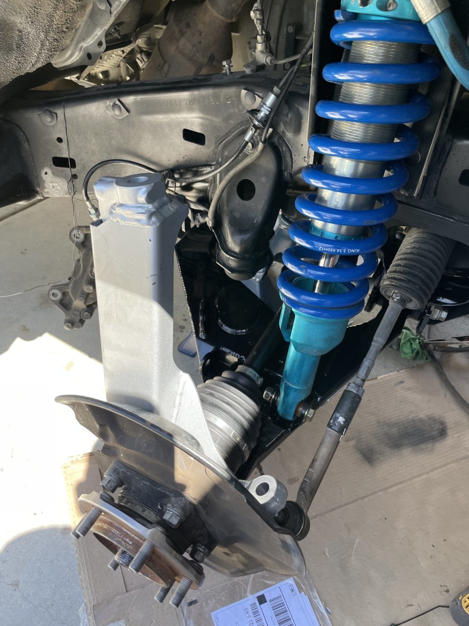

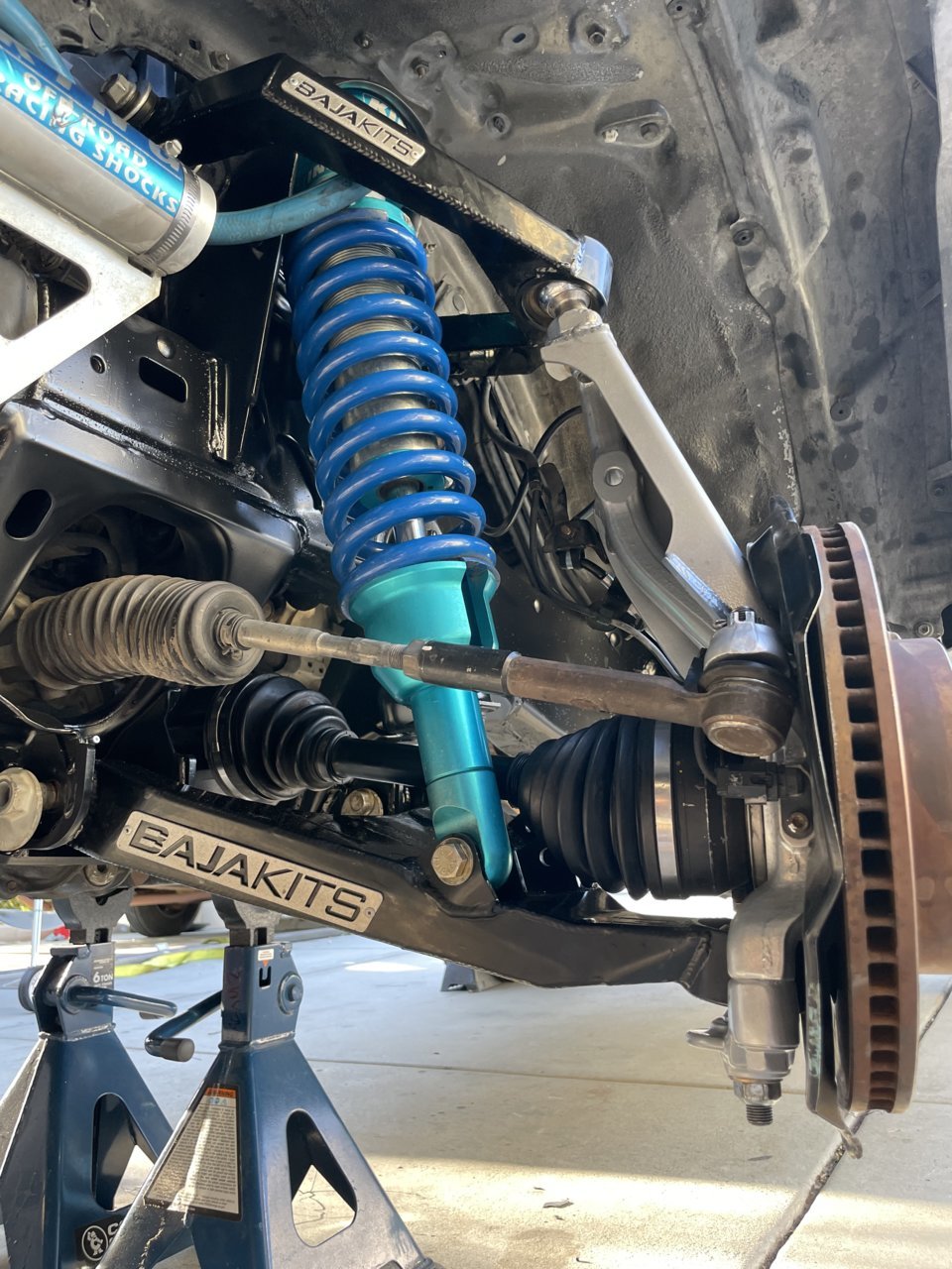

    Hey everyone, I had i question I hope it can be answered here. I’m a long time lurker but with so many pages it’s hard to keep up. I could t find an answer so I figured I’d post here. I have a 2008 fj with a Baja kits+2 kit. I’m currently on king 2.5 extended travel. I want to upgrade to 2.5x8” coilovers but everywhere I look has a long wait list. I found some off the shelf fox 2.5 8” 983‑06‑102 for a good price. I wanted to know if anyone can help me pick what lower rod end and lower coil spacer I can get away with. I was going to buy and send them out to dialed shock prep for a revalve and to switch rod ends but I’m not too sure what lengths I need. Im also buying the dirt king top shock bolt on mount. I’ll attach a few pics. Thanks
    AF0E3F14-609B-441C-83CF-878A0E5A7D8D.jpg 84D4BC3C-1E87-43C2-835A-D3EC5C9D76B7.jpg

    I’m running the DK spec fox coilovers on my +2 setup. Works very well. Very happy with the ride.

    Shock companies have had a backlog for a few years now...
    Fox are typically a little longer than King specs to begin with and that shock comes with a 2" eyelet. You will likely have clearance issues with the CVs with that shock & eyelet combo. Do you know the ideal extended & collapsed lengths that Baja Kits requires? You may also want to look further into the hose routing that you'll need. The hose on PN 983-06-102 comes straight out of the body cap and won't clear the upper arm in standard configuration.
