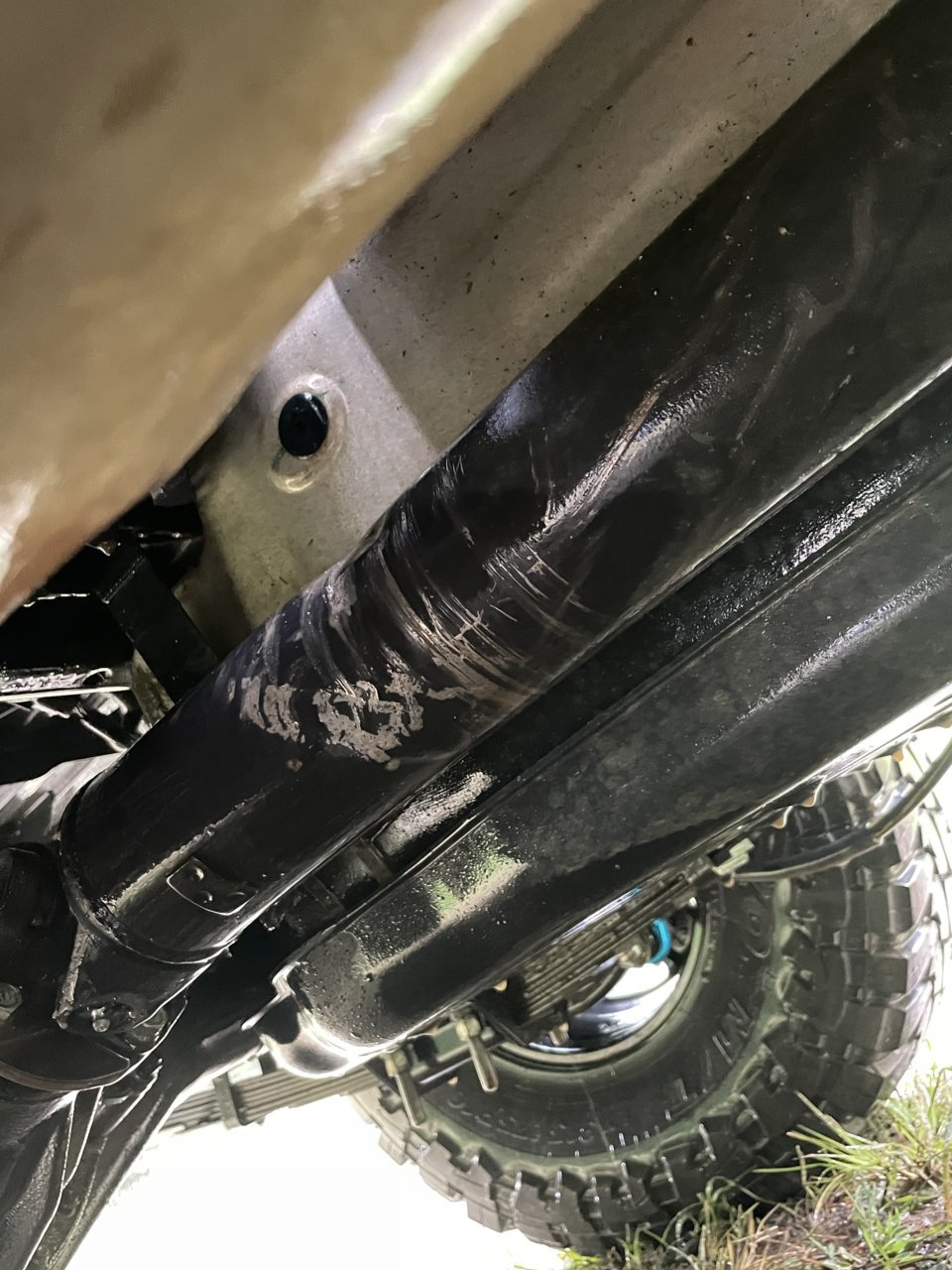

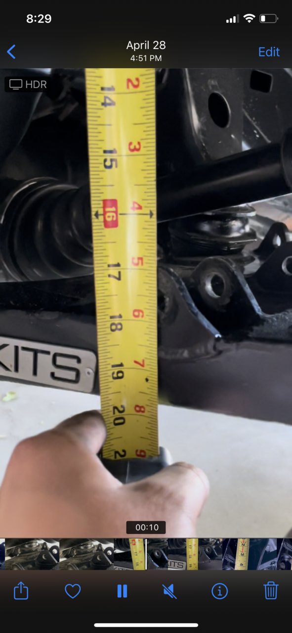

    This is what I came up with when I removed coilover and cycled Suspension. I do want to remove the oem bump stops and add a air bump in the future and hopefully gain another inch of uptravel. I’m only going 33s on tire size. For the hose I was going to have whoever was revalving my shocks add a 90 on hose and match my current hose size so I can mount it on the same resi bracket.
