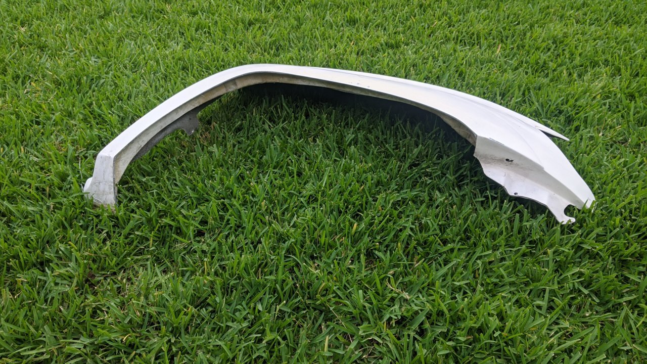

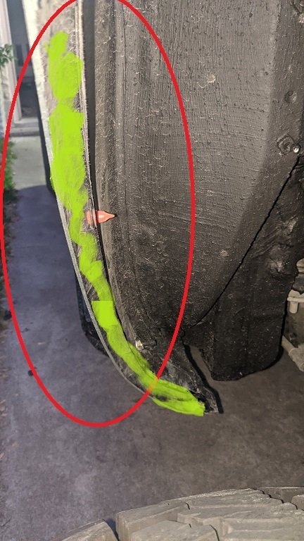

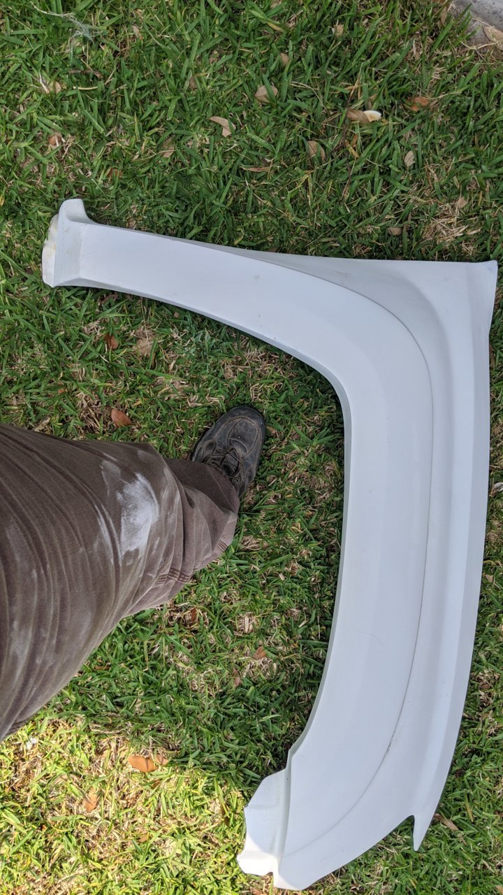

    For those of you that hacked up your fiberglass. How floppy did it get once you cut the bottom lip off?
    I have plenty of experience cutting sheet metal but never fiberglass. So I know what to expect if I was cutting metal. Fiberglass no clue.
    I got some new tires and I need to trim my fenders. I’m debating on just trimming the bottom (which would look odd) or just evenly cutting along the fender line. I’ll leave about 1/4” or so of the vertical piece but the rest of it and the horizontal piece will be gone.
    Here’s a pic of what I am talking about.

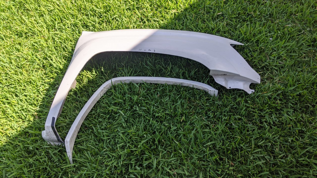

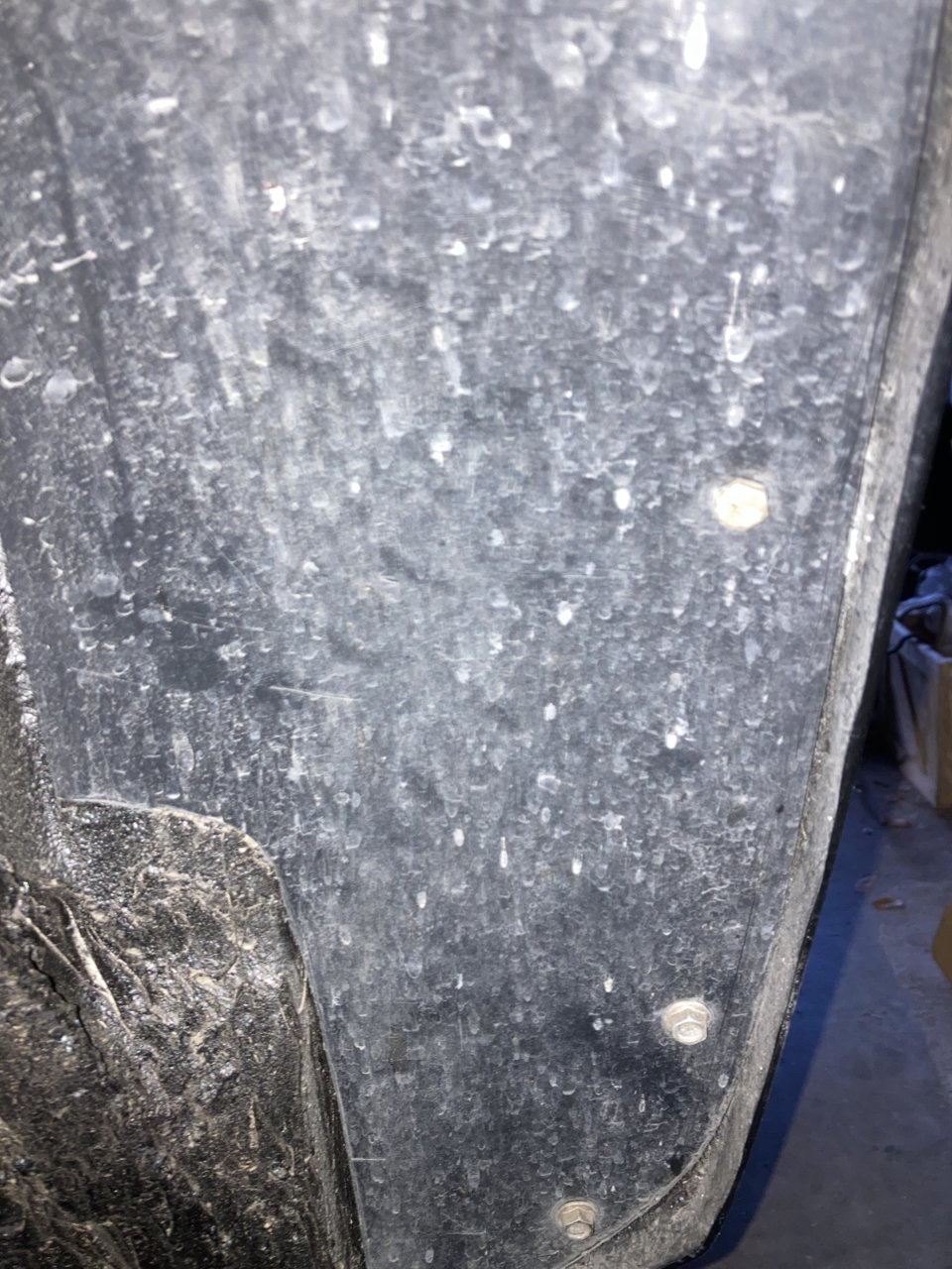

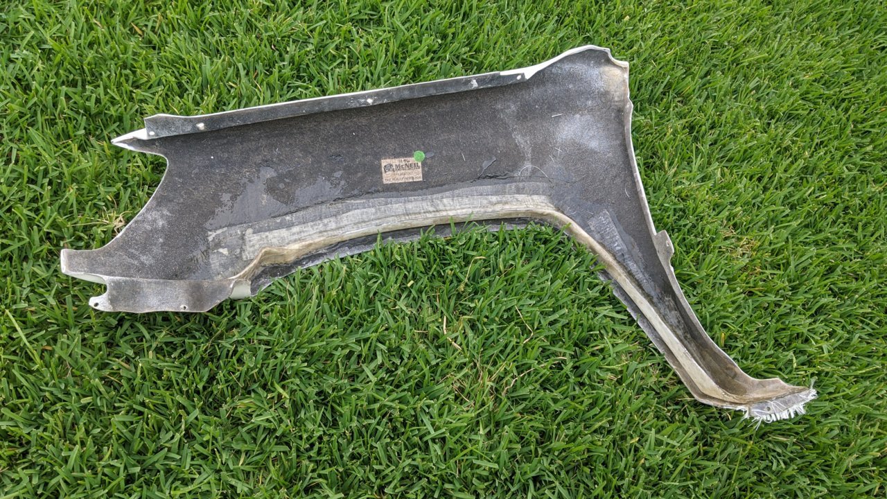

    Fiberglass the piece you cut off to the backside of the fender. You may have to cut it into sections and add material but it will be way stiffer. I did this on my McNeil's and they are like they came from the factory. You will have to test fit it as mine contacted part of the front fender cowl but cleared after some trimming. I also used this lip to mount fender liners to the fender side so I don't get a bunch of crap up in my door area... Any way some pics below
    Cut section
    re-glassed
    Finished with inner lip
    Fender well front door jamb area

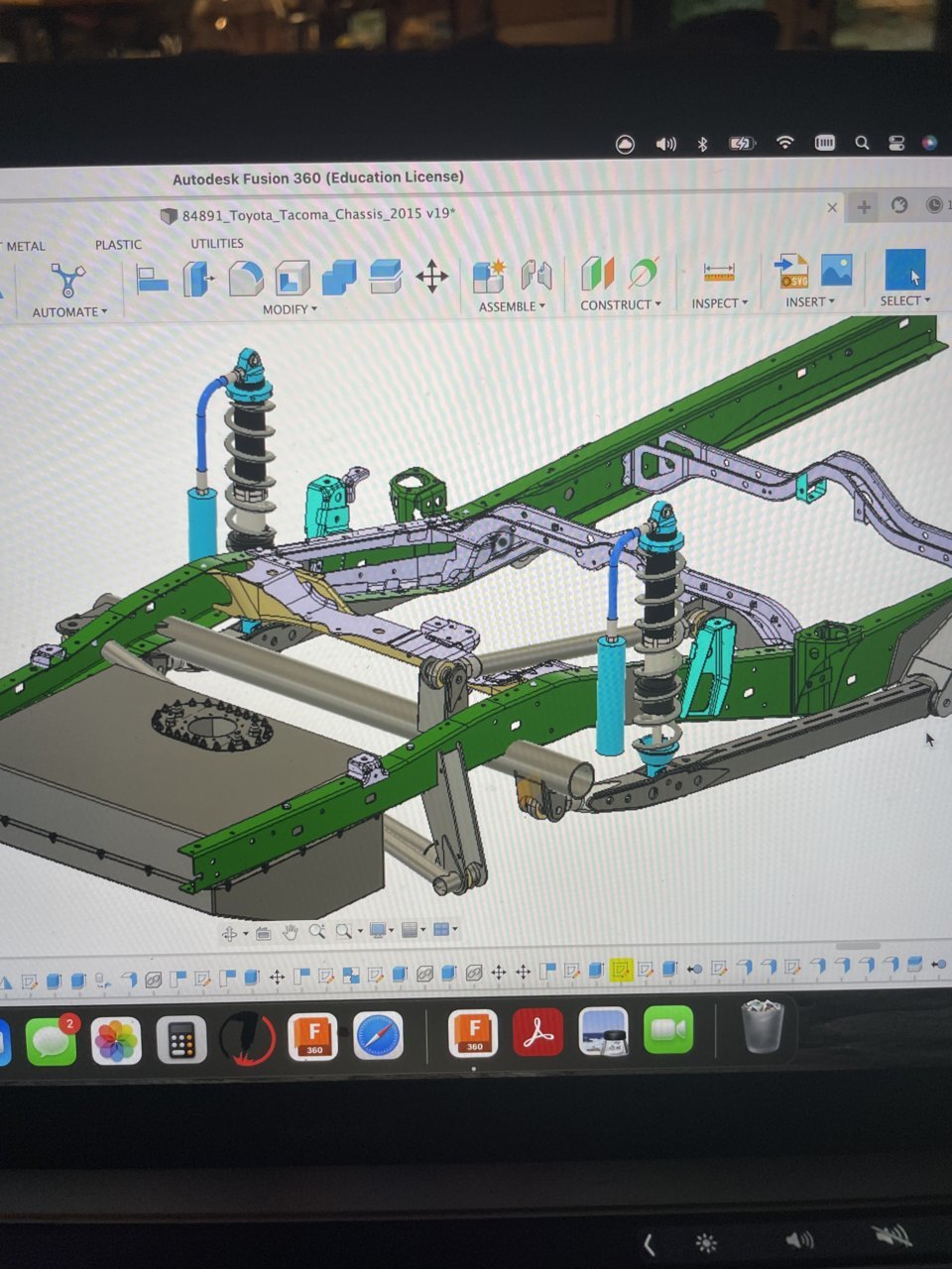

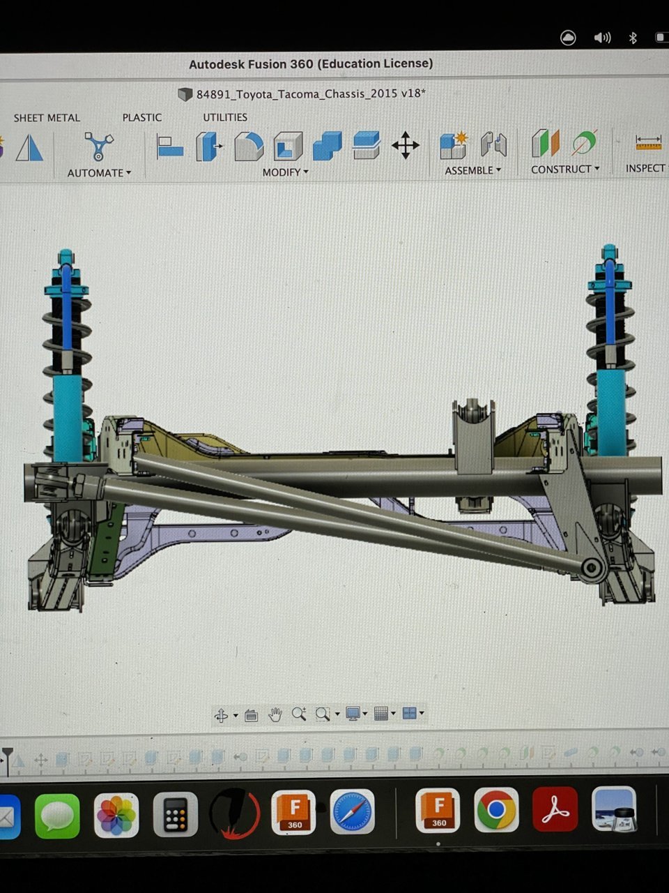

    Did you model your frame? Or is there a link to download??
    Im gonna keep going on the watts link, have plans to scan my frame sometime this winter.

    It’s a 3rd gen frame but most things are the same. I downloaded it from 3dcadbrowser.com

    That’s a good idea. Initially I was thinking if it’s too floppy I’d glue some bent aluminum strips on the back. Might try this instead.

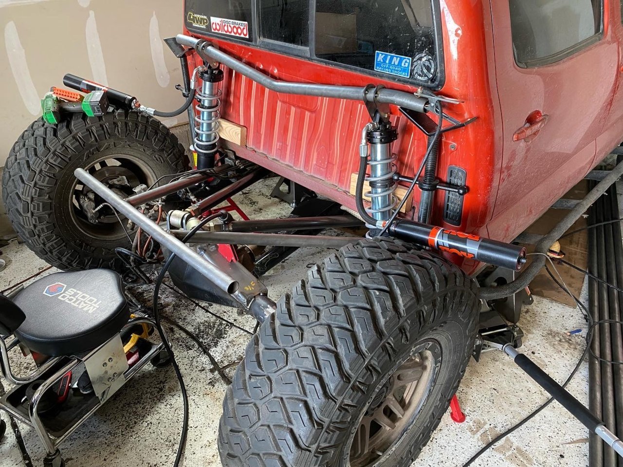

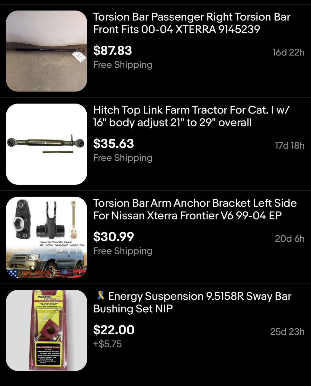

    https://www.tacomaworld.com/threads/daymans-karate-class-but-you-wont-learn-nothin-4-link-lt-and-previous-iterations.755134/
    Idea stolen from Pirate. I think it would be kind of fun to build one from scratch. Extra humor factor using tractor top links haha Need to see how long the xterra torsion bar is, but I bet this would work.
    edit: torsion bar is 34” long but can’t verify the diameter. I’m assuming it’s 7/8” like the 80’s Toyotas. This may actually work. Debating what to use for arms now. I’m going to pull the top link off my tractor and see how much articulation it has, but I’m pretty sure it won’t be an issue.

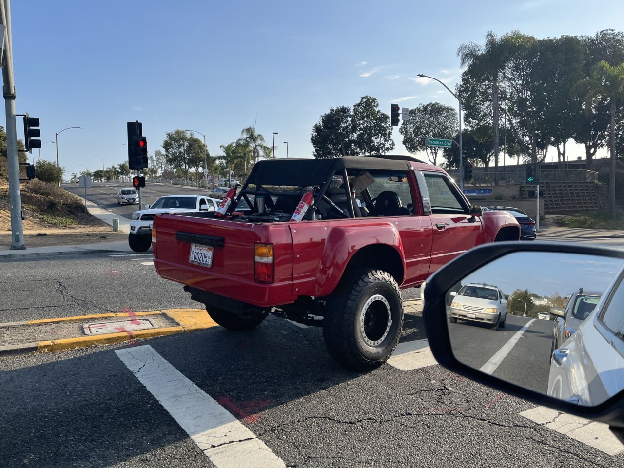

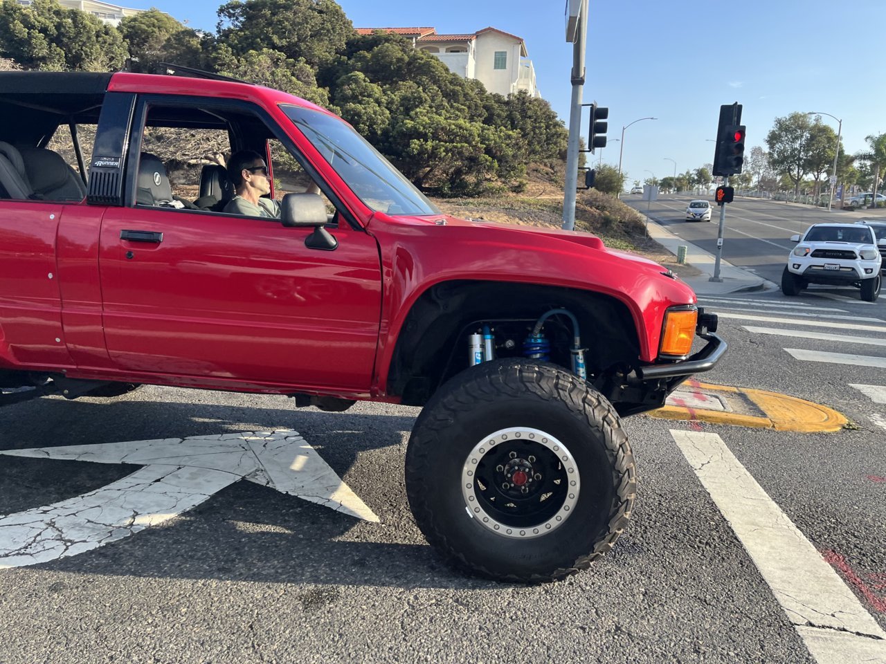

    https://www.tacomaworld.com/threads/singletrack’s-‘dad-shred-build-thread’-i’m-just-doing-it-for-the-kids.619250/ Sos offroad sliders (kickout + filler) Sos offroad full belly skids (steel) Sos offroad front recovery point Sos offroad concepts HC rear bumper with bedside kickout tubes Marlin Crawler LCA frame brace kit Trail Gear rear diff cover Bilstein 5100 + OME 885 Total Chaos UCA BILSTEIN b110 OME Dakar standard pack Wheelers Ubolt flip kit Wheelers Superbump f/r Wheelers SS extended brake lines FN five star 16x8 -25 Milestar Patagonia MT 315/75r16 Custom projector retrofit (acme super h1 + morimoto 4300k) Baja Designs S2 sport ditch pods on CBI ditch pod mounts Amazon AMAK rock lights CMC CB radio hardmount
    Not sure who this guy is (in Carlsbad CA) but wow what a truck
