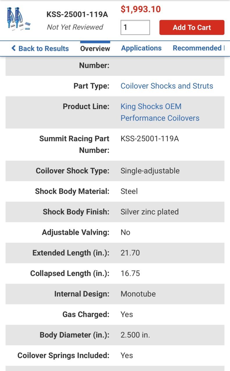

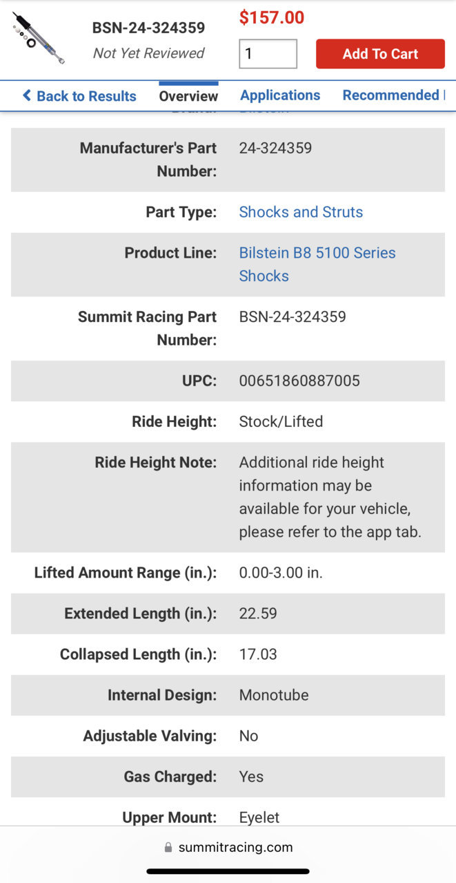

    I can’t remember where I was when I read this but it was @CGoss truck. Apparently 5100’s have more shock travel than extended coilovers or just as much? About to upgrade my wife’s 08 FJ and I think they share front shocks. Would be nice to get an economical mid travel set up on it while I’m at it.

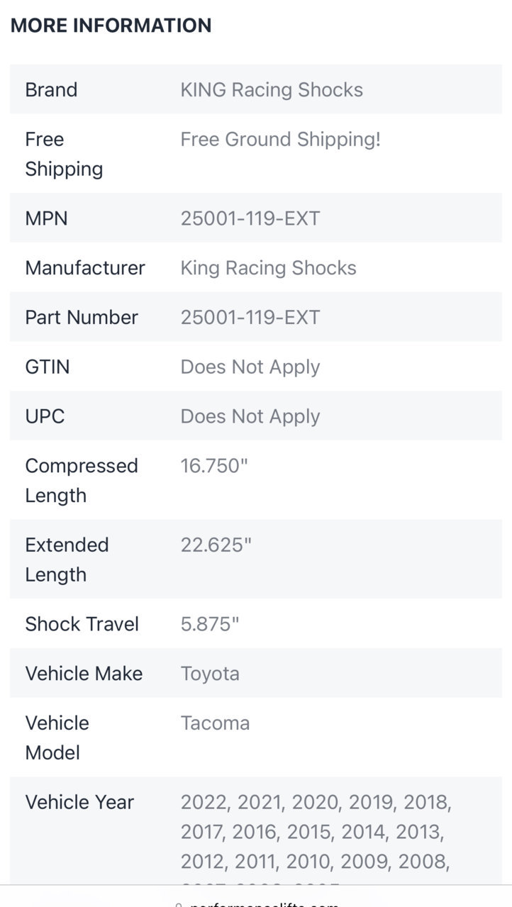

    Here’s what I’m seeing for 5100’s and King extended coilovers. 5100’s have a 5.56” stroke, extended Kings have a 5.875”. Will try to find the stroke on stock Tacoma shocks-

    Looks like reg travel king shocks have a 4.95” stroke so the 5100’s beat that at least. I’m guessing most stock replacements will have similar strokes aside from the Bilstein which appears to be able to support and extra inch of travel at the wheel. Interesting.
