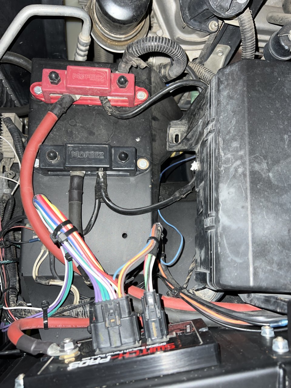

    I used these to connect factory wiring to the cable running to the back.
    https://www.amazon.com/dp/B09B2MZK5R
    I also installed this switch by my battery
    WirthCo Battery Doctor 20247 Battery Disconnect Switch –Battery Disconnect Switc https://www.amazon.com/dp/B00UPCG9ZS
    I can get some more pictures later if you want.

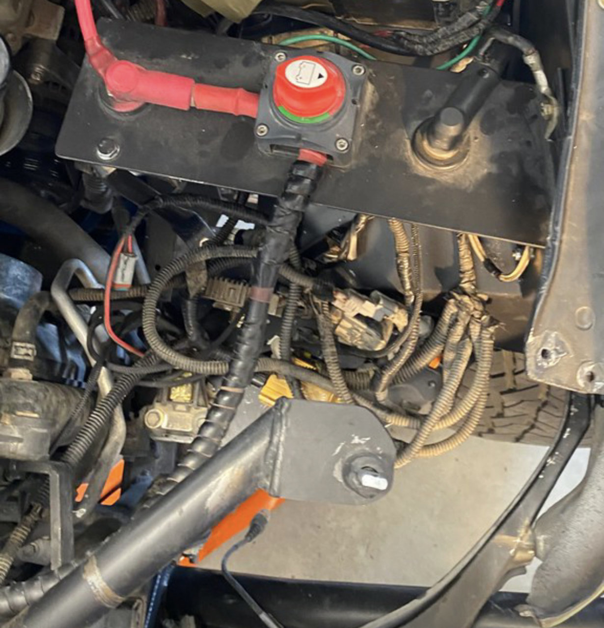

    Made a plate mounted a shut off switch and a coupe of terminal posts. Threads into the inner fenders where I put in rivnuts. There’s a standoff on the inner part to support that side. Aint pretty but does the job.

    Not bad. Looks better than what I have now with my battery. I’ve seen a few people use cut off switches there as well. What’s the reason for adding that? Just so you can switch it off under the hood?

    "Disconnect the battery" step for general maint is my guess. Easier than crawling to wherever the batter is.

    Also a safety factor especially when you have a run of large cable coming through the cab. Should technically be closer to the battery though. Under the hood with battery to the rear is sketch.

    Toss a mega fuse in between the switch and battery too. Electrical shit is so freaky if things go wrong. I’ve seen a whole lot of messed up stuff at work. I’m so paranoid about electrical fires that I have a pair of cable cutters in my center console as a shit really hit the fan defense lol.

    I disagree. You dont want to be blowing fuses everytime you use your winch. For example my warn is 400amp max draw. If your blowing that you have something seriously fucked up and should have noticed way before that.
    A good disconnect switch near the battery that is easy to access is a good option.
    Wrap your wires in extra sheathing if your worried about them rubbing a whole.
