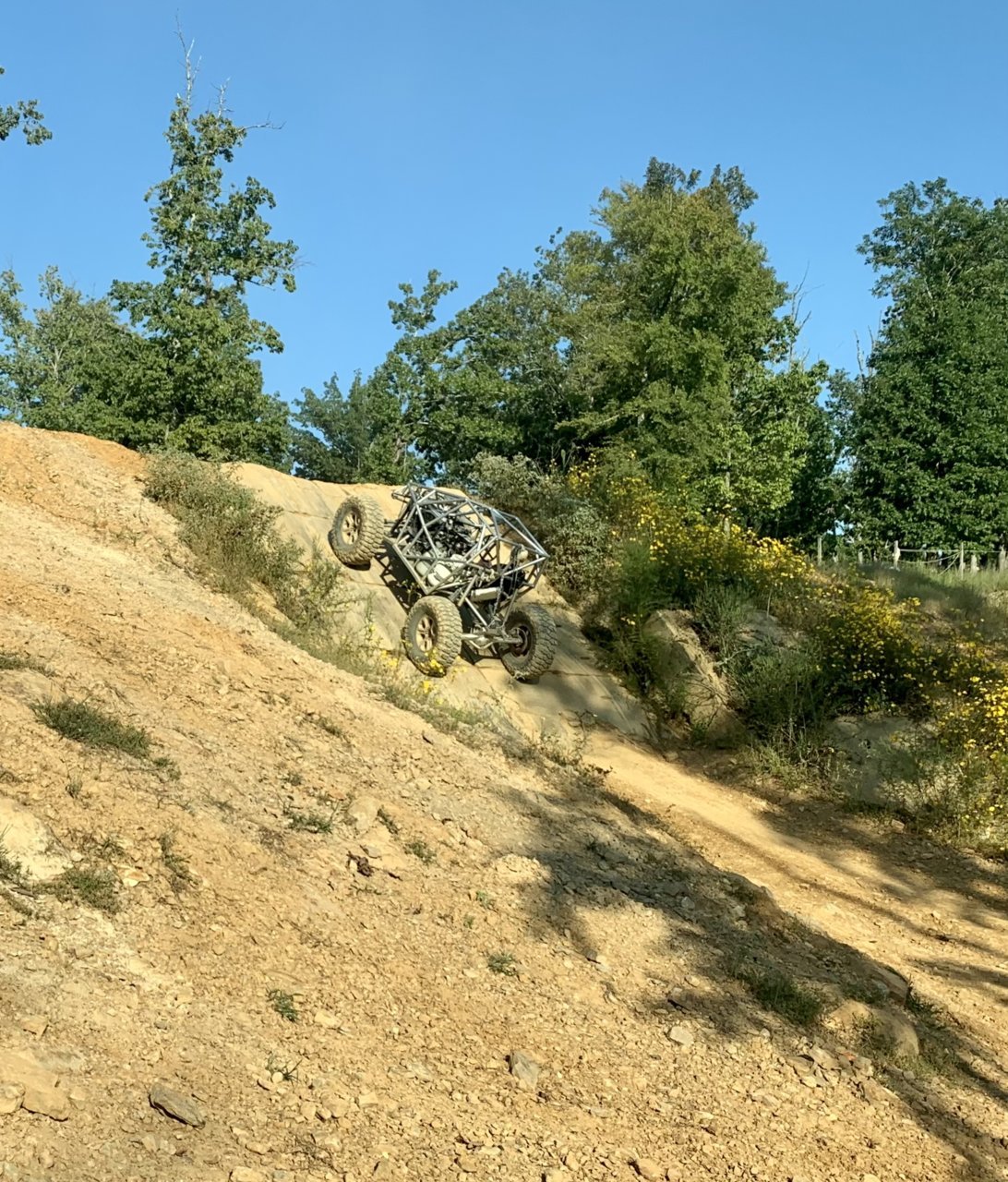

    Wanted to get some feedback before making any changes. When was trying to crawl boat ramp at Hawk Pride I noticed when I got to the steepest part my truck would roll back. Not skid, but like someone pressed in the clutch (I’m an automatic) I had plenty of traction. Someone suggested it was low on transmission fluid which makes sense with the sensation I felt. I have no idea how much to add and I’m pretty sure there’s no dipstick on this model, but I’ve never looked. I’m paranoid about overfilling it.
    Never looks as steep as it is in real life haha

    There’s a process to check, basically get it to a certain temp and remove the overflow plug and let it slow to a steady trickle. It’s not a difficult process, there are a ton of threads on it.

    A steep enough angle could certainly starve the pump. Even if its properly filled.

    I’ll take a look. If the levels are “normal” I’m curious how much I can add so this doesn’t happen. Also not sure how it would be low, unless it was low from the factory.

    Definitely a fine line for overfilling. Too much and you're going to kill a trans because of fluid aeration. Granted if its sucking air on a steep angle that's definitely not helping the cause either.

    Poo. I need to figure out how to check the level. Maybe it’s just a bit low and an extra half quart would do it. I can’t have it happen though, it was dangerous as hell.

    Going to be waiting a while per usual, but maybe this would help.
    PML Toyota A750E, A750F Deep Transmission Pan (yourcovers.com)

    That’s interesting. Would probably help keep things cooler having more fluid. I wonder if it would help at steep angles though. I don’t know jack about transmissions nor what would help get more fluid up front. Is it always pumped to the front or balanced by gravity?

    I kind of like the shape of that pan, its tapered front and rear to the center. It would likely help keep the fluid at the suction port of the filter. But I could also be wrong too.
