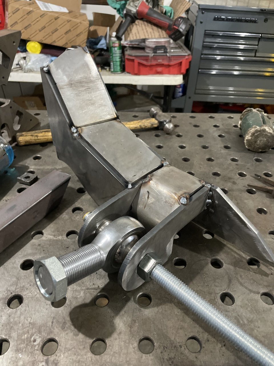

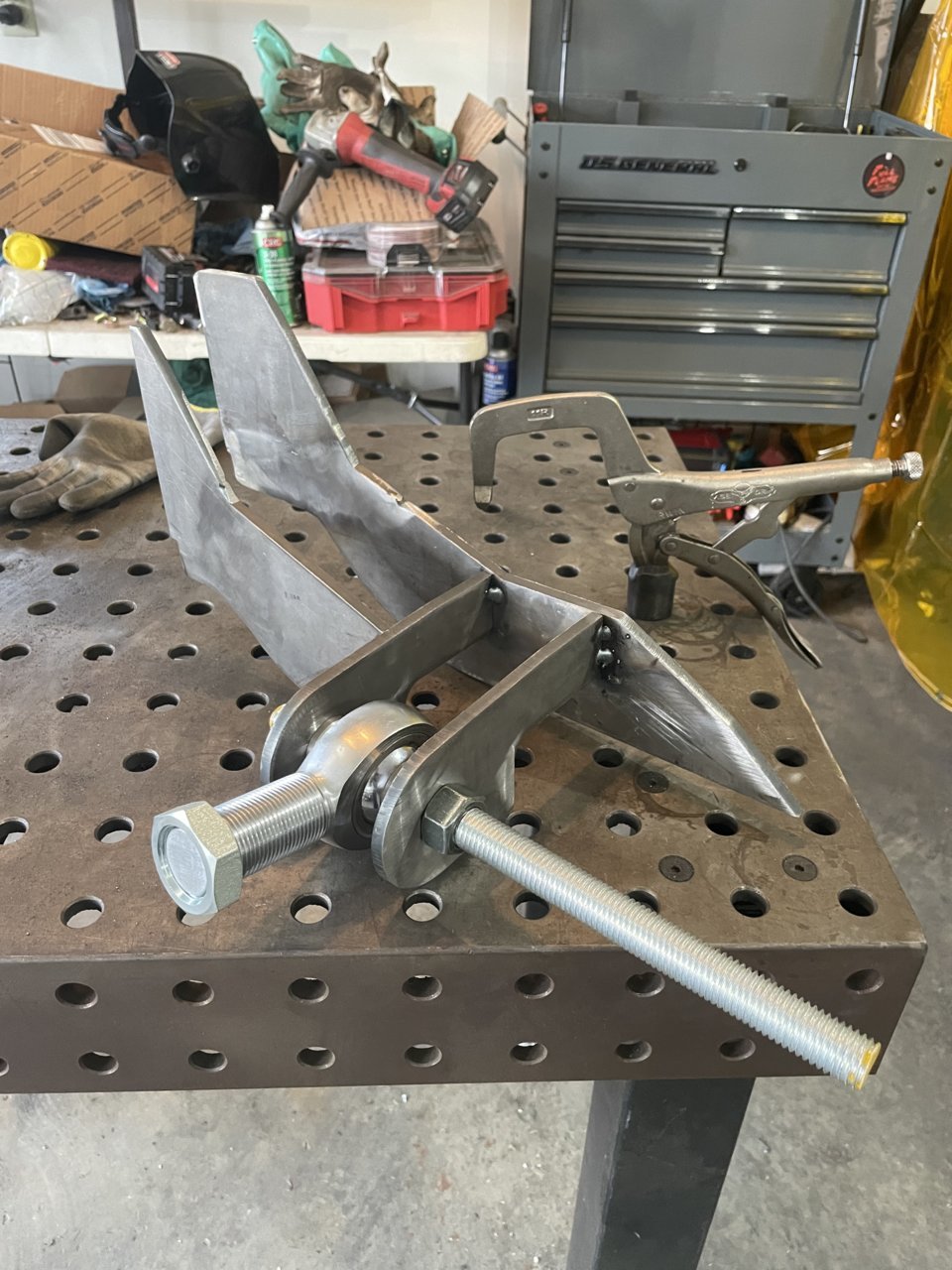

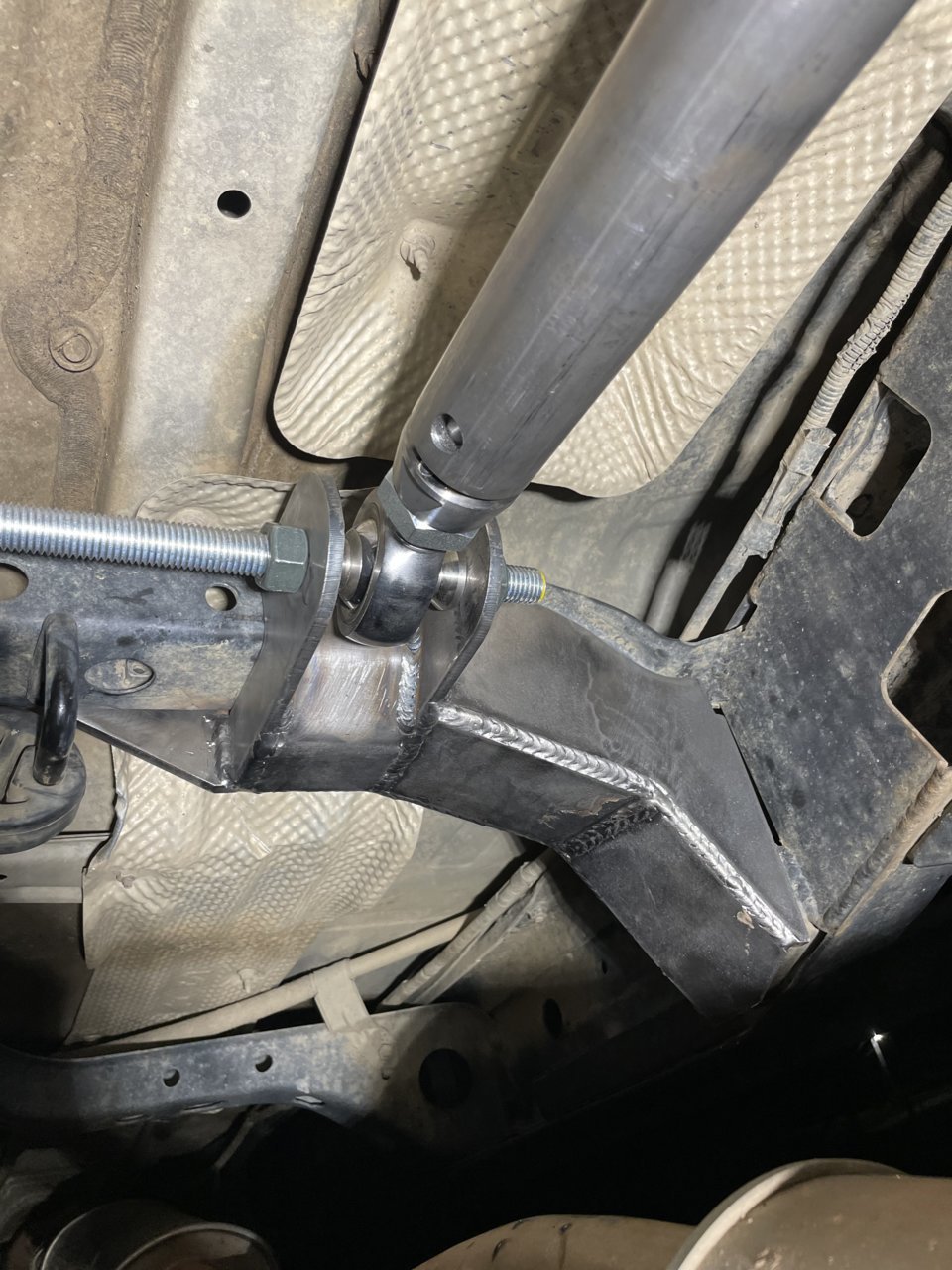

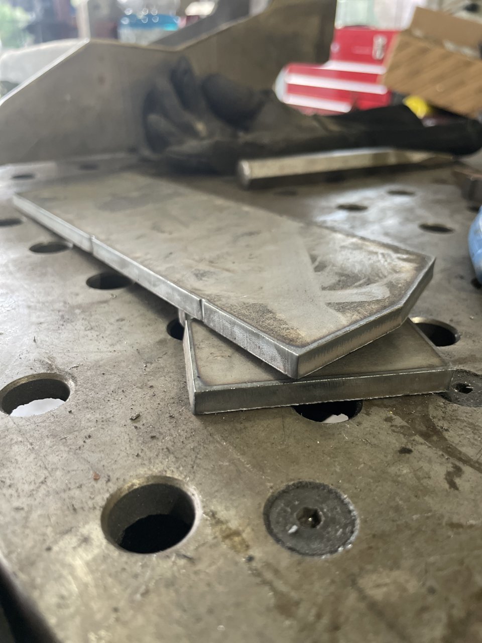

    Progress on my trailing arm 3 link. Upper link bracket is welded up, it just needs weld washers and a few more plates to tie it into the frame better, and possibly a tube on the back.it’s pretty secure, it’s all 1/4” p&o cut on my crossfire pro.

  18. Oct 12, 2022 at 5:51 PM
    EatSleepTacos
    Mar 24, 2015
    #151688
    59,840
    Randy
    West Valley, AZ
    2017 4Runner
    That’s a really well designed bracket, nice work.
  19. Oct 12, 2022 at 7:33 PM
    NcTaco27
    NcTaco27 Well-Known Member
    May 17, 2017
    #219292
    670
    Brenton
    East Tennessee
    2015 TRD off-road taco
    Lt front/rear Jd fab…
    Thanks, I took a lot of time making everything functional on the computer instead of throwing together tabs and pre made brackets. Hopefully the rest of them turn out well.

  20. Oct 13, 2022 at 5:34 AM
    906taco
    906taco Well-Known Member
    Jun 22, 2021
    #369289
    3,906
    Cory
    08 Taco
    Nice work! It may be worth while to tie in the two crossmembers somehow as well. Lots of force applied on link mounts.
