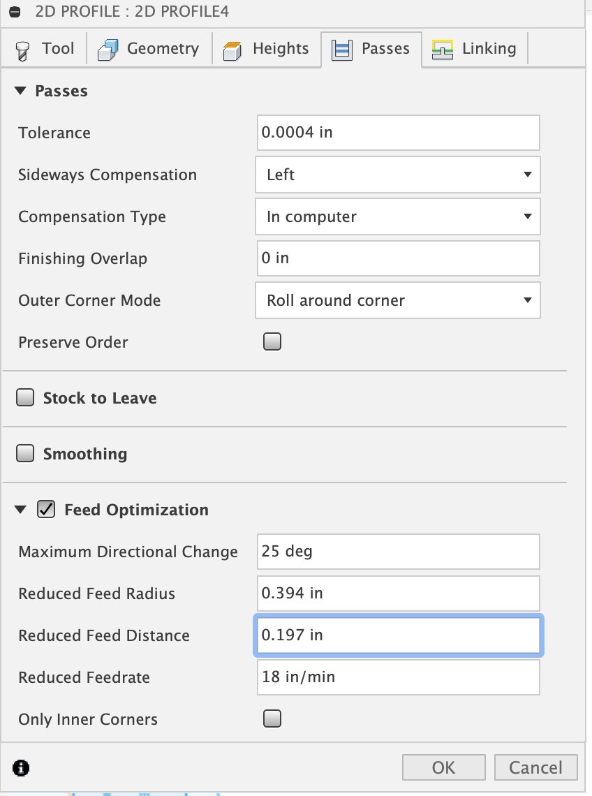

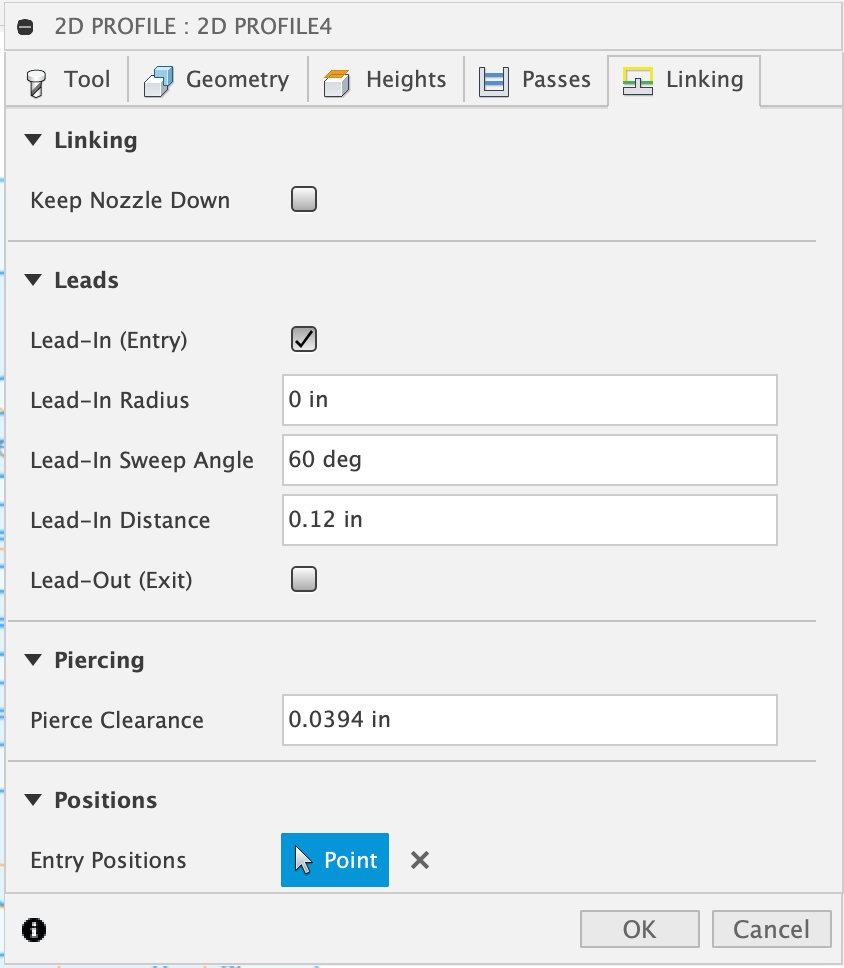

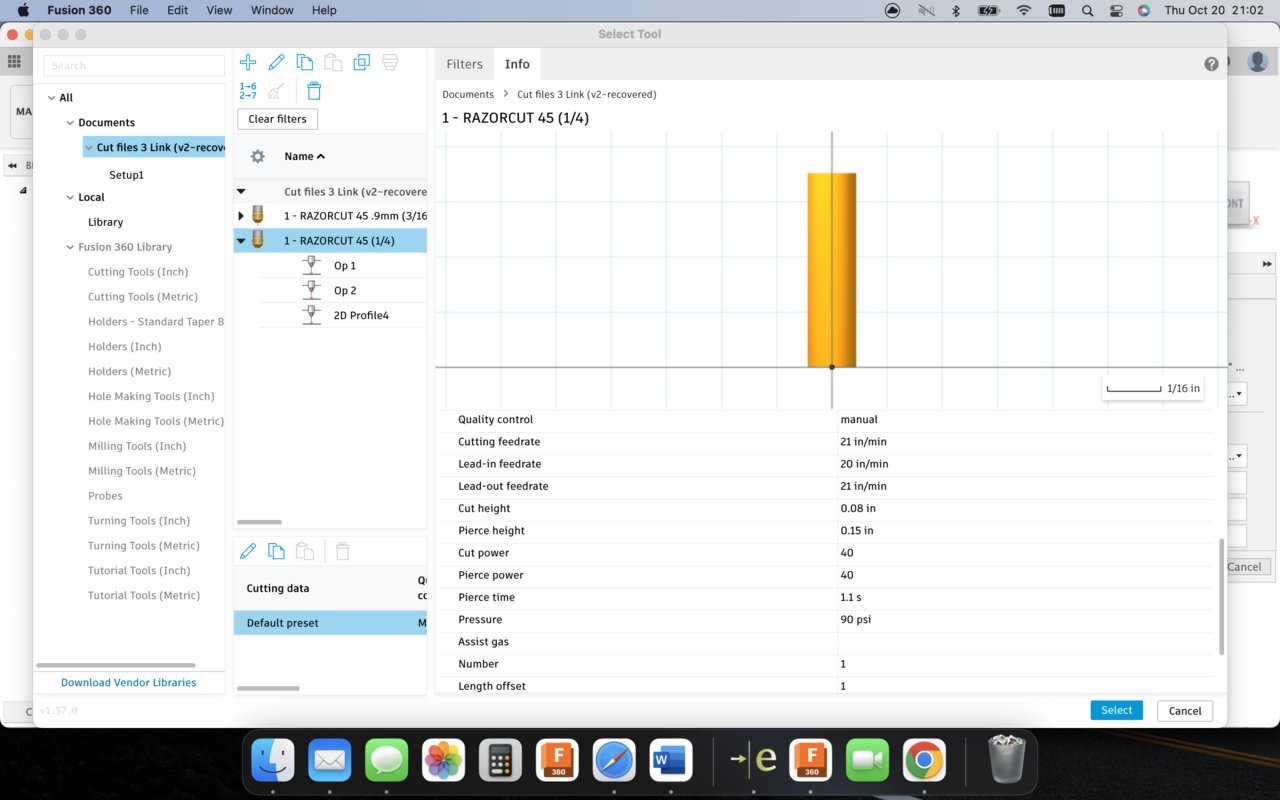

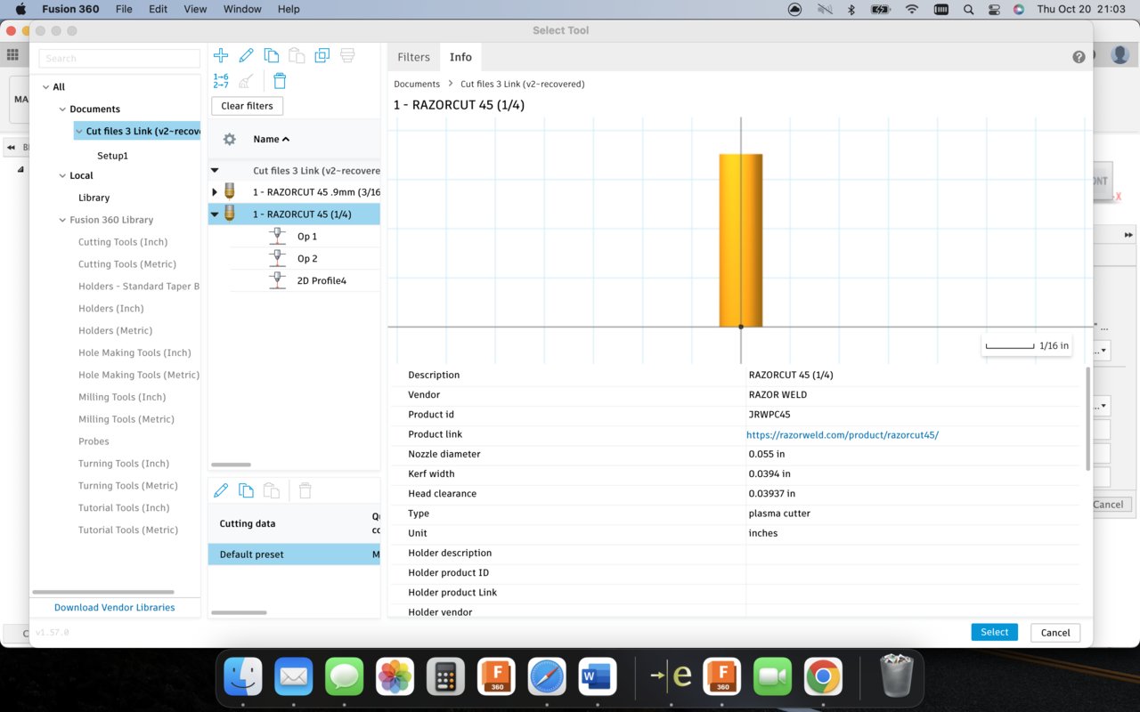

    Make sure you have the right sized tip for the material and amperage you are using. If you're using a different cutter, id lookup the best cut height.
    Screen Shot 2022-10-20 at 9.03.02 PM.jpg Screen Shot 2022-10-20 at 9.02.53 PM.jpg Screen Shot 2022-10-20 at 9.03.49 PM.jpg Screen Shot 2022-10-20 at 9.04.04 PM.jpg

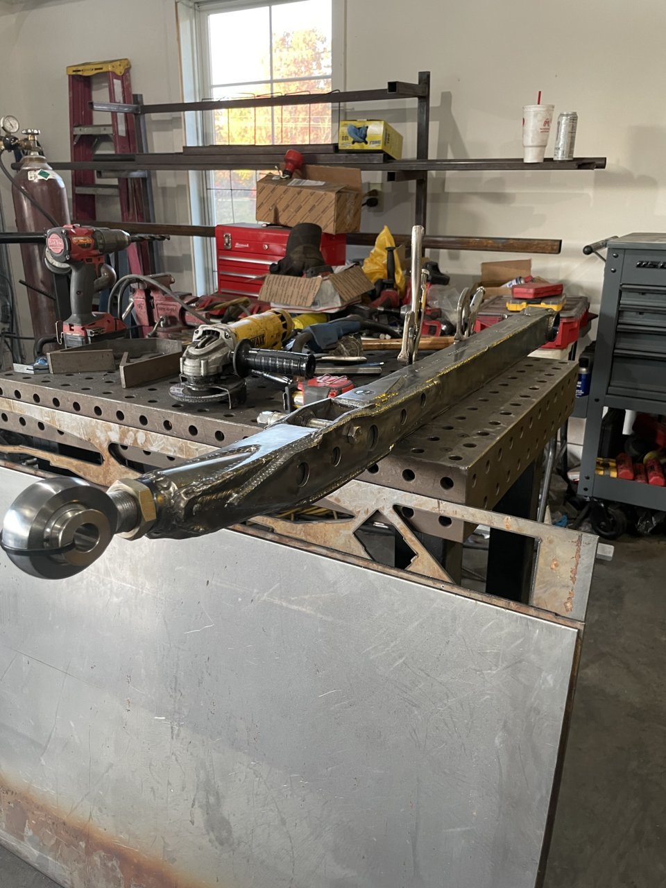

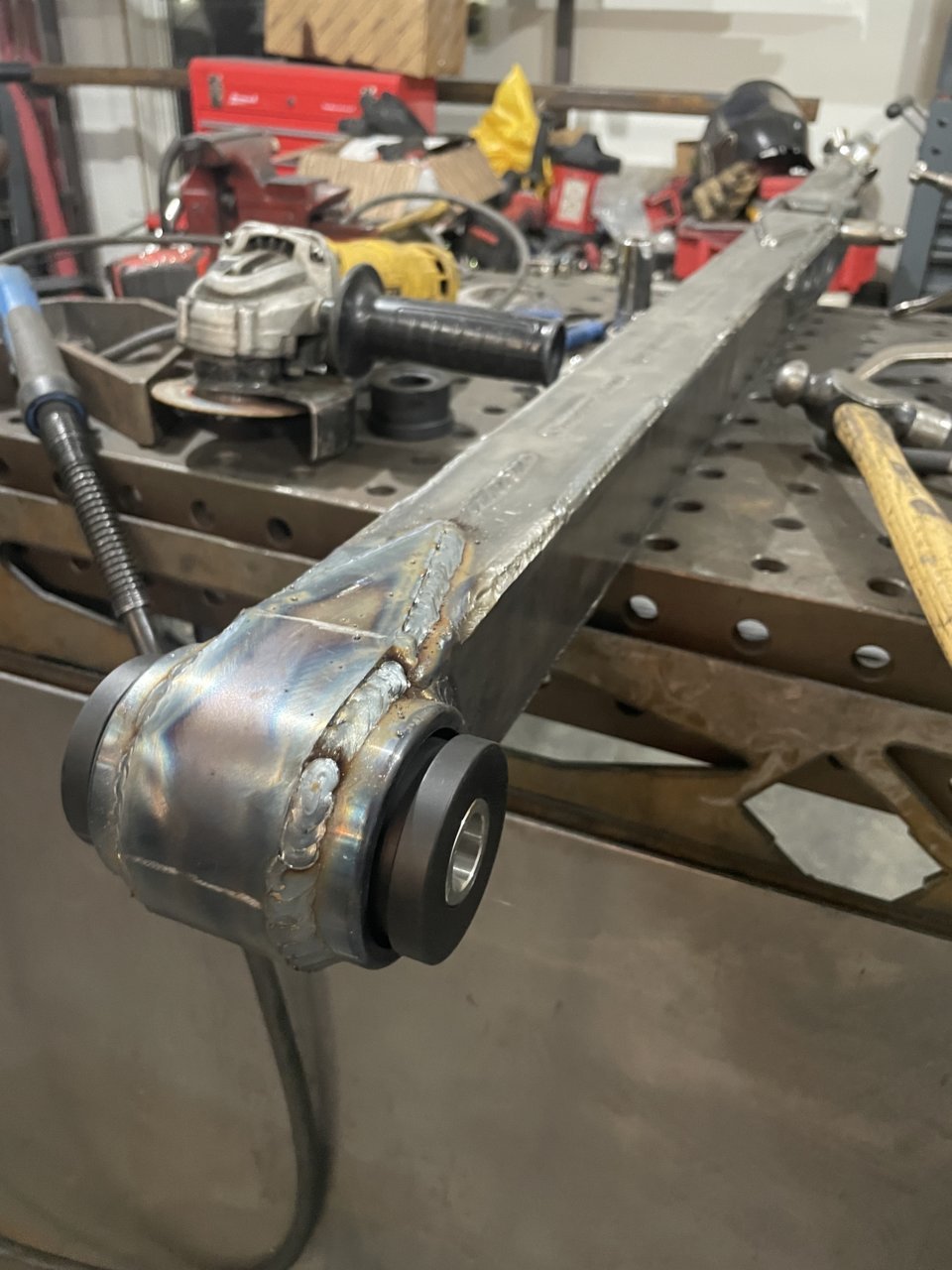

    I only got 16" of clean travel with my last setup with frame notch and rubbed my 3k$ shocks to shreds because I don't want the ass end 6" wider per side. if you have a better method please let me know. This setup fixes all my problems, is more adjustable/tunable, and has more down travel.

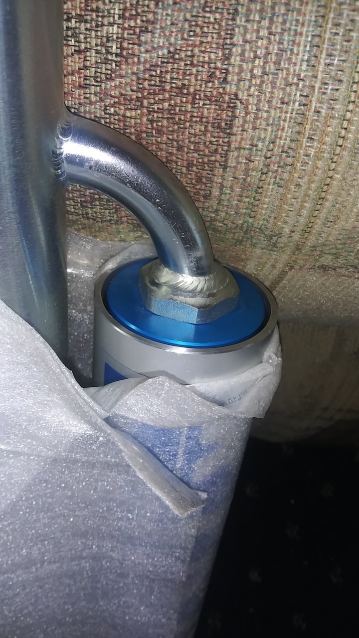

    Asking a bit of an odd question this morning:
    Has anyone ever converted a triple bypass piggyback res to a remote? Can it be done without spending a bunch? Or would I be better off working a trade or selling them out right.
    I had an idea to use this bypass for my rear suspension, but I don't think there is enough room for the axle to cycle full travel without some interference on the piggyback. And the tubes may not be clocked in the right position to work properly anyway.
    My inexperience with suspensions got the best of me when I bought these triples......:anonymous:

    That depends on if they manufacture used a JIC fitting on the resi tube. If they did, then yes you can do the conversion for relatively cheap.
    what shocks?

    King 2.5 triples.

    King uses a different fitting between remote resi and piggyback. Though there are adapters out there to make it work.

    @desertjunkie760 and @Airdog thanks for the quick replies.
    That fitting is larger than I thought it would be.
    I've got a good bit of research to do.
    Taking a quick measurement, the hose might have to be over 20" to work.
