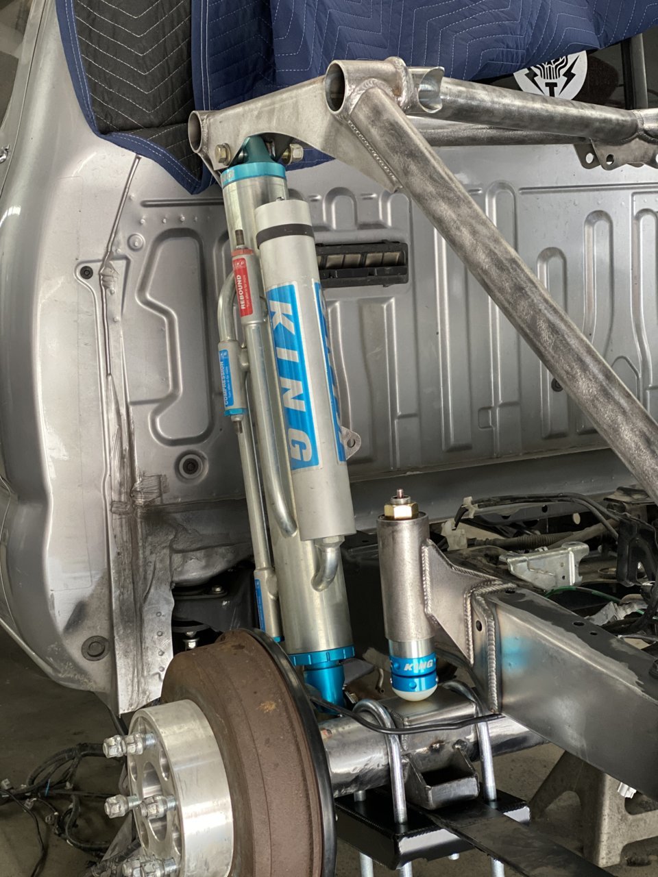

    We have had great success with notching the frame, I dont think there is anyone in this industry that would argue that 3-4 hours of labor isnt with 1.5-2" of additional bump travel. Our bump stop kit is self locating and can be installed in a half day.
    You would at the minimum need to redo your shock mounts on a truck that is already setup with a SUA. Notching the frame would yield no benefit if the shock is collapsed before the axle goes into the notch

    Am I trippin or why does it look like the axle doesn’t go all the way up into the notch? It looks like it bumps at the factory frame height?

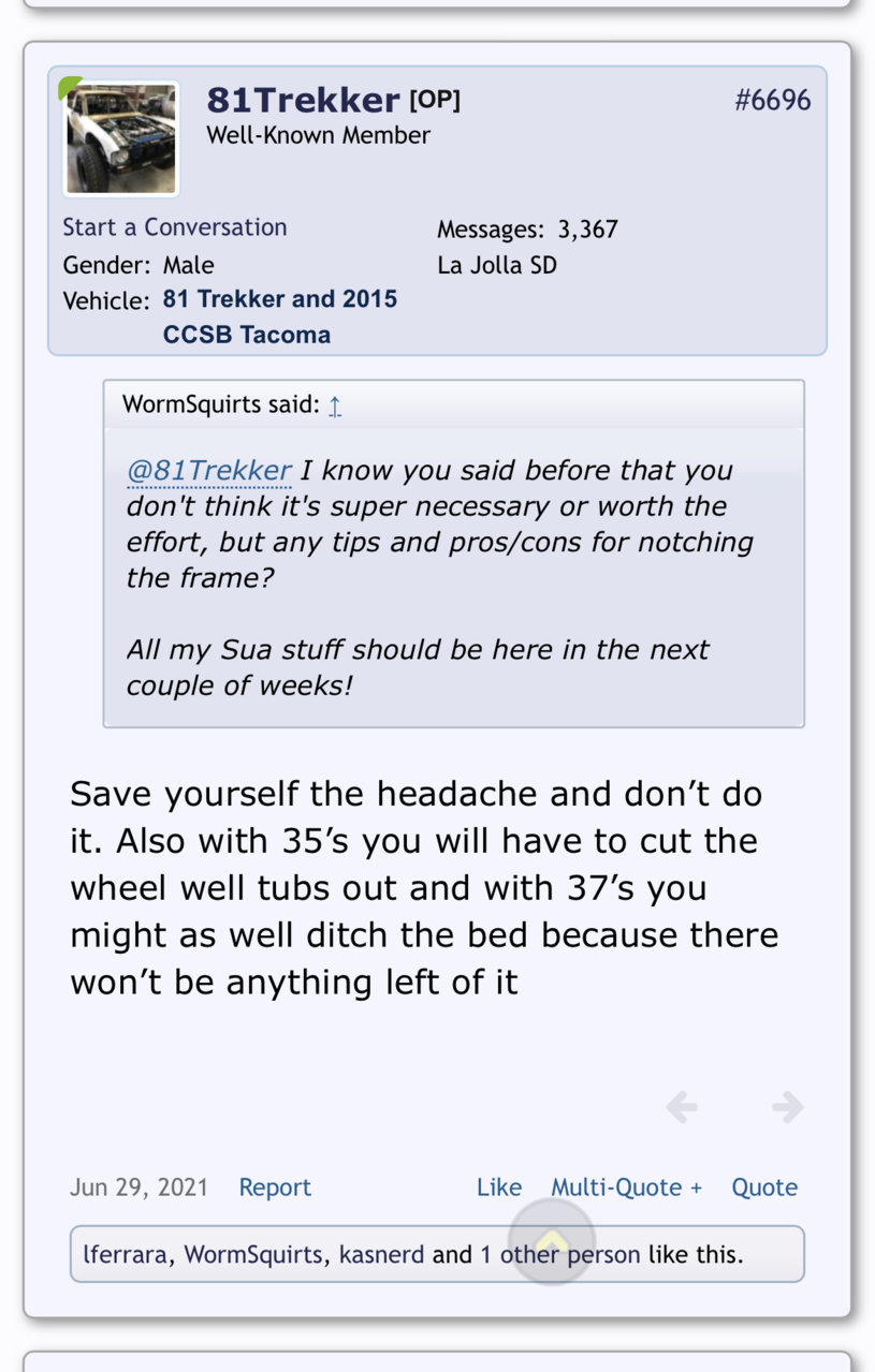

    My view hasn’t changed because the cost of the kit, hydro bumps and labor isn’t worth it to most people. Also 35” tires bumped 2” higher than the factory frame will be into the bed tub and will require fiberglass fenders. Don’t get me wrong the Dirt King kit is nothing but top notch (no pun intended) like all of their products but if a customer is asking me to do it I would recommend against it for the reasons above.
    I always try to stress value for your money and if gaining an extra inch of up travel ends up costing $1500+ in parts and labor not including fiberglass glass I tend to shy away. With that said would I do it on my personal truck? Probably for the same reason a dog licks his balls :)

    I think its just the angle, the u bolt and top of the axle tube are well above the lowest part of the factory frame. I originally tried to find a pic with a good side view and didnt have any
