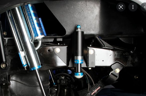

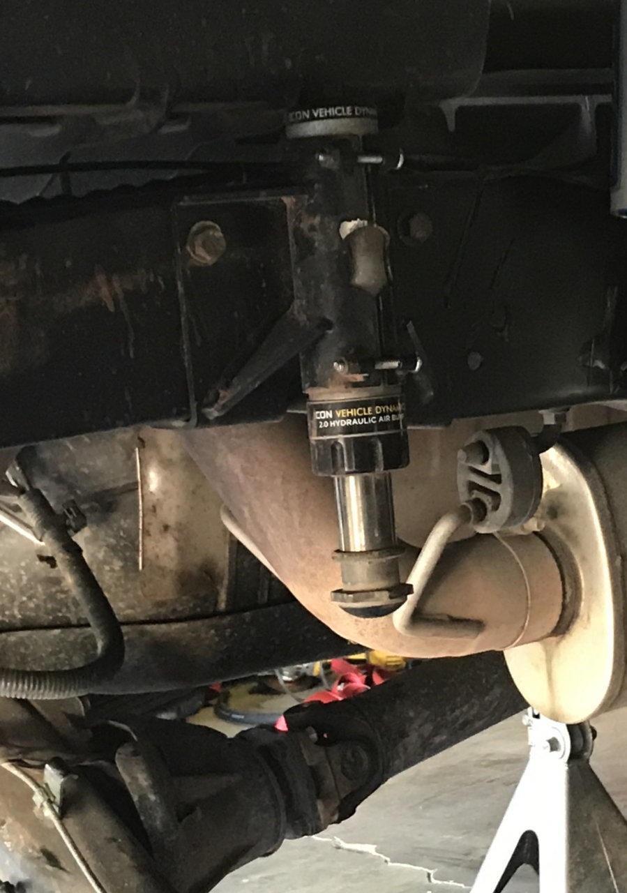

    So with that said, is there such a thing as a bolt on bump stop mount that actually mounts the bump high enough that can get axle to frame (or as close as you can get)?
    I have some old Icon bumps in the rear that as you can see hang down pretty far.

    Yes
    I looked into it previously and the Camburg kit was the only one that bumped level with the bottom of the frame, the King & TC kits all position the can lower

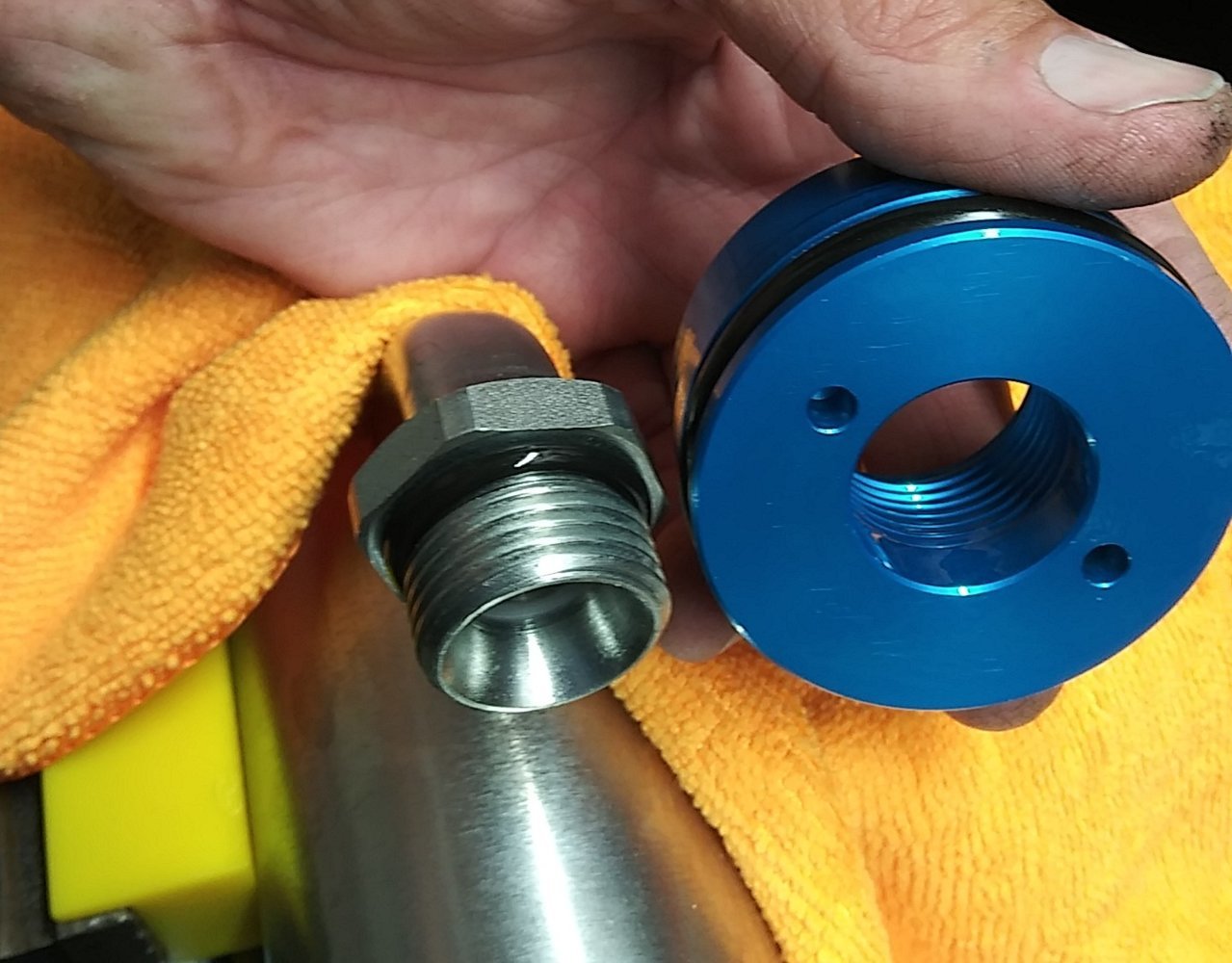

    This is what I found underneath connecting the piggyback.
    OD of the threads measures 1.05".
    What standard do guys think this fitting is? I did "some" research and still have no clue. Threads look like JIC as Shane mentioned.20221027_191318~2.jpg

    Take it to a local hydraulic hose shop and have them make what you want.

    that’s definitely not a JIC so you can’t just connect a standard resi hose to it.
    https://brennaninc.com/brennan-university-old/fittings-101-jic/

    Found one not too far away.
    Thanks!

    Yeah move that bump up and reap the benefits of an easy fix

    -16 ORB?

    It might be. Looking into that tomorrow at a hydraulic shop.
