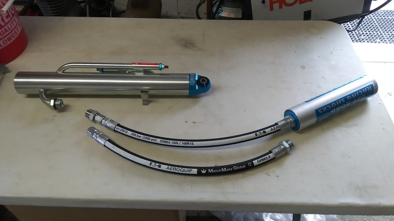

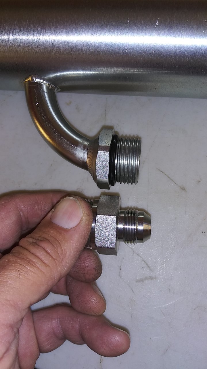

    The bypass res fitting saga continues. As @DocME mentioned, it is a -12 ORB.
    First hydraulic shop came up with no real options, and a little incompetence.
    The guy at the 2nd shop knew his stuff and set up a series of adapters that would work but was a hideous stack of fittings that were almost 4" long.
    So I talked to my welder and he will Tig a modified smaller JIC fitting on the body and make it a much cleaner install.
    So I had the hoses made and will get the welding done next week.
    Thinking I should remove the check valves so the heat won't damage them.
    Slashaar, JDSmith and jamesepoop like this.

    what size JIC fitting is that? I wouldn’t install a fitting that small as you’ll restrict oil flow and get unwanted harshness.
    FlapJack935 and not_nick like this.

    It's a -8 JIC. The orifice is 3/8" into the hose. I was hoping it would be enough, as the tube coming off the body is only 1/2". All of the other options were much larger diameter fittings and hoses.

    Would something like this work for the hose you have shown?
    https://www.titanfittings.com/Produ...MIw4yc2POF-wIVaSdMCh0algsIEAQYASABEgKWQ_D_BwE
    basically as I understand it the ORB fittings are just NPT threads with some accommodations for the o ring interaction. I don’t know if that’s just a flat surface or a relief?

    I would recommend you using a -10 at the least with that amount of fluid displacement, especially on the rear where you'll see a lot more shaft speed. -12 is what came on the shock but You could probably get away with a -10.
    MI-FLoffroader[QUOTED] and DocME like this.

    Thanks Shane! I guess I should put a size bigger hose on it as well?

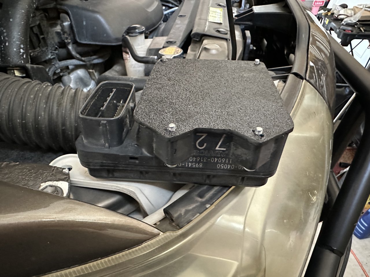

    Unexpected results. Got an abs/skid ECU from a wrecked taco and all my abs/traction lights are off now but the ebrake light remains off no matter what like it’s getting ground from somewhere else. Owell.
    yanked the ECU off the entire assembly and made an abs backing plate.
    Slashaar likes this.

    It also doubles as the low fluid sensor indicator. Do you have enough fluid in your master cylinder/do you still have the sensor there?
