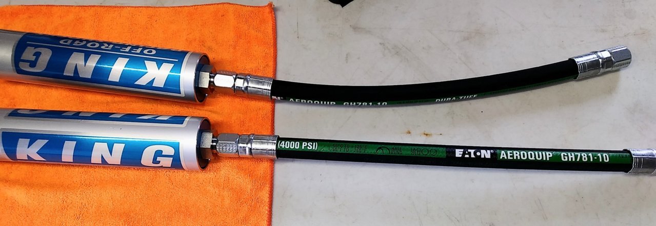

    Correct. Fluid flow will be limited by the port size on the fitting and the hose. If you got a -8 hose you'll need to go larger to match the fitting size, assuming you decide to go with a larger size.

    Yes Sir, makes no sense to convert it and restrict it at the same time. I was thinking about clearance in the wheel well, not how much I was affecting the flow of oil.
    $120 lesson.....

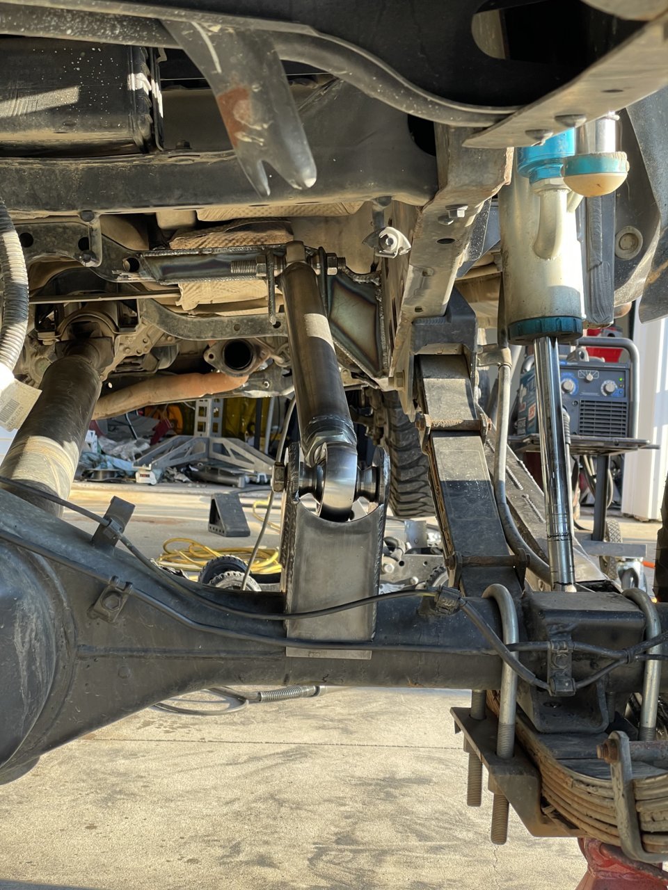

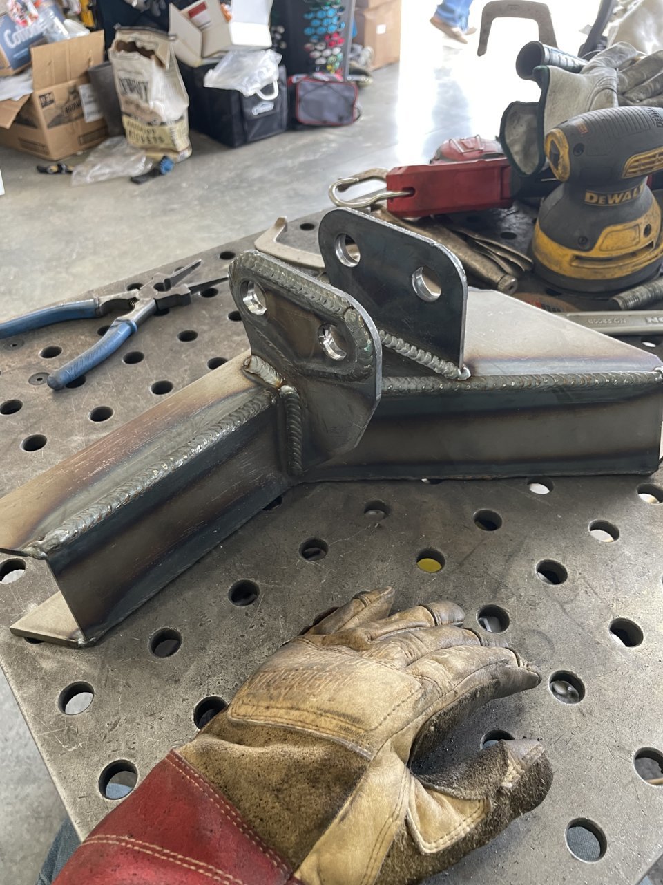

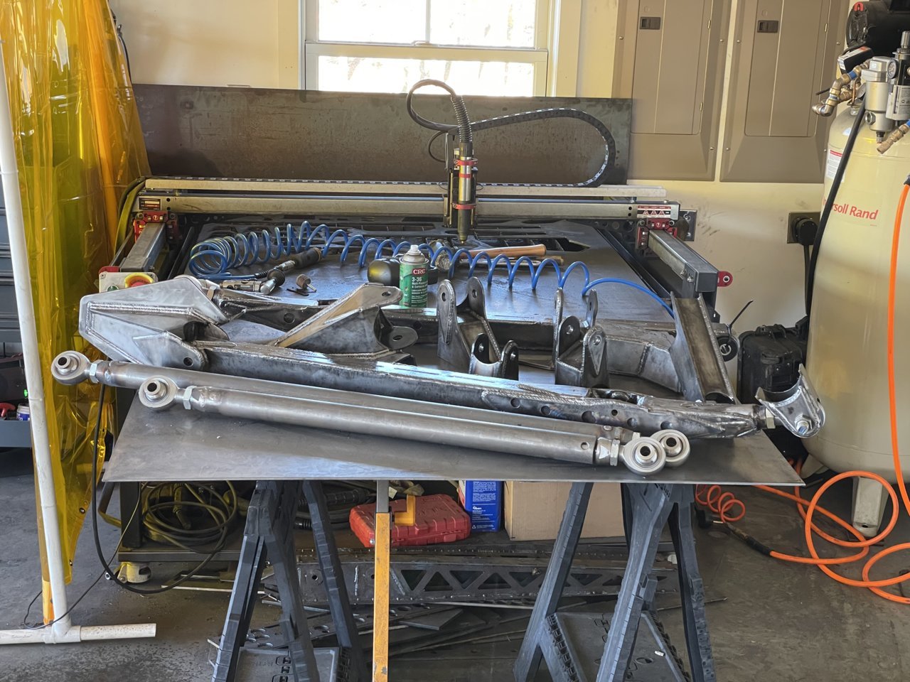

    All mounts and trailing arms are welded, just need to make the shock mounts, and get the arms powder coated.

    Weld the circles on the trailing arm overlays or they will rust out and ruin your powder coat

    Looks good, did you run out of gas or wire? Looks like one of my weekend projects where you're just a couple inches away from completion...

    I left the upper link un welded on one side so when I burn the mounts in I can verify it's correct and I don't need to shorten it. If that's what your talking about

    Yes
    @NcTaco27 this, ask me how I know...

    most bypasses I’ve seen with remote all use 1/2” hoses and fittings. Plus the only fluid flow is the displaced fluid from the shaft going into the shock, so flow really shouldn’t be an issue with 1/2” but also shorter hose runs help as well. And as far as the check valves go there shouldn’t be an issue. If he’s getting it that hot to effect your bypass tubes he’s probably warping your main body tube. But my big 14” dsc reservoirs are only a 1/2” npt fitting designed for 1/2” hose.

    It's very fun, building all of it is fun. Laying under the truck putting them on is the not fun part.
    thanks @81Trekker for the tips on my open corners.

    Yea the -10 fitting and hose should be fine.
    These are a 14" 2.5 w an 11" resi. I think a -8 would have choked it a little bit that close to the body.
    Welder told me he'd keep the heat down with wet rags if he had to, but didn't see a problem.
