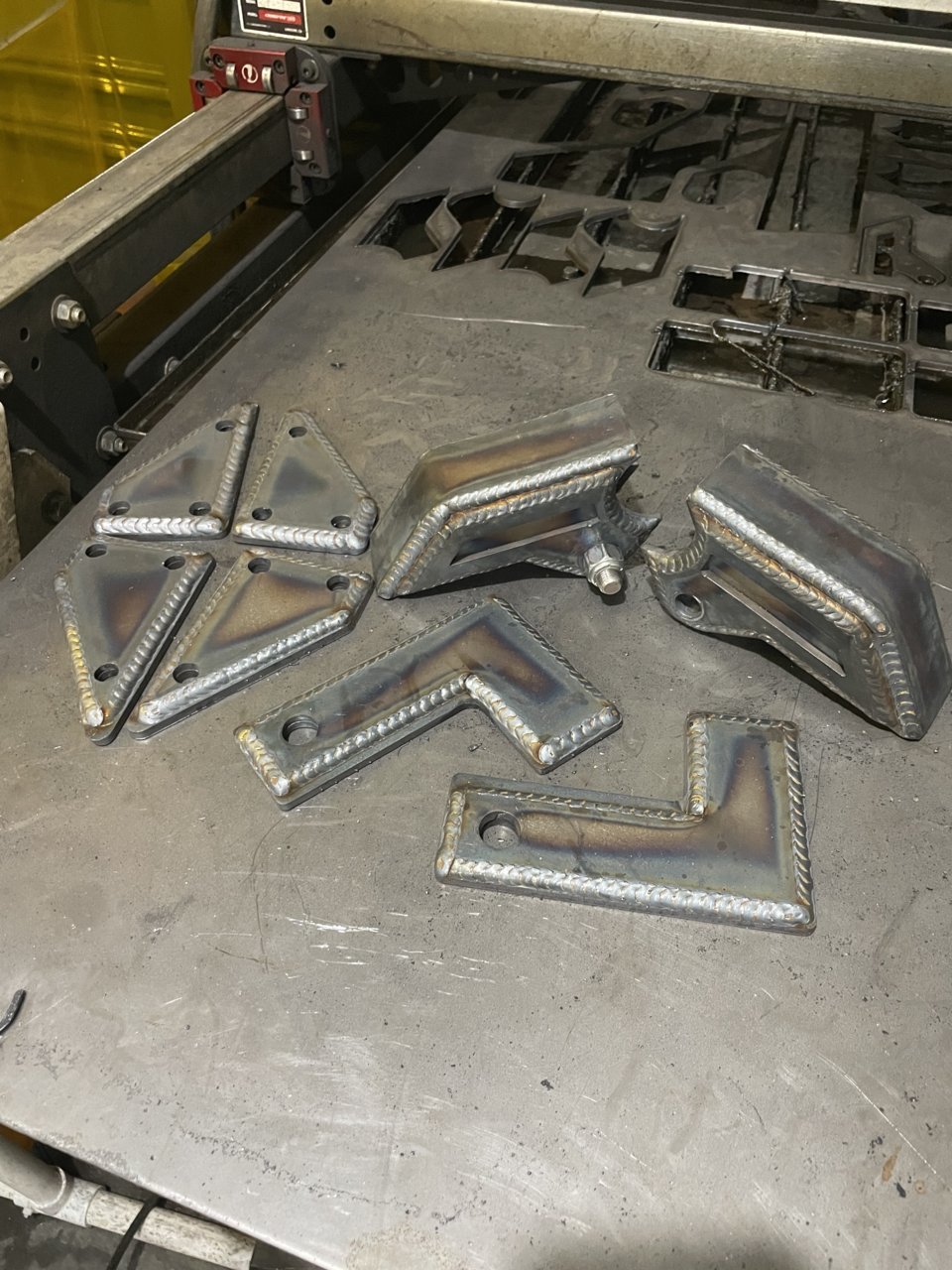

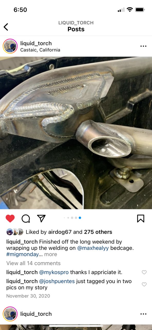

    76DBB63A-902D-4A9E-B046-6EAAE758F101.jpg Anyone have any ideas for bed cages with a coil over setup? Or tips? And yes it needs a cage but I don’t want to go that far yet. I made landing pads for the tubes and sandwich plates for the tubes to go through the bed. But I don’t think these shock mounts are gonna work, the shocks need to be pretty much up against the back of the plastic bed. I like @glorifiedwelder work here.

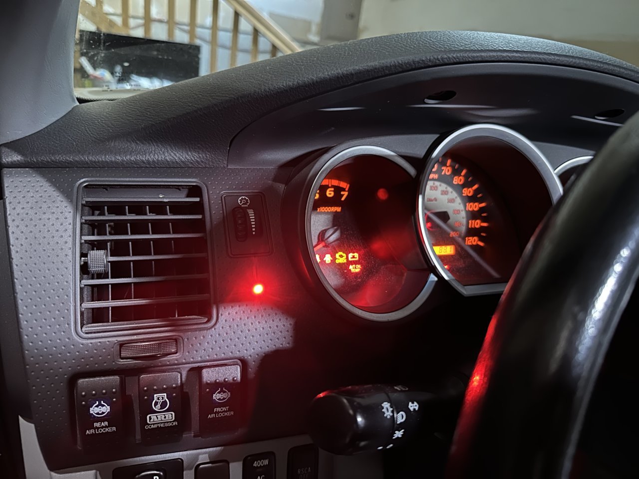

    Couldn’t figure out the miscom with the abs unit and ebrake so I just ran my own idiot light

    I had to cut the bed out of the way to get the coil over as far as I could forward.

    Have you looked at dirt kings prefabbed cage?

    Yeah I like it a lot, that press broken piece looks great! I just bought a tig too so this bed cage is gonna be my first project on it.

    I love the looks of it, super clean and low profile. I need a tig lmao which one did you get?
