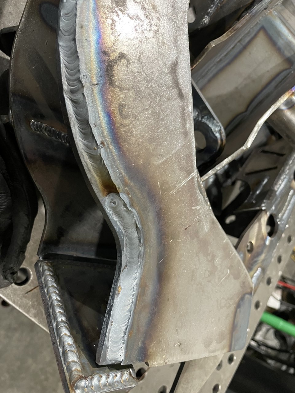

    Too hot, dirty and looks like mild steel which I'd never tig weld

    If that's your first time running the tig torch, then you are already ahead of most. In addition to what was mentioned about heat, cups, and cleanliness, work on consistent torch angles to the material. Its tough on a curve like that. Also, I will say that low frequency pulse settings can help a guy that is just starting out to be able to reposition on the fly without over heating the material or having those puddle deflections. Also need to ramp down on the end as you left a crater due to abrupt with drawl.
    I'm not sure which machine you bought, but if there's an option for the liquid cooled torch that is a game changer. It really allows you to not worry about your hand temp and focus on the torch position. Especially with that higher amperage.

    One thing I’ll note is the undercut on the edges. Definitely running hot and fast, or going too wide. Try not to let your arc go past the gap or fill area (sorry it’s been a long time since I used the proper terminology) other than that pretty much what everyone else has said. One trick I learned in school was to “walk the cup” I used a #10 and crept a good angle and every one of my welds passed the bend tests. That’s what worked for me anyway.

    Thanks everyone, I have a fupa 12 cup but didn’t know I needed an adapter, never holding a torch before. I just ran a 7 cause that’s what it came with. It’s a primeweld 225x. I didn’t clean cause I was just trying to focus on getting rhythm down and wanted to be able to weld more. Obviously on a real part I would. Good point on cleaning filler and tungsten, as well as ramping down for no crater. I tried pulse but got confused and wanted to just stick with pulsing with the pedal till I at least learn the concept of the amperage control with my foot. Thanks again

    I have the same welder with water cooler setup for my personal use. Having always been a Blue guy, I'm surprised at just how much I like it. You can still use your foot pedal to adjust the amperage when in pulse, but what you're working on is good. I think you'll find that you'll want to clean it all even if its practice as you'll be chasing your tail and cleaning your tungsten all too frequently.

    Learning pedal control is far more important than figuring out pulse. Forget pulse even exists right now. To me it looks like your travel speed is just too slow for the amperage you're running. Back off the amps, watch the puddle and use the pedal accordingly. As you get faster you can bump the amps.
    Also, clean everything. Even if its practice. You will find things go much much better.

    Yes nice shiny metal is best to weld, and even grind back from the edges 1/2" or so because the weld puddle will pull impurities into it. Definitely a travel speed issue here though, too hot, too slow. D1.1 MIG and D17.1 TIG welder here checking in for duty :)

    I did a few more quick beads for a friend that is well certified and he said my arc was way too long and I am putting my filler on the wrong spot. I didn’t realize you’re feeding the hot metal filler, not right on or next to the tungsten tip. Also my fupa 12 adapter comes in tomorrow so that will be nice

    Yeah you definitely don’t wanna touch the filler to the base and the tungsten at the same time either. Lol
