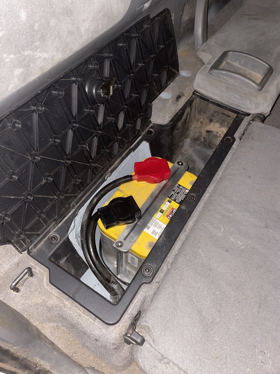

    Yeah definitely a lot of work the box just doesn’t fit in with my plans for inner splash guard and it’s just ugly lol. Got the battery relocated under the passenger rear seat nice and tidy in there

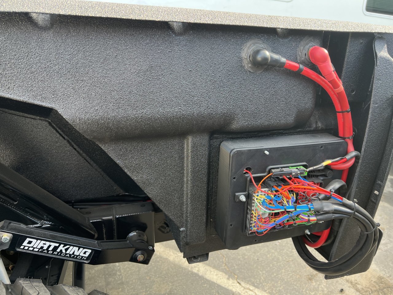

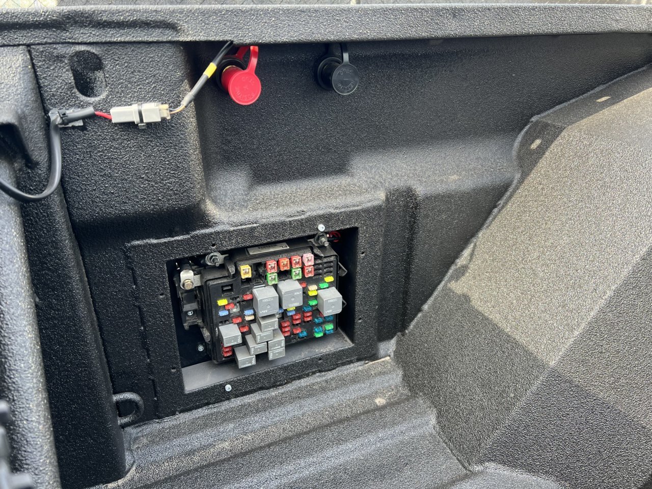

    Its A LOT of work, we have done a few of them but be prepared for weeks of work. This is a Silverado we have here currently, we 3D printed a new fuse box surround that bolts the OEM fuse panel to the inside of the bed.There is a steel lid used for access inside the bed and aluminum panels that bolt to the outside of the bed and protect the wiring
