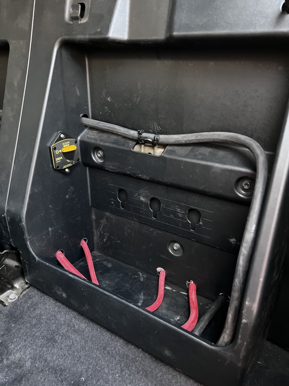

    That was my other thought. Manual being less of a failure point. And I wouldn’t be throwing money at a remote shutoff.
    Upgrading the size of wire going to the bed batteries soon and figured I’d make the decision ahead of time. Currently have a Blue Sea manual switch in the cab.

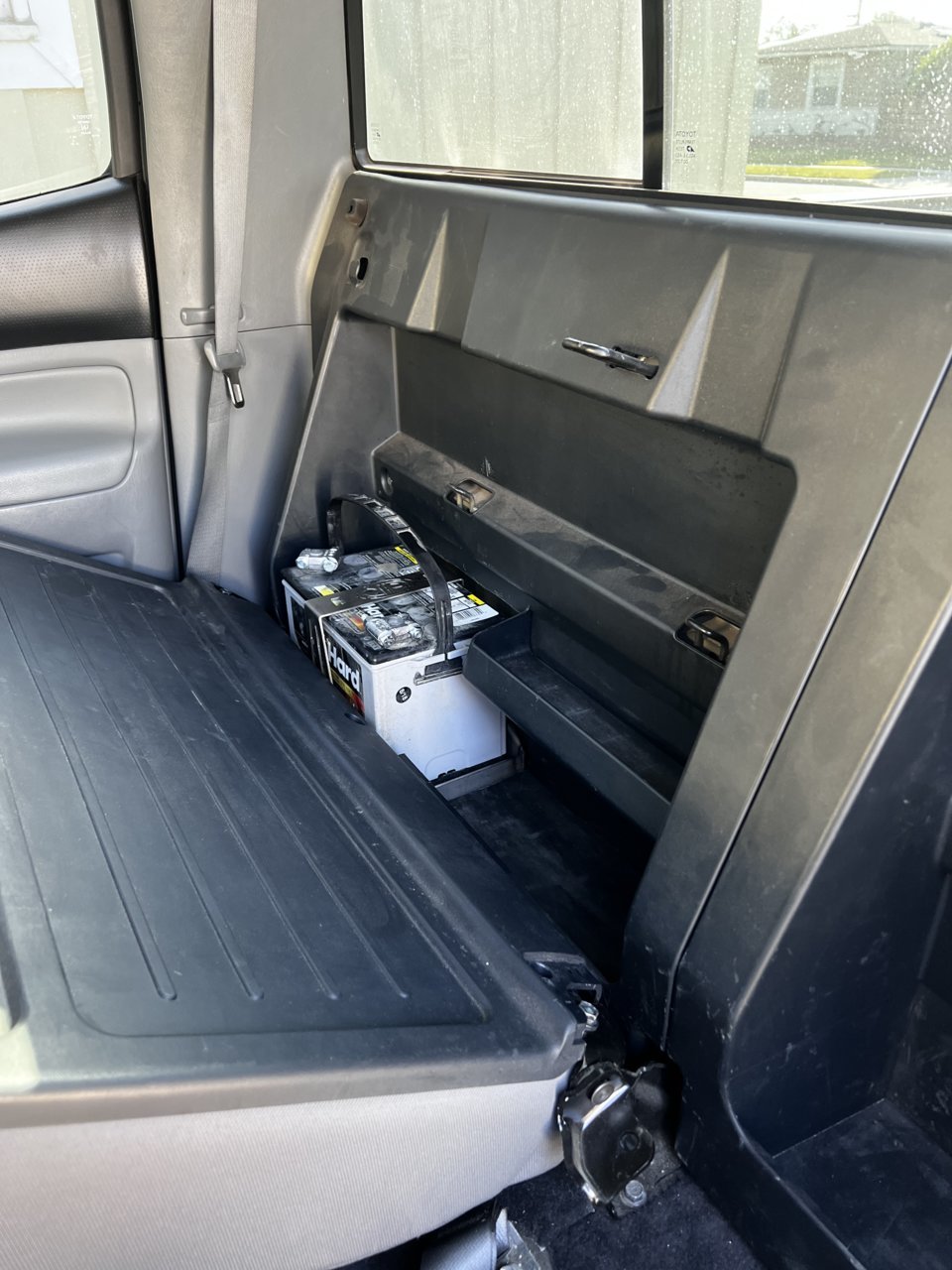

    I put a blue sea switch in. Don’t have a picture of it all wired up. Ran 2/0 awg wire for both positive and negative to the trucks main system. 2 awg ad a parallel leg that just powers the switch pros. It’s fused, just didn’t have another breaker to keep them both on a switched power. Planned to go dual battery with a controller to manage them. Battery is tied down with battery tray bolted through the floor.

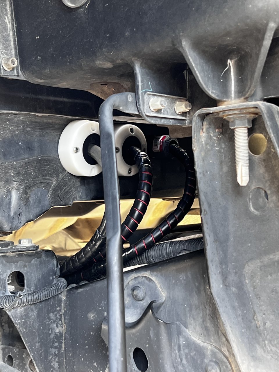

    This is probably dumb but what are those white things that look like super grommets? That’s the only piece I am missing for the cables to go through the bed. Was going to use standard ones if I can find them in that size.

    They are blue sea cable clams. Kind of bulky and overkill. https://www.bluesea.com/products/category/23/Cable_Clams

    Thanks for the links. At first I thought it was some super protective grommet (which it is) but they seem more like waterproof solutions. Since yours was in the cab that makes sense. Mine is in the bed. So yeah probably overkill for my setup.

    Actually same thing I’m using for the smaller gauge wire. Not from McMaster but I had some on hand from work.

    After doing some reading I think I’m going to go with this sort of thing. I don’t need the waterproofing but I don’t think a traditional grommet will work on the bed. These look like they’ll handle a lot thicker material.

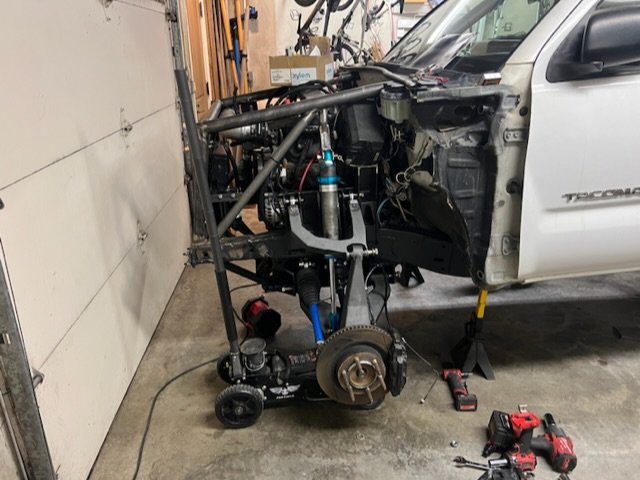

    Man that was an expensive way to go from 14.5” to 16 3/8” of travel in the front….10/10 don’t recommend….lmao… probably should have just put bypasses in first but I got a decent deal on some 10” coil overs so down the hole I went…
